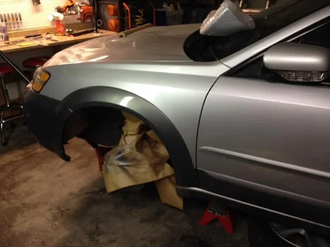

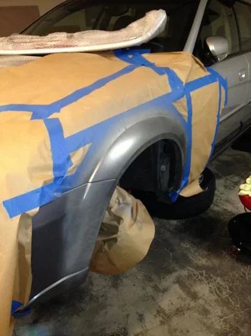

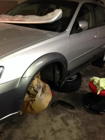

First try at my own body work. Was a bunch of paint missing (down to the plastic) on flare from PO. Turned out very well. At least in the garage. We'll see how she looks in the sun this weekend. Sanded, adhesion promotor, prime, prime, sand, prime, prime, sand, etc. 1200 and 2000 grit on the sanding. Four coats of base, four coats of clear. Had I known how easy it was I would have used some filler on the slot in the bumper.
Looks real good dude... And really many times it is all about the 10ft rule, as long as it looks good from 10ft then you are good.
I think that most light body work like this is pretty easy, it is just time intensive and that is where people get turned off.
