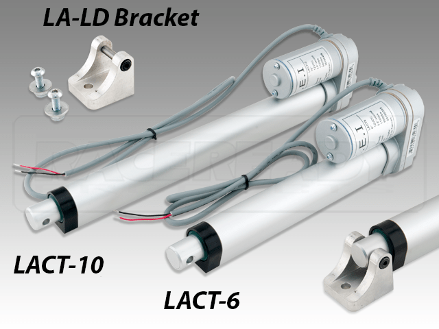

I'm not a "ARduino kind of persons, I just don't thing it make much sense to have motors and servos expose to the weather, but now that we have kiddos, made build a wing angle adjuster, (Fore and aft, height, angle, etc) for them to play..
I try this a few years back..
I tend to stick my finger to the BMW Motorcycle snobs making my bikes as ugly and funky as they can be, plus I can not drill anything straight, so F#ck it..
Sorry if is to loud and sorry for my Horrible Ingles, for polar bear everything will be build "Nice" Pneumatic maybe) since is for the whole family no just my toy..
