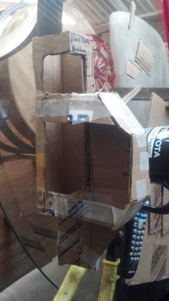

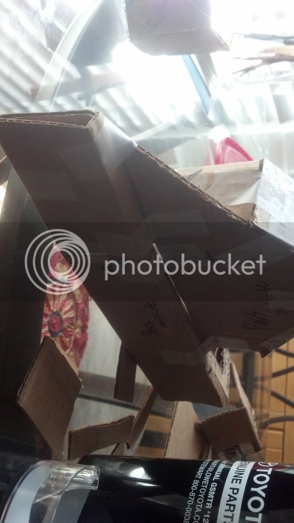

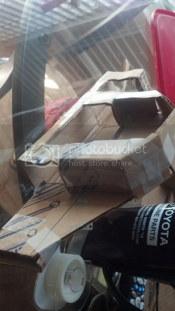

my 86 22re 5speed 1stGen 4Runner
bottom bracket V 1.2

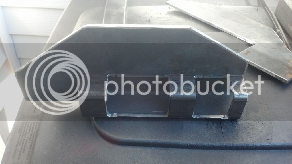

added some plate to make plate that doubles as a skid to make mount more rigid
extended side of tube to continue all the way to the front of the bumper tow hook holes.

Nice craftsmanship by the way, looks like a lot of careful work with the 4" grinder and cutting blade.
Thanks Matt. Ill give you a call sometime this week.
To cut the tube I had to use a drill for pilot holes for my scroll saw with metal cutting blades to cut the sides parallel to the tube corners then use the grinder for the edges perpendicular to the corners. I then used a die grinder bit on a dremel on the inside corners.
I beveled the welding edges and cleaned up the edge burrs.
Took about an hour.
