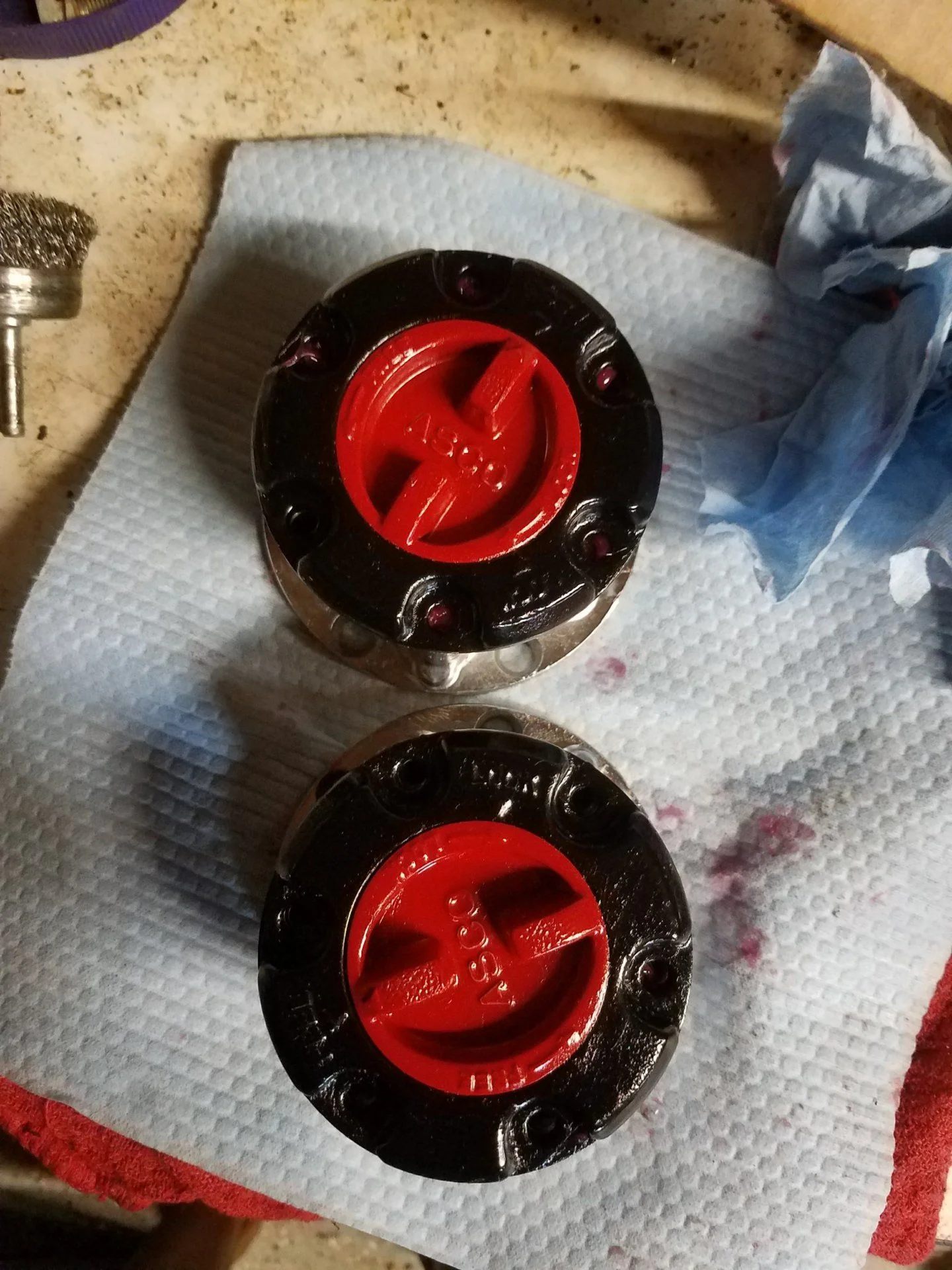

Yeah, they are pretty easy to clean out. Keep it compressed when removing the screws. Once the last screw is removed it will pop open due to the spring inside. The most time will be spent removing from the engine and re-installation. I bought an old used one, cleaned all the crud out and it seems to be working great.
