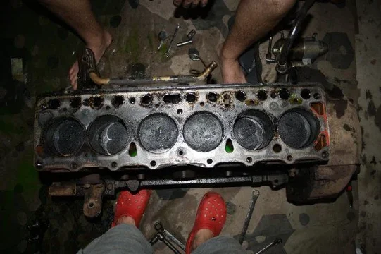

I have attached some photos from when i first did the original motor rebuild. motor1.webp
