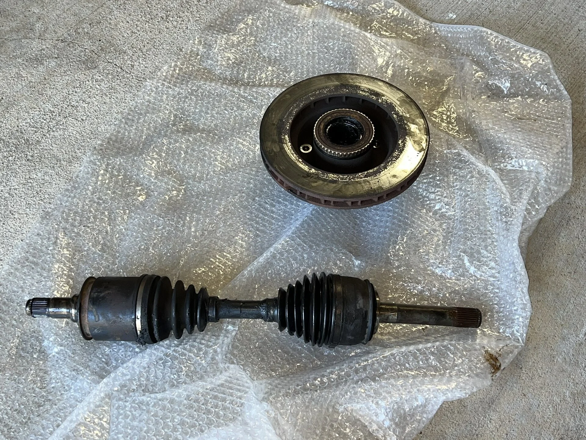

Will update my progress over time with some pics or vids of the work in my garage.

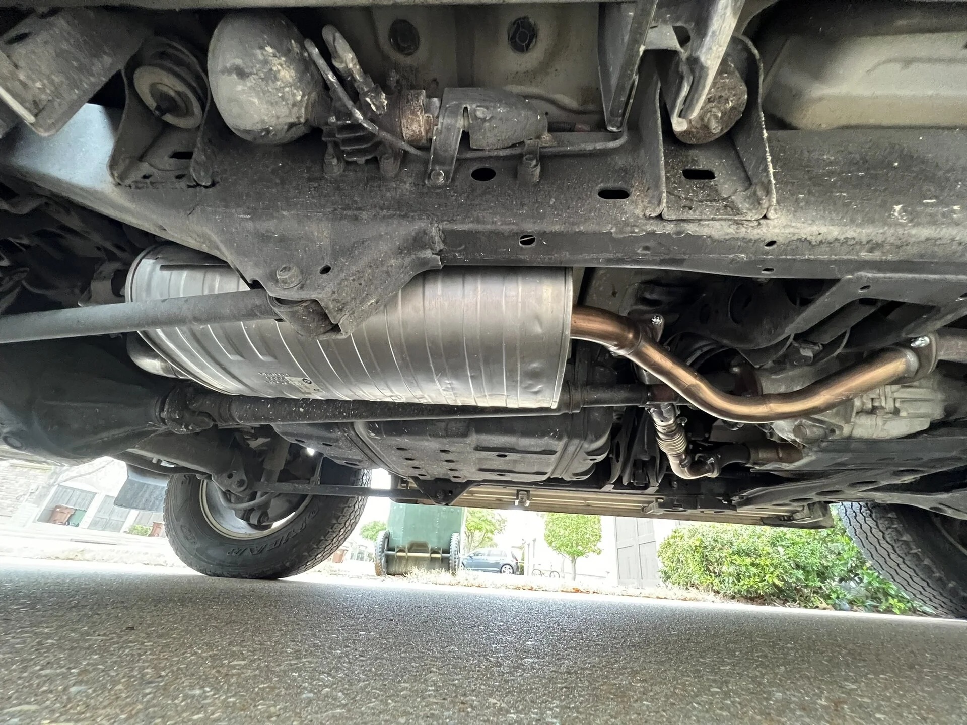

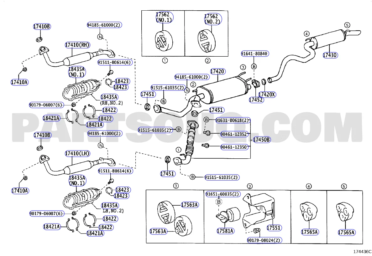

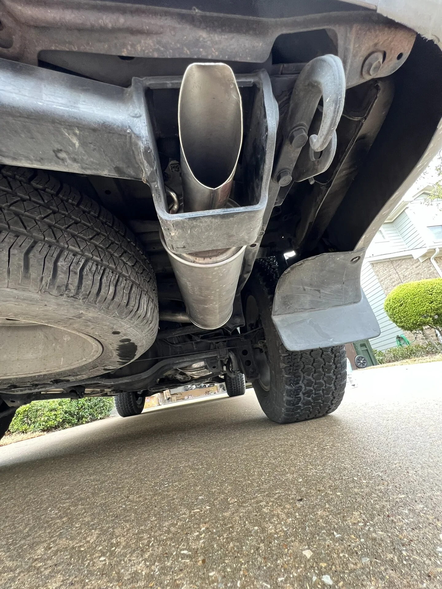

Update 3/21/2024
I got my new exhaust system from PartsOUQ.
I ordered the gaskets, the rubber mounts, and the 3 pieces of the exhaust assembly kit. I did not swap the catalytic converters, they appear in good shape.
I had to take it to a Muffler-only shop, as the bolts and old exhaust were rusted really bad, it would of taken me forever to do it. It was a more hands on job so decided to save the time and effort and pay the shop. They did a good job (5 star shop on Google), walked in, did it in 2-3 hours, was a clean job, done.
The car now sounds very quiet and smooth when putting on the gas! No more rattling or high frequency sound when putting the pedal real hard.
For those that are wondering here's some of the part numbers:
You can check it on PartsOUQ
NumberNameBrandPriceQty
1740350151PIPE ASSY, EXHAUST, CENTERToyota366.20$1
1745050070PIPE ASSY, EXHAUST, FRONT NO.2Toyota121.52$1
1740550030PIPE ASSY, EXHAUST, TAILToyota225.20$1
1745250050CLAMP, EXHAUST PIPEToyota16.33$1
1745150050GASKET, EXHAUST PIPE, CENTERToyota1.31$1

1756546040SUPPORT, EXHAUST PIPE, NO.1Toyota9.81$1
1756574280SUPPORT, EXHAUST PIPE, NO.1Toyota5.72$3
1756513030BOLT OR RING, EXHAUST PIPE FRONT (FOR CENTER)Toyota4.59$2
Note, there is a Dampener part that sits behind the exhaust pipe (1758150140). I decided to reuse my old Dampener assembly as it was in good condition, and didn't want to spend more money than required. Some of the rubber support was out of stock for me, so I only bought what was in stock, I used around 4 of the original ones and swapped 2 to new ones, overall don't see these as needing all replaced they still worked. What needed replacing is all the rusted out metal, bolts, nuts, and the exhaust pipes, and the gaskets involved.

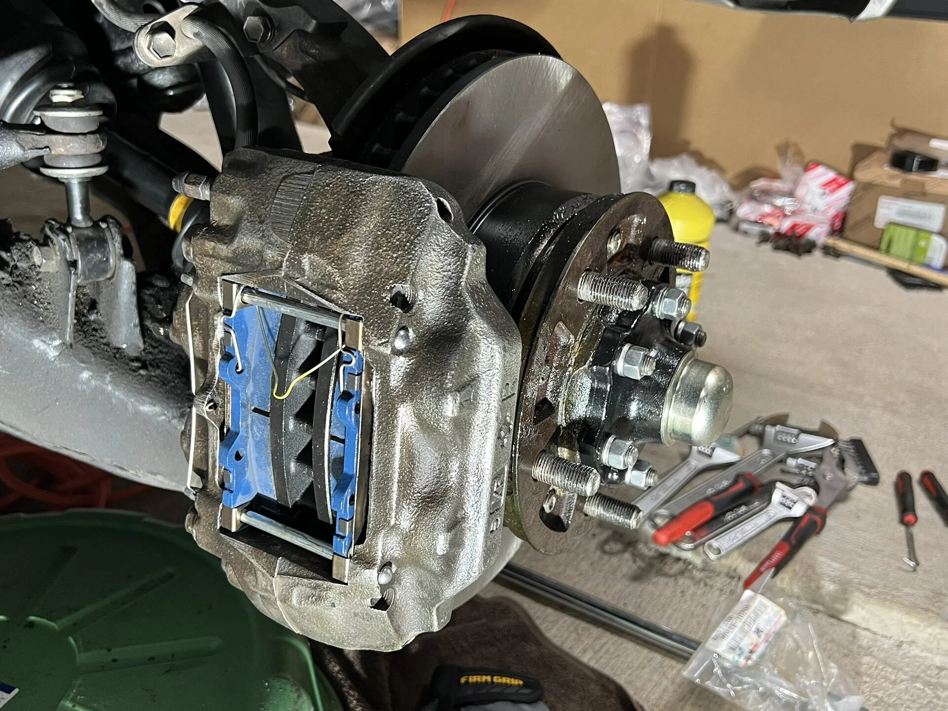

Posting some quick updates, been busy lately:
Both front wheels have bearings repacked, new seals, new races, new rotors, new flanges and CV axles. I kept the old hubs but polished them off with a brass brush. They got new brake pads and shims and springs, new rubber boots on pistons. I rebuilt the old brake pistons/calipers and used a brass wire wheel to remove some rust off the calipers and pistons. Made sure everything was torqued properly. Bled the brakes. I'll do the rear brakes and rotors later, when I get ready to replace those bearings which is a lot of work....
On one side, I didn't pound one of the inner bearing races all the way into the hub, so my caliper was hitting the rotor. Had to get a new bearing and race and then installed it all the way down, double checked both inner and outer race, and all lines up now.

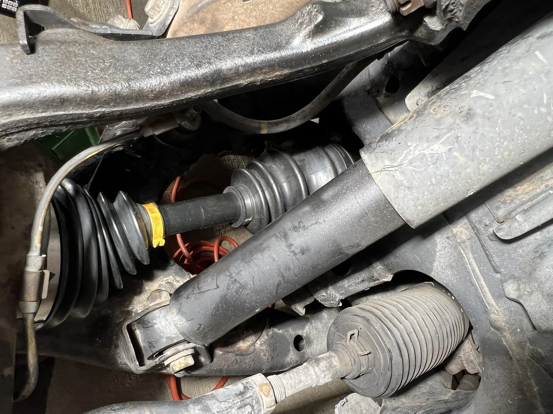

Old rotor/hub and CV boot. The CV's were leaking bad. Old rotors were rusted and not a lot of grease in the bearings. The prior owner also did not use OEM brakes, there were no shims or springs.
I plan to rebuild the old CV's with new grease and boots, keep it as a spare. They look overall fine and the teeth still make good mounting with the flanges, theres no teeth wear. When installing the CV axle I found there is a thin shiny metal at the very edge of the wheel mounting side that surrounds/covers the mounting location of the spindle. That thin metal bends easily so be careful when moving around the CV, don't let the CV lay on the ground with that thin metal hitting the ground or else it'll flatten and you'll have to bend it back carefully with pliers.
Picture of new rotor/hub/bearing mounted with new CV axles. New brake caliper kit rebuilt all OEM:

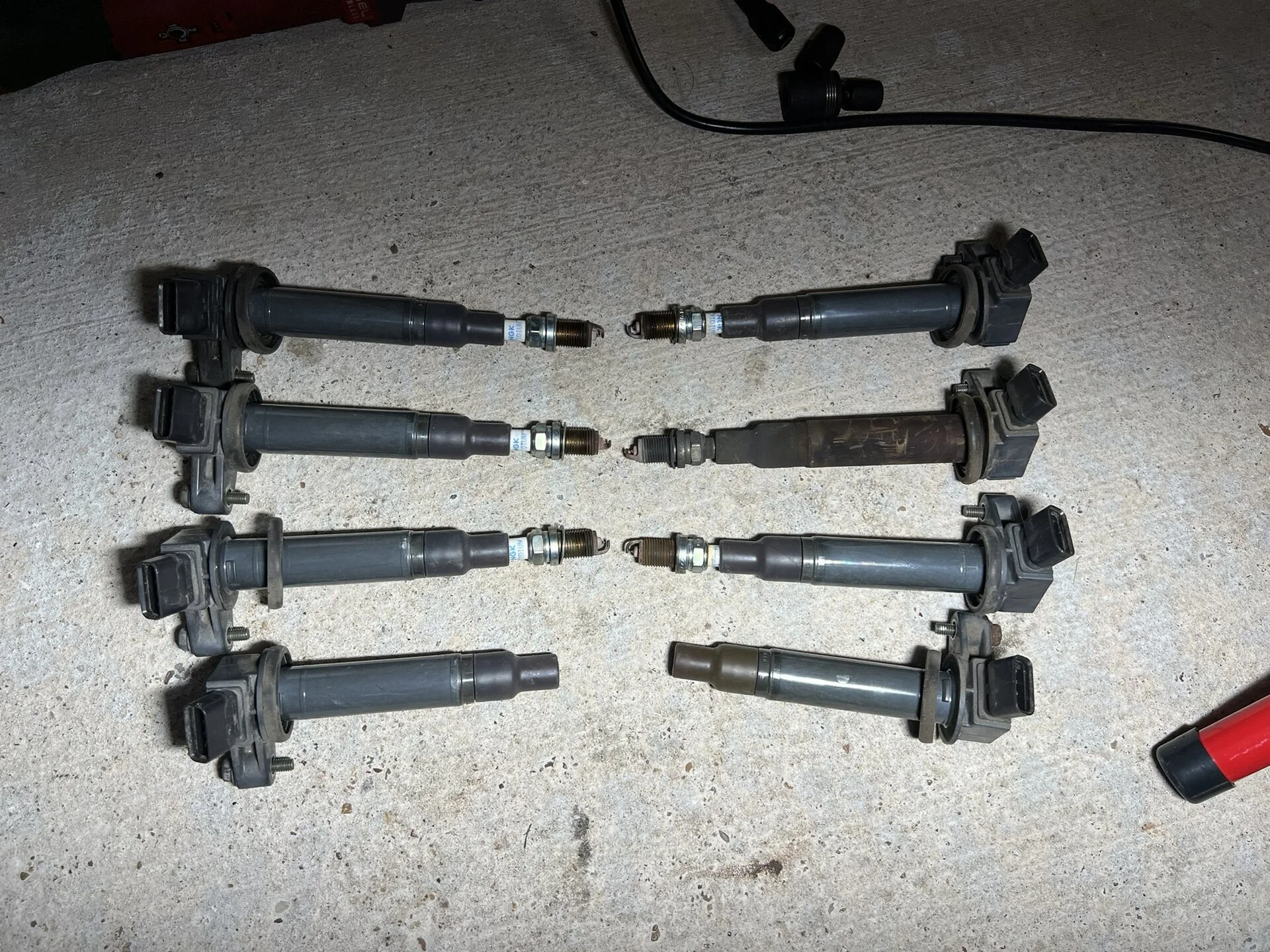

I then replaced my old crusty ignition coils and spark plugs with new OEM (Denso) ones.

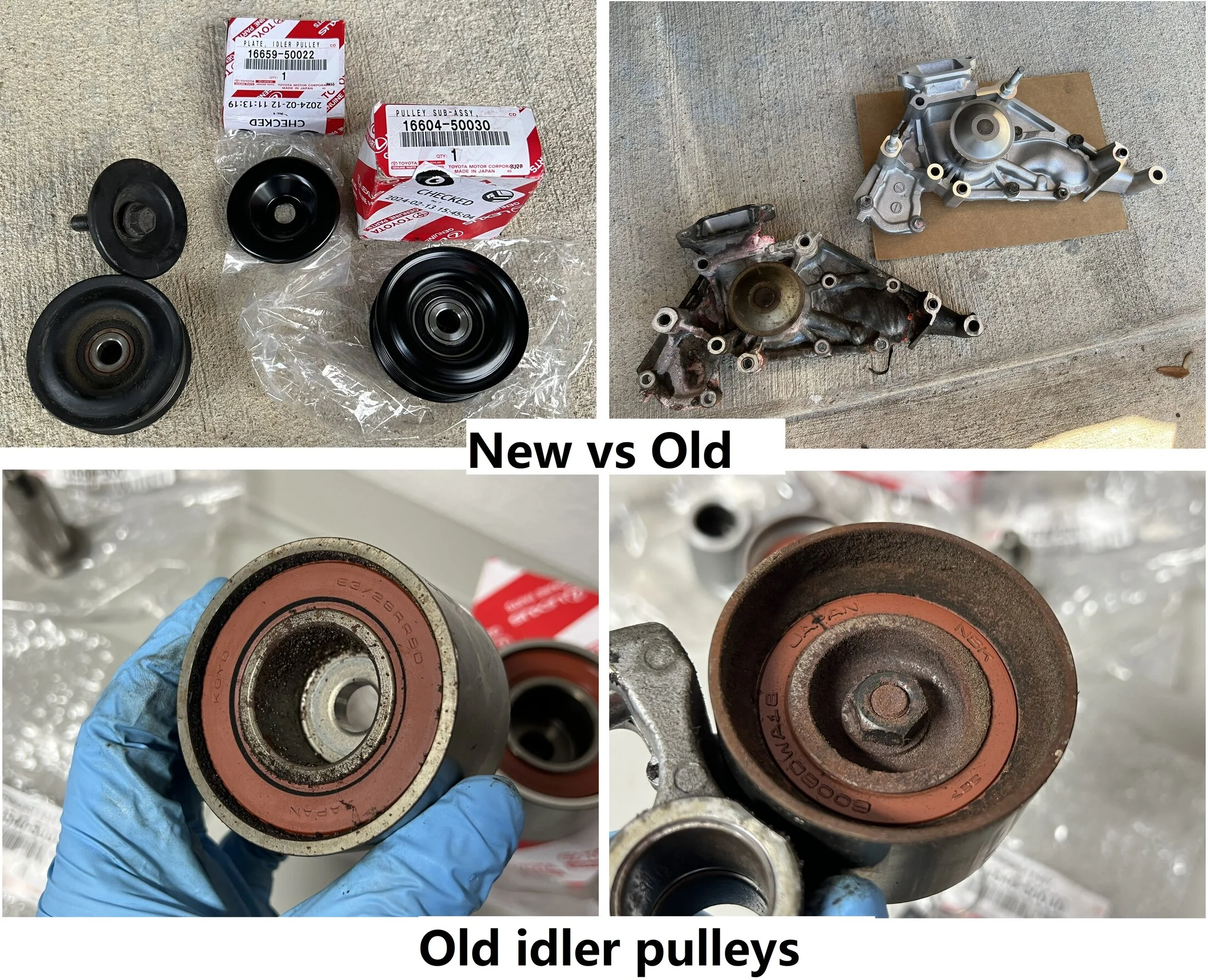

A quick few updates. Got my timing belt done with the VVTI. Everything went very smoothly according to the YouTube tutorials and write-ups on the forums.
My Crank was tight, I was able to get it out using my Milwaukee 1/2" impact gun and a crank holder tool attached to a pole that was touching the ground. I had the radiator out so the impact gun could fit, my 3/8" impact guns wouldn't budge.
Parts replaced include (everything Toyota OEM except Ignition Coils which were DENSO, Coolant used ZEREX Asian Red as couldn't get Toyota SLLC, Tranny fluid is Toyota World Standard):
- Timing Belt, Idler pulleys, timing tensioner, new cam cover electrical clips (was very brittle), water pump and gasket, water inlet housing, O-rings, thermstat.
- Serpentine belt, serp tensioner, idler pulley
- Fan, fan clutch, fan bracket, fan shroud
- Radiator, radiator hoses and clips, hoses and clips for oil cooler housing (the front side)
- Vacuum hose on top of power steering pump and clips (these were very brittle when taking apart, take care)
- PCV valve hose and foam bits and clamps
- Ignition coils DENSO x8 and Spark plugs x8 Toyota
- Heater T's and new clips, hoses original old ones. The hot side Heater was cracking be careful when removing it to not get plastic shards in the coolant system.
- Coolant drain and refill with new (Zerex Asian Red).
- Transmission fluid drip and fill and measure level (Toyota World Standard)
- Engine oil change (Toyota filter, Mobil 1 5W-30)
The difficult part was the VVTI cams were very sensitive to "spring" left or right, when you put them right at "Top Dead Center". If I moved the tick to the "T" mark it had lower tension, and I had some easier time assembling the Timing Belt with the Cam and Crank marks. When I installed the Timing Belt, I had to install the Tensioner on (with grenade pin still in), or else it will skip teeth when I rotated the Crank. With Tensioner on and rotating, I found there was still a 0.5mm to 1mm gap of the Cam marks at Top Dead Center. Rotated it 2 to 3 full rotations, still the same, and then I decided to pull the Tensioner pin as I felt after the Tensioner is activated it'll "pull back" the slight gap, and sure enough it did, right on the middle after I pull the pin and rotated it 2-3 times.
A video of the Timing Belt line up:

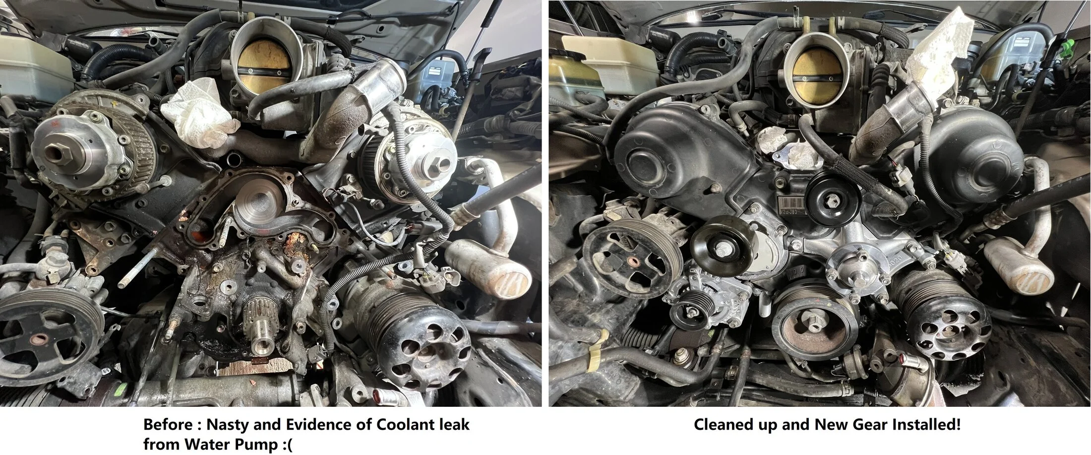

The old engine was quite gross. There was coolant leak evidence in past as it dried up and formed hard crystals around the parts. The liquid also caused the bearings to rust up. Grease also accumulated around the liquid and when dried up formed a black sticky paste. Spent forever wiping the engine surface clean before tackling the job, and also used a fine razor blade to scrape off the water pump gasket.
Judging from the condition of the belts and pulleys and parts, it looks like the original owner never replaced accessories like idler pulleys or tensioner when doing a timing belt job. The timing belt also didn't look OEM, but it looked not too bad condition for 170K mi, so I think the PO replaced it at some point. But the bearings on the pulleys and the tensioner and other parts were very rusted so it was great to change them, the engine is much quieter now.

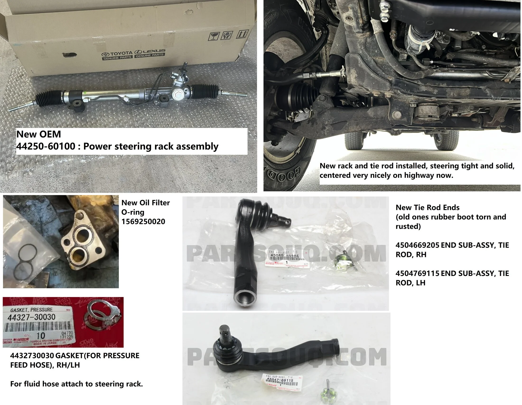

Continuing post, after the timing belt change, I took it to a shop to do the steering rack as I just didn't have enough time before my road trip. My steering rack was not leaking as the ATF fluid remain at same level when driving for over 5000mi, so I don't think it was a big issue, however the boots show evidence of wear and at some time leaking in past. So didn't want to risk it.
I looked at the steps to do the rack, and overall it's just a painful process..... (smacking tie rod ends off mine were really stuck on tight, very tight space to work on the pipes and clamps, having to remove the oil cooler housing and the associated mess it creates, wiggling this heavy thing out and then wiggling the new thing in, needing to do alignment, etc). I could of done it, but it was just a lot of work and didn't want to waste my vacation time.
If any of you are in the DFW area, I took my truck to Mike's shop in Denton, I rec him if you need help he knows the LC's and did the job expediently. He did the job with alignment in around 5 hours (went in at 8am when it first opened and got out before 3pm), as an amateur it would've probably taken me 3 days. He doesn't rip off customer or try to upsell you, and tells you what he plans to do more clearly. Everyone else was quoting me heavy prices and long wait times in DFW, but not Mike.
Kostanko's Mechanical Service - Denton, TX - https://www.yelp.com/biz/kostankos-mechanical-service-denton
I was able to bring my own OEM parts and fluids to him, and also mention the O-rings and washers I wanted replaced. Most mech shops today don't allow you to bring your own parts. I used Valvoline Full Synthetic Maxlife ATF (red bottle) for fluid, 2 quarts was enough, didn't have way to get the Toyota fluid in time and so far working great.
