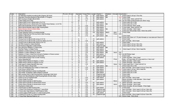

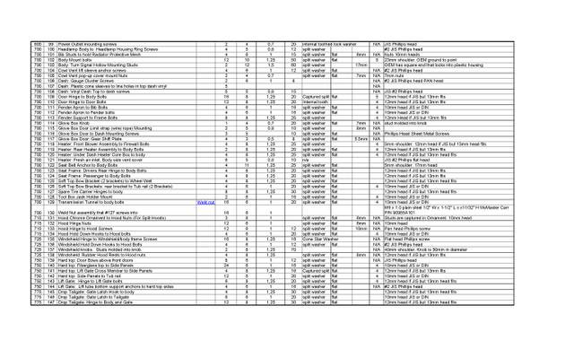

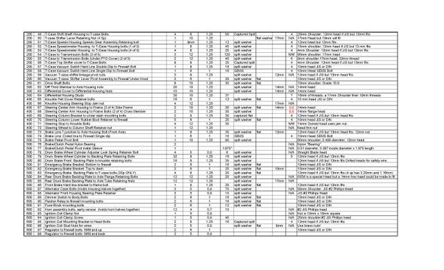

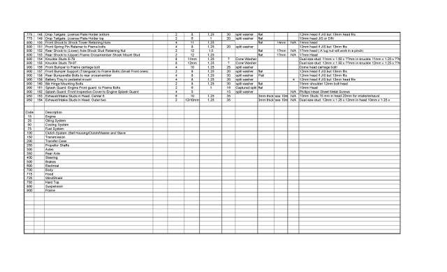

getting a bit ahead of you. Please say so if you don't like getting an awnser to a question you didn't ask. But I've found this very helpfull
This list was constructed by @Coolerman and I still thank him for it on a regular basis
Yup, Ive seen it, thanks!
Very helpful.
