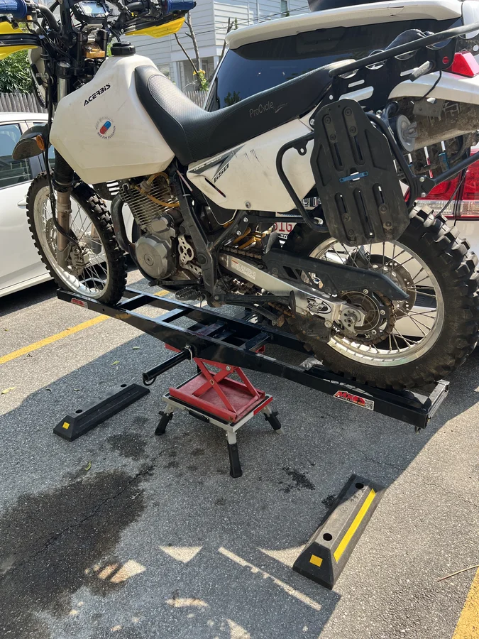

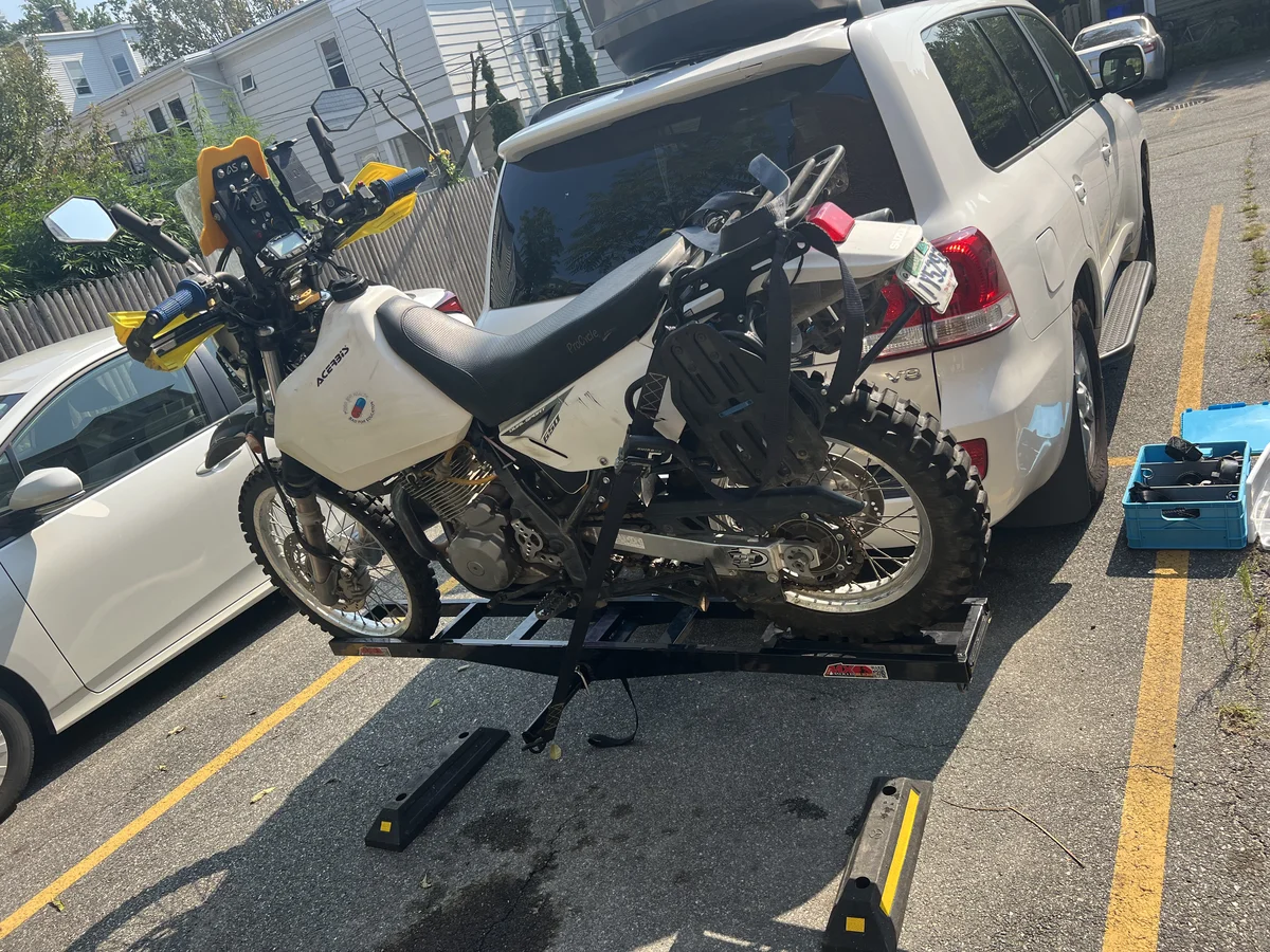

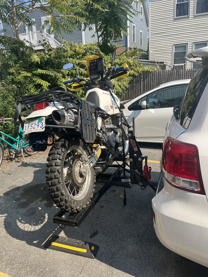

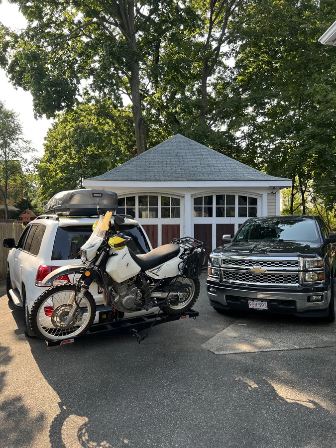

Hey All, I figure I'd ask the ih8tmud brain trust for some ideas / thoughts / suggestions.
I use the MX Hauler to transport my DR650 on the back of my LC200. Below are a photos of it in action.
  • MaxTrax recovery boards
    • When the MX Hauler is lowered to the ground it sits on two steel mount loops
      • I think this is a bad design
    • I bought two Parking Curb blocks to lower and raise the MX Hauler on
    • Could I replace the Parking curb blocks with MaxTrax recovery boards?
    • I'd place the Max trax recovery boards under the MX Hauler when I put DR650 on the hauler and when I lower it to take off.
    • I figure the MaxTrax would be durable enough to handle the weight coming down and up
    • I try my best to NOT just slam the hauler on the ground

    • The design of the MX Hauler is not the best with the weight of my bike
    • I cannot get the hauler up completely to slide in the locking pin
    • I need to use a motorcycle stand to raise it up enough to put in the locking pin

    • There three spots that allow rattle on the MX Hauler
      • Again, not the best design
    • I have yet to find a trail hitch tightener that will fit on the weird LC200 trial hitch
    • You hit a bump and the trailer bounces all over the place
    • My Black Widow hauler does not move around as much as the MX Hauler
    • Any suggestions?

Looks like a lot of force applied to a very long lever arm.
No reason maxtrax wouldn't work in place of those blocks, but you might need to stack more than one to get the height. What are they supposed to be doing? It looks like the loops on the carrier could hold the load.

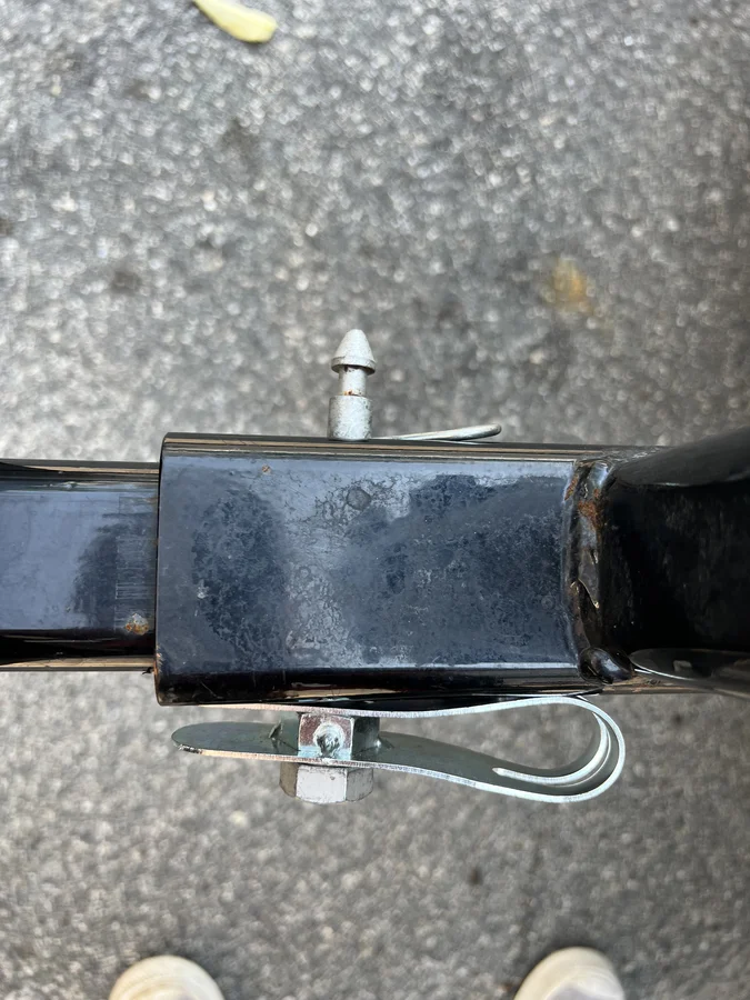

That silver hitch pin looks sketchy. Factor55 makes some really nice ones, but most of mine (except the one I use for recoveries) are just cheapo Reese brand.

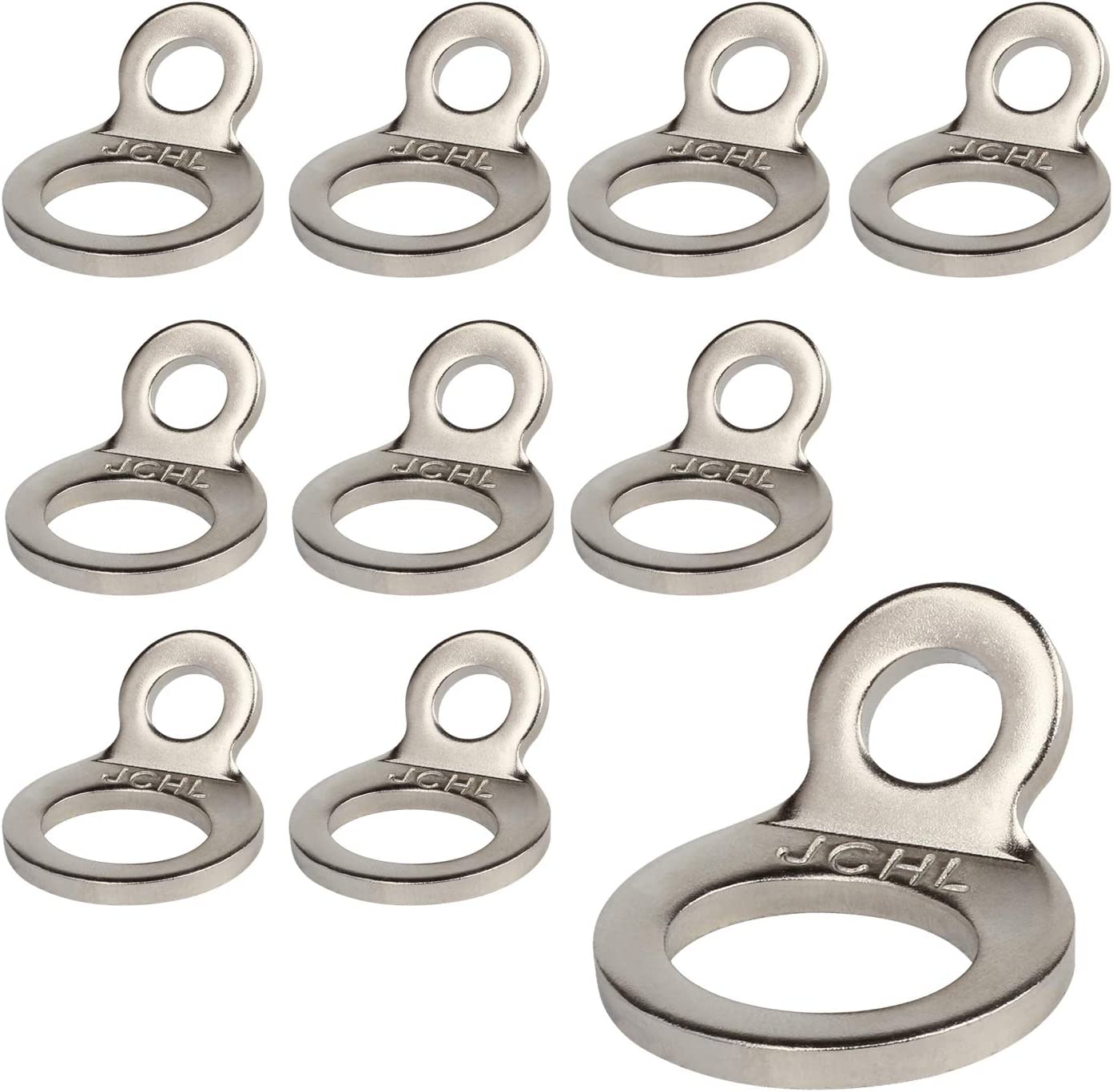

Tie down rings like these are great.
They bolt onto the fork/crown bolts.

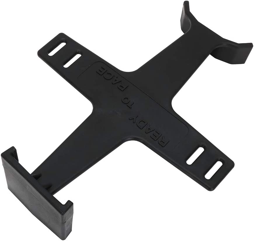

A fork brace like this is a good thing too. You could make one out of a stack of hockey pucks or a couple of lengths of 2x4 instead.
a locking hitch pin like this works well.
and this is an anti-rattle device that I've been able to work with.
