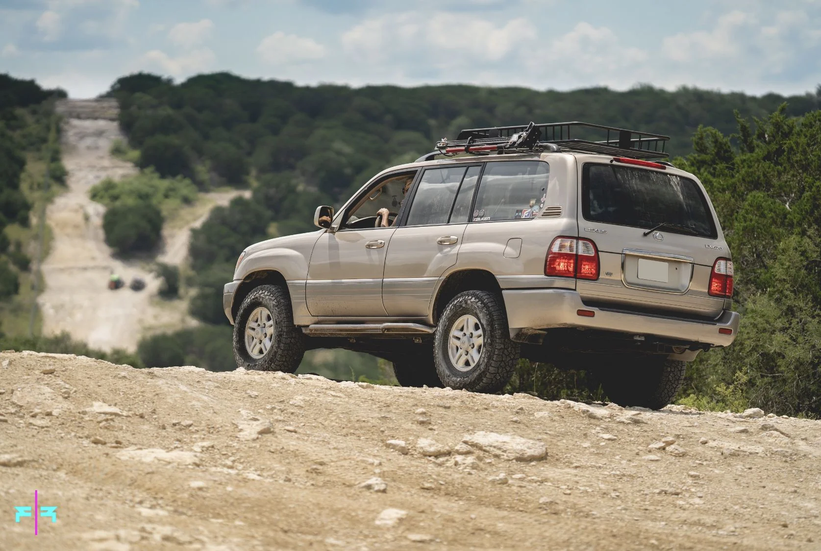

I’ve actually done it using those exact mounting points. I bolted them onto the side rails but near a 45 degree angle so the orientation had the point in the U bolt at one of the corners of the factory side rails. It was extremely sturdy and I was surprised it was that easy. This is the only pic I have though of that setup unfortunately
Perfect!!! Thanks a ton for posting this. This is exactly what I was hoping for, that setup looks great.
Quick question .... did you go with the 700 (1-2'') or the 750 (2-3'')? Measuring the side rails, it seems like it could go either way?
It was the smaller 700 one yes. Good luck

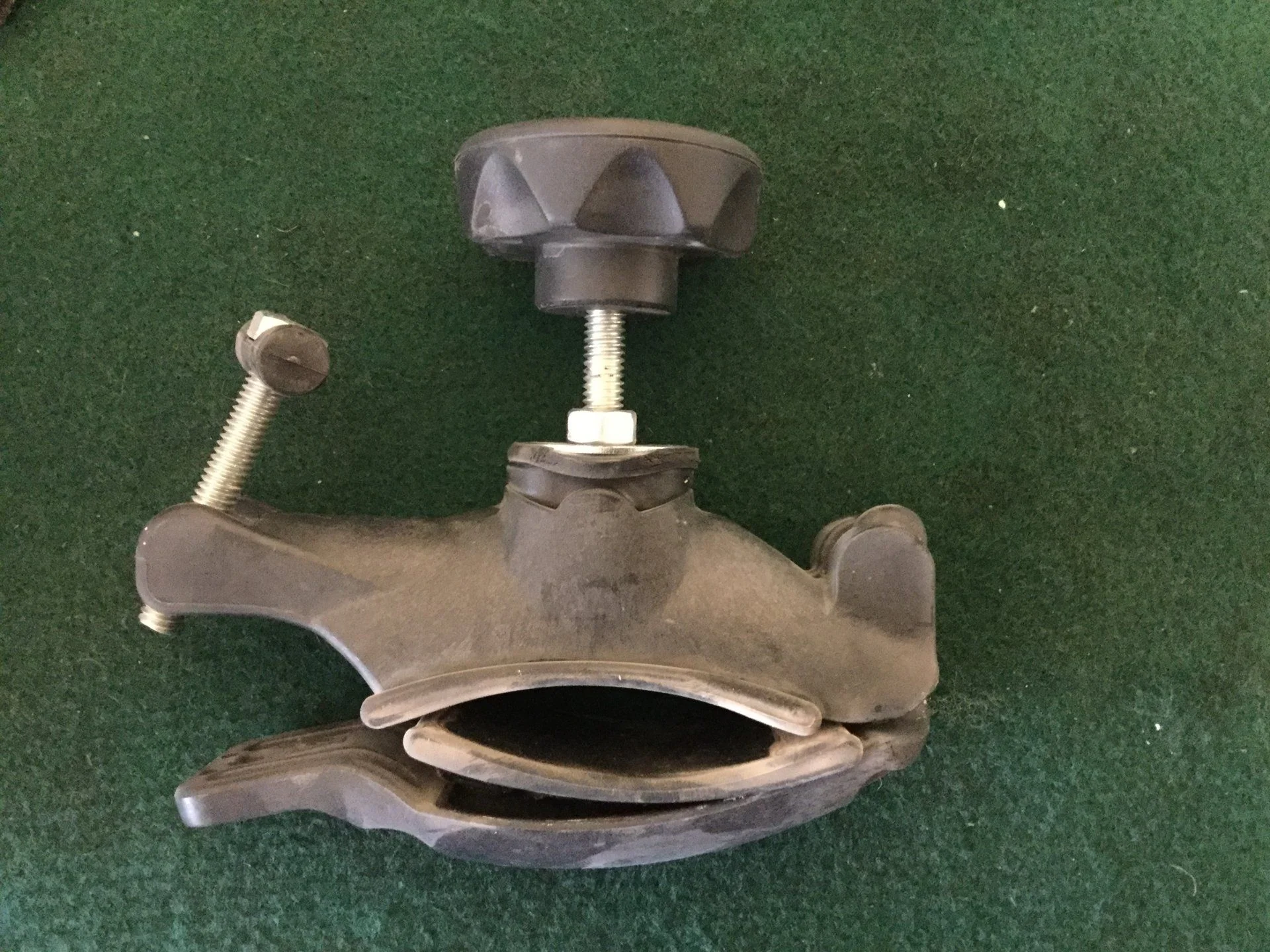

I use the mighty mounts, no Slee needed. I secure them up through the holes on the jack. Bought some round threaded knobs of the web and use a locking washer with them. Never budged once. Used a longer, if I recall, center bolt and a nut/washer to keep it in place.
