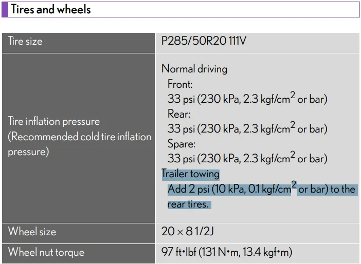

If laden heavy for a trip or towing, apply common sense and possibly increase tire pressures. If this seems suspect as a legitimate strategy, OEMs do recommend exactly this to strike a balance ride quality with load handling. From the LX570 manual:
