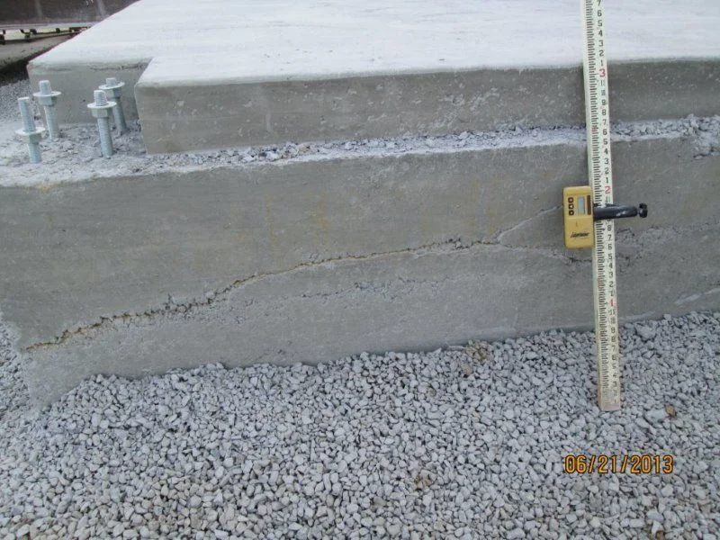

Looks like you've got it squared away. Thought Id throw these ones out there for fun, just so you can see the rebar. These are several months old as later pics have subsequent walls and columns with columns having 3" rebar threaded for plates.
That's a lot of steel in that concrete. It looks like it could be really difficult to get the concrete to fill without voids.

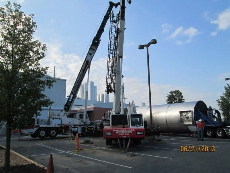

That is what vibrators are for, Holly Cow, post pics of the load. please.
vibrators are over rated...or atleast this is what the contractor I am dealing with on this project to support a 40' tall silo and plans for an 80' in the future. I came back to this headache after vacation....
