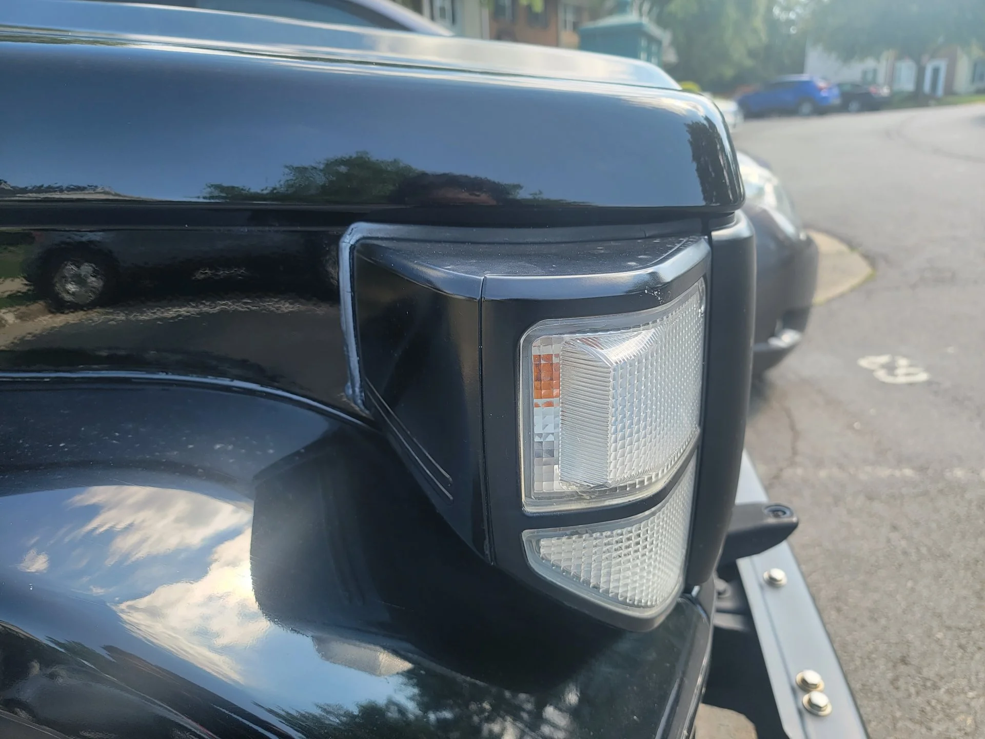

hey all, brand new HZJ77 owner and i'm a bit confused and i can't seem to find the information i need in tech. my LC came with a "modern" grill and clear turn signal lenses. i ordered a pair of original yellow turn signal lenses from cruiser outfitters but they turned out to be too small. are my front grill and turn signals aftermarket? i like the look of the older grill and signals with the toyota name badge and would like to replace what i have but i'm confused as to which part numbers i need. any help to point me in the right direction would be greatly appreciated.
Hey! What year is your cruiser? The original style for yours I'm guessing is the same as mine, which had a "TOYOTA" style grille from factory. The next iteration of the grille is what you have. It's factory, but only came out in the later years of the 90's (I forget which year in particular.)
Also, the same goes for your turn signals. The ones you have are also the later version, which as you can tell, have a larger surround to them.
Here are the part numbers you are after:
Your current grille:
Your current turn-signal parts:
Your OEM grille (assuming you had an earlier year 199x model):
Your OEM turn signal parts:
So the lenses that will fit these turn signals would be:
RH: 81511-60560
LH: 81521-60430
I like to use toyodiy.com for part number checking in conjunction with Amayama for their diagrams.
Hope that helps!

it helps immensely, thank you for the information! i will be shopping around today for the correct sizes. according to the auction sheet, mine is a 1990. thanks again! 🍻🍻
