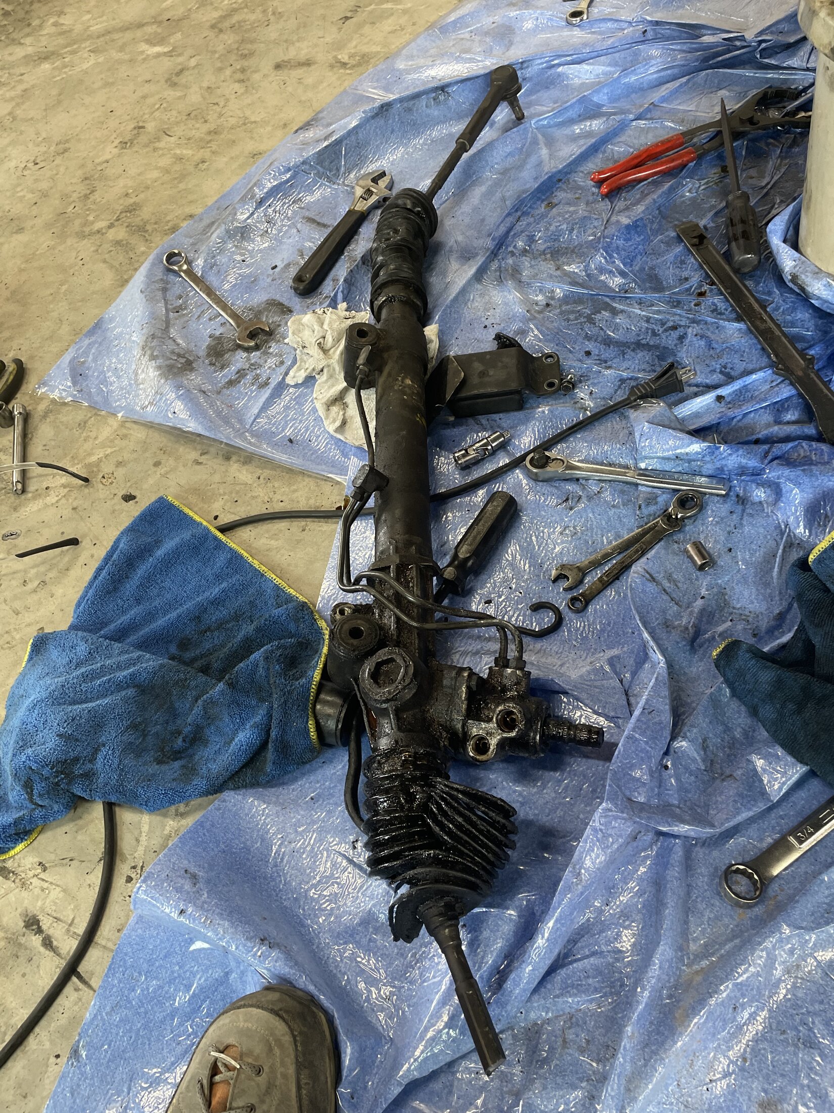

1) Steering rack replaced. OEM reman from Toyota. I picked this up last year on a sale, forget the price and dealer but solid deal if I remember correctly. It sat on a dog kennel for about a year until this weekend
-This job sucks, but I had everything on the front end out already because of OME kit, arms, sway, tie rods, knuckle calipers etc. my bushings were shot, zero fluid in the system and I’m genuinely shocked that I was able to ride out 40k with essentially a dried out steering rack on no bushings. Toyota eh? Don’t do this folks. I’m a fool and push things past the point I should. It could have done a ton more damage, and I’m sure altered the lifespan of some parts.
-if you’re doing this job, go ahead and get new reservoir hoses. My HP and return on the rack were in fine shape, but I chased air in the system for half a day before realizing the underside of the outlet line on the reservoir cracked cleanly in half. Eventually I’ll replace the HP line and return from the gear but I saw nothing that warranted adding more work at the time (and money) and the hoses are easy enough to get to on their own.
-I did this solo with the occasional help from my pops (he has a big shop and 40 years worth of tools, I do all my auto work at his place). There is only one part I can think of needing help from someone being vital, and that’s once everything is unbuttoned and you’re shimmying it out of the front end. I couldn’t get the tie rod busted off, so I ended up cutting at the rod and replacing with 555. Original were 555 and boots are in good shape. Unsure if prior replacement before me buying it. Would have to be, given the mileage and rack condition.
-the job really only takes about 8 hours, but give yourself some extra, especially if you haven’t done one before. I did one on my 100 two years ago and equally as sucky.
-Happy with the results and feel, long overdue and I’m good for another 150 I hope.
