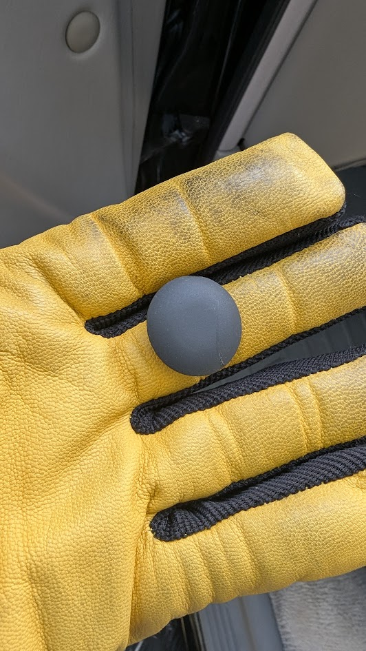

I'm missing one of these clips that cover the door bolts. Does anyone know where to source a replacement?
Also, I'm missing this clip where the glovebox door fits to
Plug, hole (for front door trim board) 90950-01800XX
»the XX stands for the trim color. "B0" is dark grey.
I'll leave it up to the crowd to fill out the suffix list.
The clip is either
90183-05103 (nut), or
90179-06127 (listed as "bracket for front lisence plate mounting", but it's in the dash)
I can't tell which, but neither is very expensive and both are used on the dash. FWIW, this is a common Toyota part and you can find loads of them in a yard in any Toyota dash. I pick up handsful of them, and misc. screws, everytime I wander through a yard. They ususally don't bother to charge for them.
Thanks you for responding.
Placed an order for the plastic clip as it shows available.
Will check harbor freight for the metal clip.
