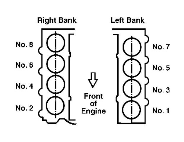

Rather than jack around with unlikely things I went to the local parts store and to my amazement they had another coil in stock (just one though). Next question, I vaguely remember seeing that cylinder numbering is different for Toyota than Chevy. Never mind that fact that I haven't had to care about that for 30 or more years. Vehicles have come a long way. So... which cylinder is #6?
Never mind. I found this:
