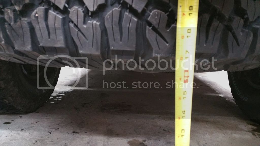

I got a brand new 315 BFG ko2 to "fit". It's not a perfect fit, but it'll work for me. It would definitely cause an issue doing any serious off-roading, but just about any tire in that spot would. I had to remove the stock hitch and make some adjustments to the brackets so it hangs down just under .5" than normal (if I were to guess) so it would shift rearward enough not to contact the pan hard rod. It's probably got about 1/8" clearance right now.
