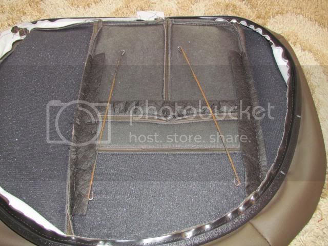

Now you are ready to prep the new cover
http://i84.photobucket.com/albums/k8/mrtucker80/IMG_3273_zpsa16dddec.jpg
Note the black edging and the pre-cut holes for the push pins to go back thru. On these covers Shane uses a heavy plastic edging that you use to hog ring the edges of the cover back onto the frame, however, there is a small hole in the edging and if you cut one end off of the original metal rod then you can actually slide the metal rod back into the plastic to give it some added rigidity.
http://i84.photobucket.com/albums/k8/mrtucker80/IMG_3268_zps3b1d1256.jpg
http://i84.photobucket.com/albums/k8/mrtucker80/IMG_3269_zpsf620cd08.jpg
I did one completely before I realized this and I went back and fixed it. The plastic trim bows considerably and the addition of the rod seems to keep more even tension on the whole length of the fabric.

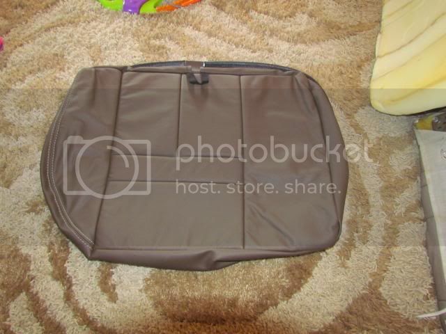

After a couple of weeks I got the big box at my office. I opted for both rows in a darker brown leather with tan stitching, a set of his seat heaters and a new drivers seat cushion, going all in on this one. I sent him my console lid and he even recovered that for me to match. I couldn't stand it an I threw that back on that day to see how it was going to look.
http://i84.photobucket.com/albums/k8/mrtucker80/2013-03-12_11-43-02_8512_zpse0f656c6.jpg
Pretty darn close to the dark brown trim color and I love the tan stitching.

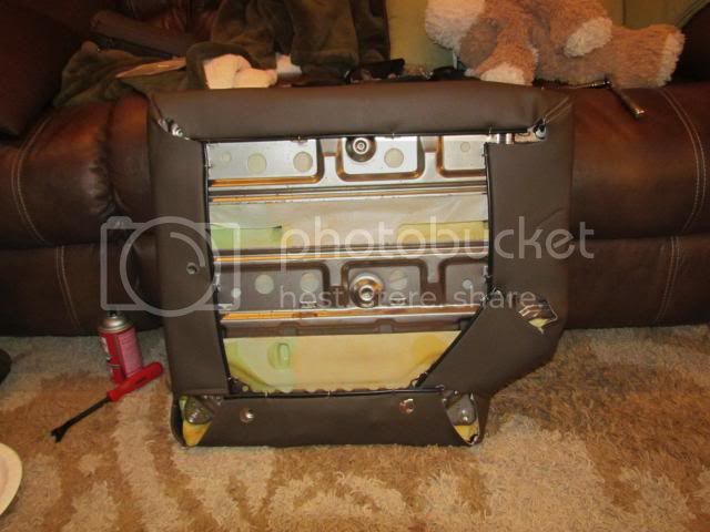

I started with the bottoms, there is a plastic edging that hold the cover onto the metal seat pan. Then 4 hog rings need to be removed to separate the cover from the seat foam.
Here, 2 on each side
http://i84.photobucket.com/albums/k8/mrtucker80/IMG_3256_zps608ef0b7.jpg
Then the cover comes off.
http://i84.photobucket.com/albums/k8/mrtucker80/IMG_3257_zps520d4468.jpg
New bottom

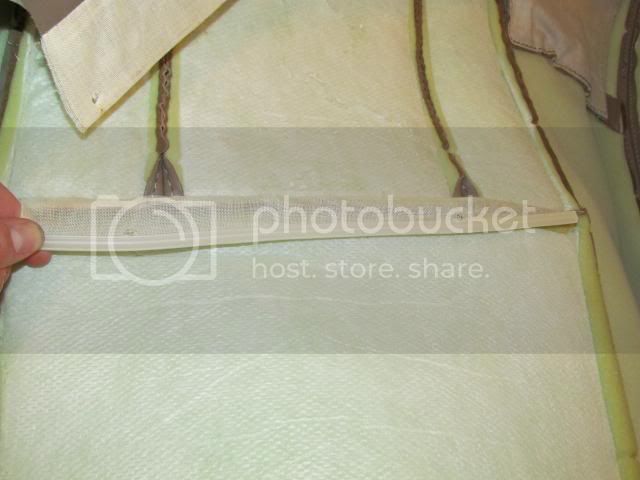

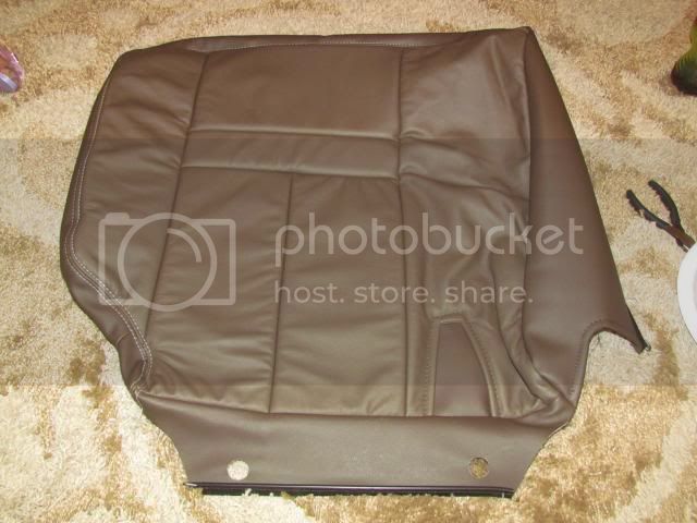

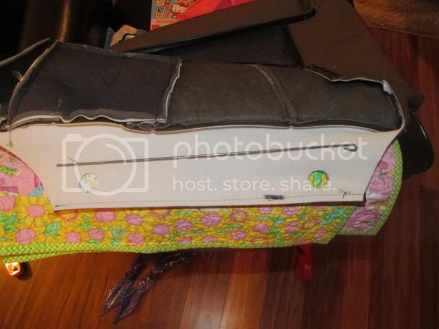

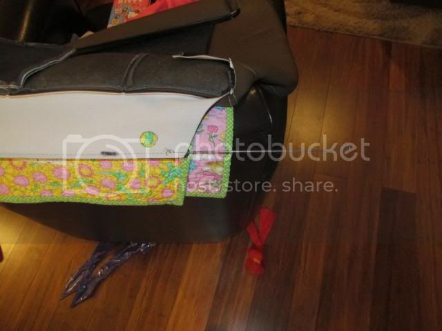

http://i84.photobucket.com/albums/k8/mrtucker80/IMG_3259_zps46bed257.jpg
Need to remove and reuse the little metal rods that come from the OE cover
http://i84.photobucket.com/albums/k8/mrtucker80/IMG_3261_zps9ef9400b.jpg
The material that Shane uses for the sleeves is a little heavier than the OE material.
