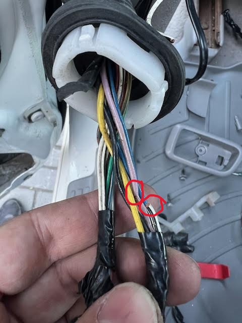

UPDATE: I went back to the shop as the owner insisted he should check that the 2 plugs for the door harness were clipped in correctly. As he was yanking the wires out in front of me I knew there HAD to be a broken wire. In my opinion no wires should be pulled as hard as he did - but that's beside the point.
The weather turned out to be good and I had a couple of free hours after work so I decided to go from the inside of the truck and check all the wiring. Everything looked good after unwrapping all the wires. I then removed the guts of the door and unwrapped all the wiring inside the door and found my culprit, along with a second wire that was nearly split.
The one white with black stripe was was broken off. I decided to cut the purple wire as it was already split, and patch in a new section as well.
Thanks for the help, Bisho. Though I didn't end up using your method, it is helpful to know how to do it should another window act up in the future.
