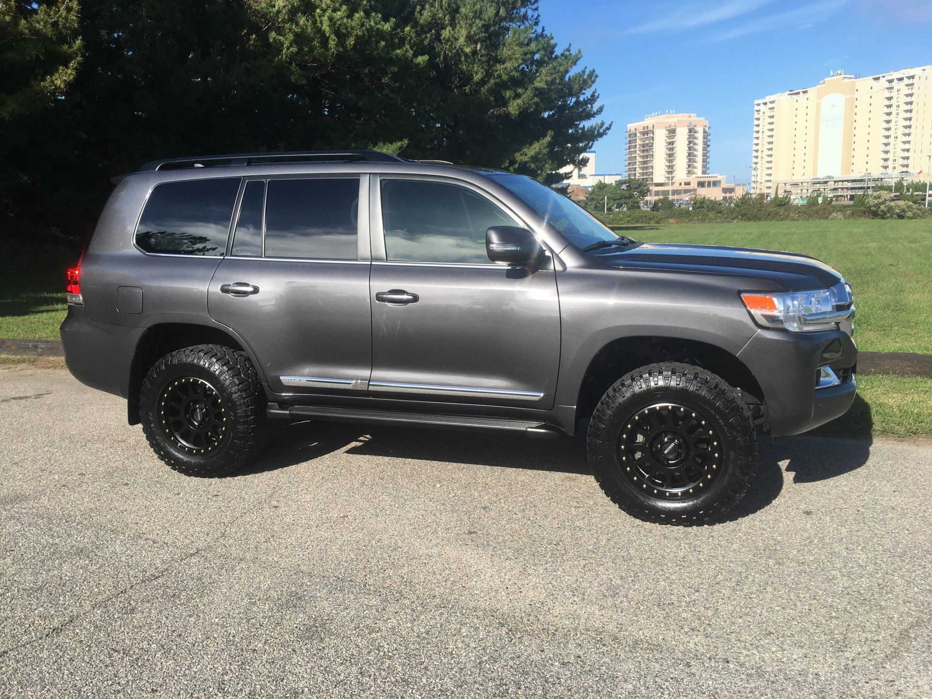

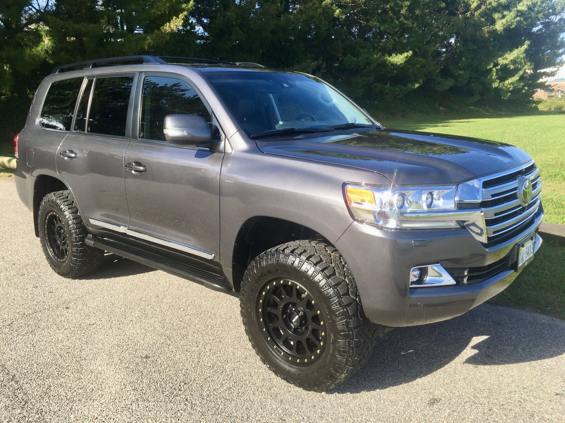

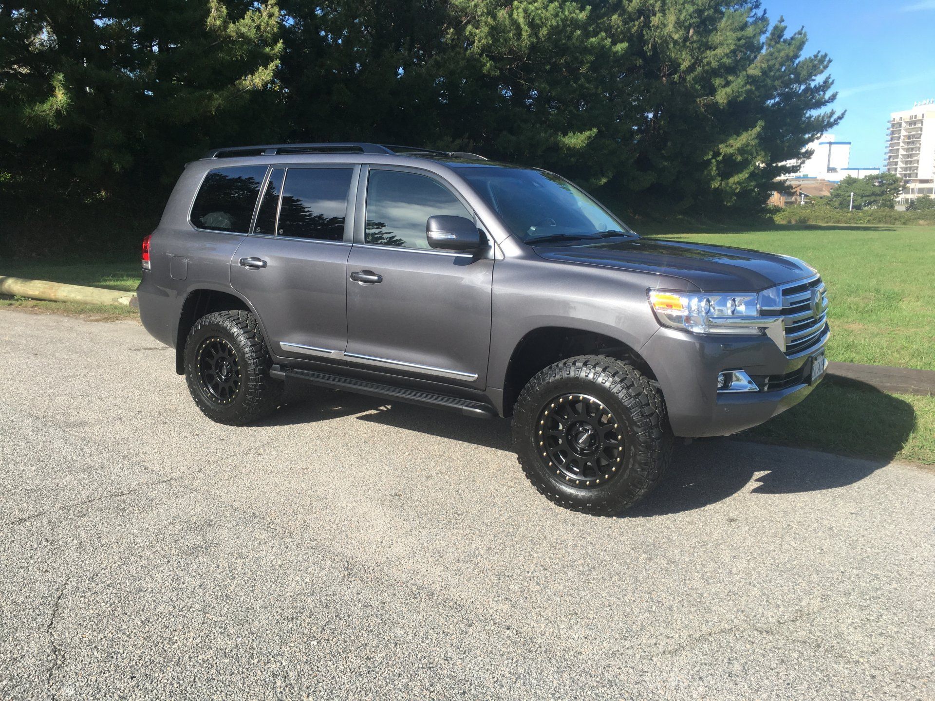

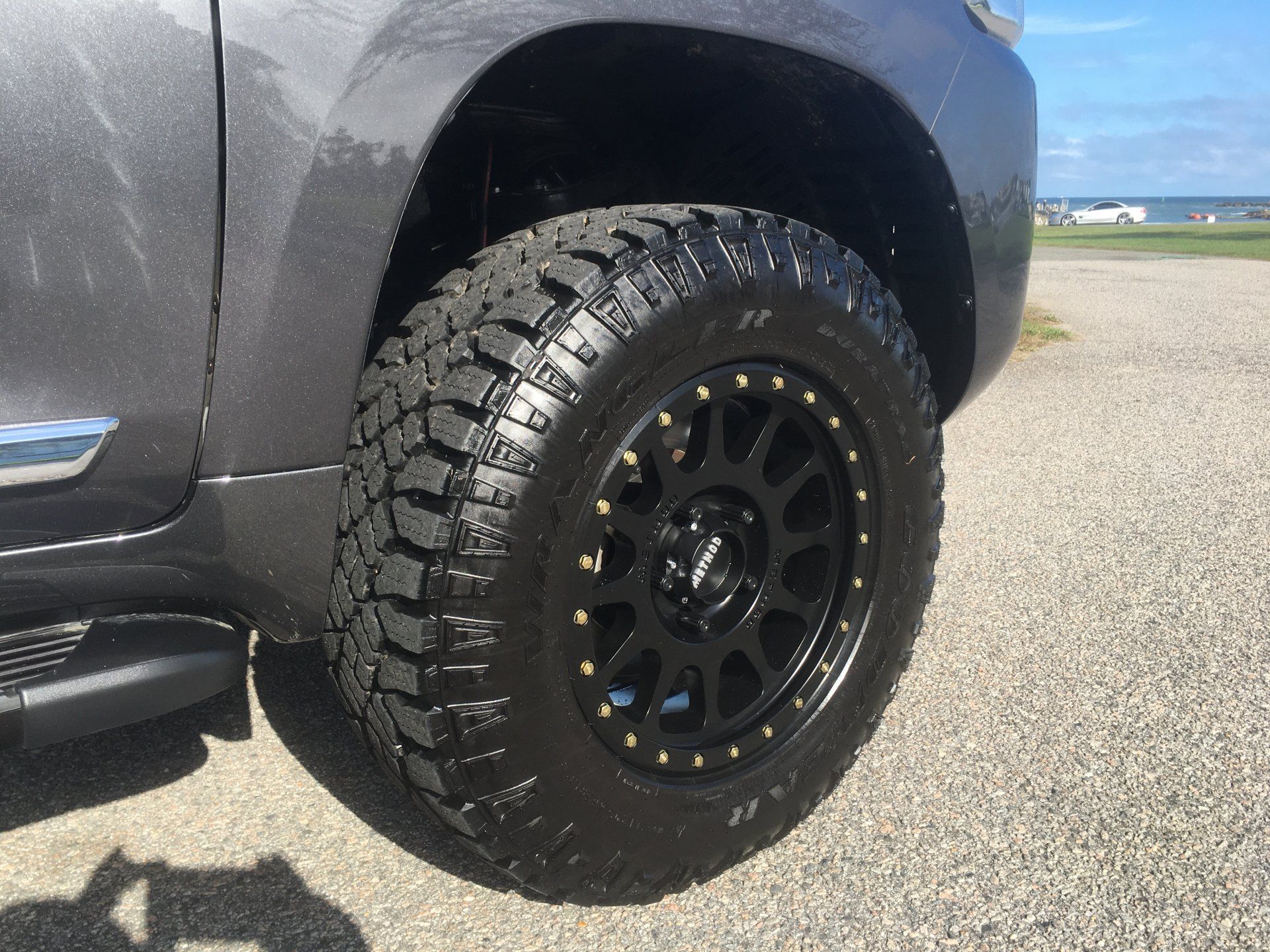

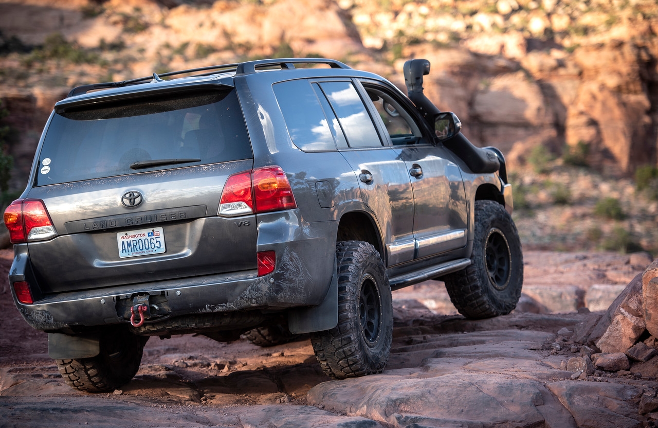

I had a post up last week with questions on offsets and I would just like to thank you all for the input ya gave me.
Due to Discount Tires damaging 3 of my wheels last week when they were rotating and balancing, they ended up buying me new wheels.
Very stand up company no doubt
There was some talk about the center caps not fitting with these wheels on a LC200 but that must be related to the LC100 series because these fit just perfect.
Previously I was on stock 2018 wheels done in black and using a Spidertrax 1.25 wheel spacer which gave it a nice stance but I kinda new in the back of my mind the wheel spacers are not ideal for a few different reasons.

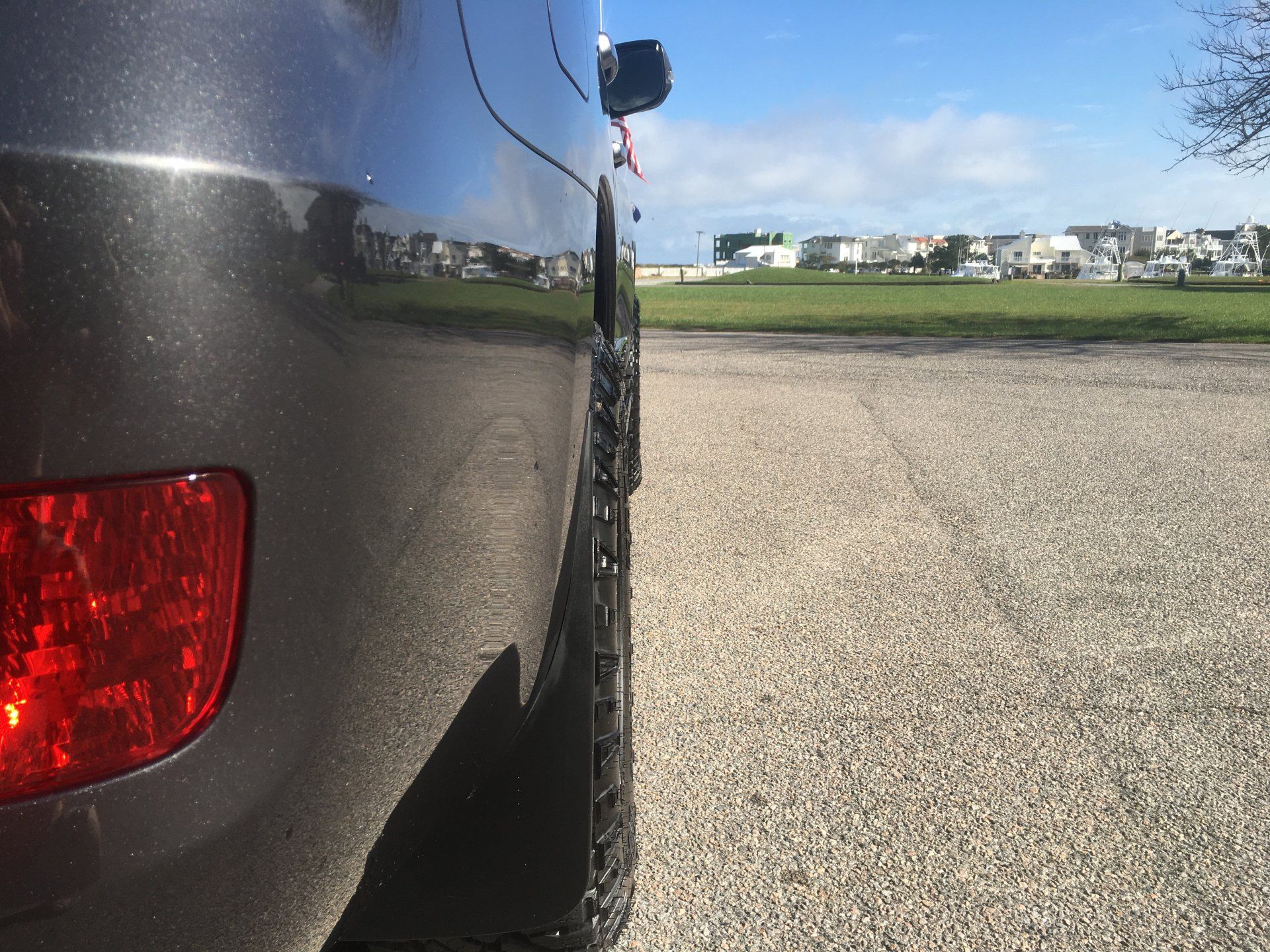

This is how the Method NV305 sits on a LC200 with +25 offset and 295/65/19 tires if anyone is curious.

Looks nice, what lift do you have. Btw like your color as I had the same sold it to a member

Any Trimming to fit the 295?

I have OME BP-51 set at 2" front mud flaps are now taken off and front side of fender well has be slightly manipulated, I did trim a few pieces but they are no longer on the vehicle due to skip plate system, if you don't have a lift and UCA's they would rub terribly. A heat gun and undoing a fews screws and making new home for the new screws is all that was really need
