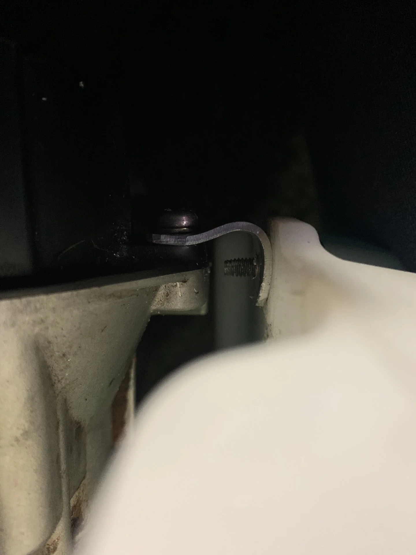

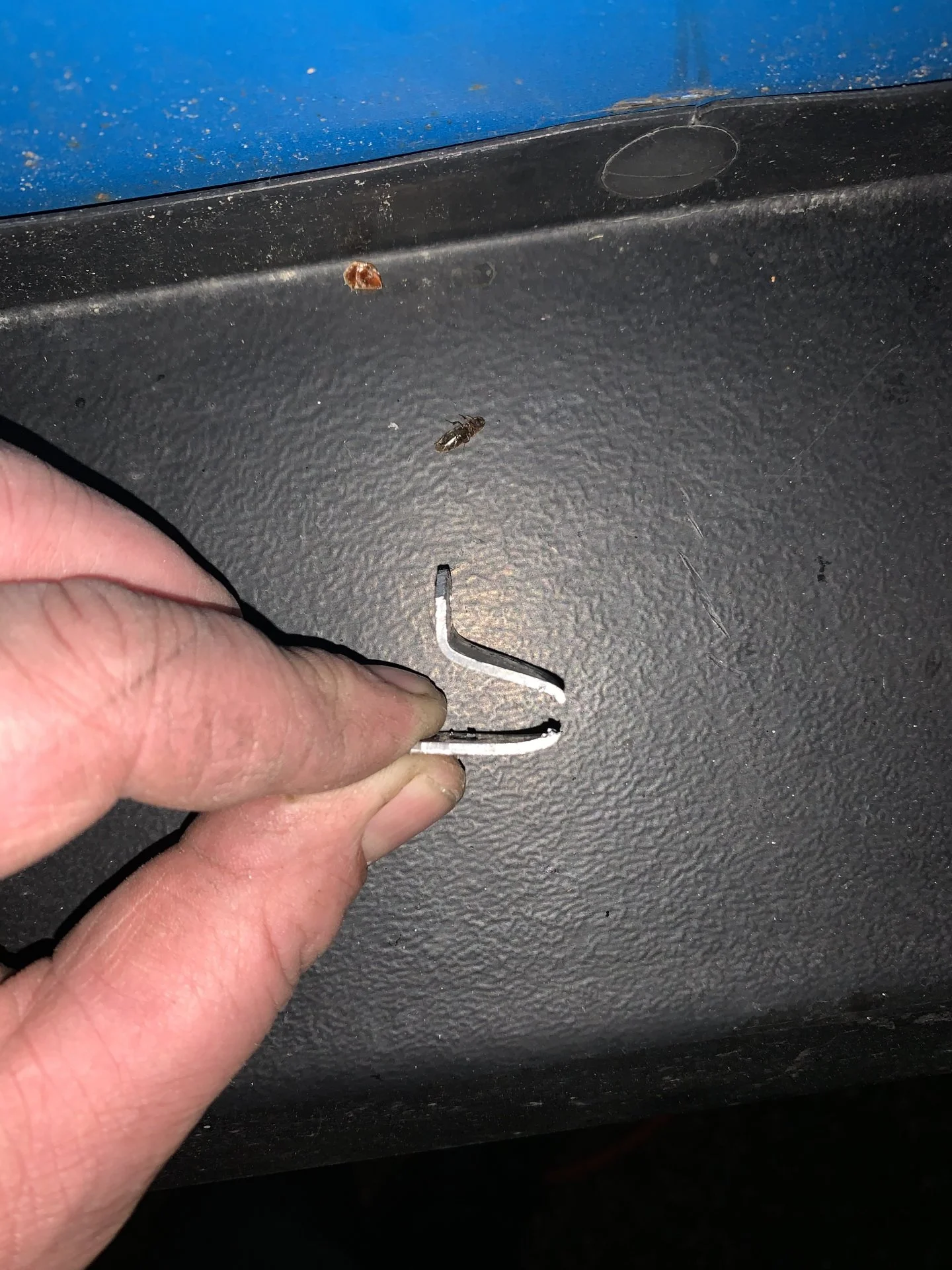

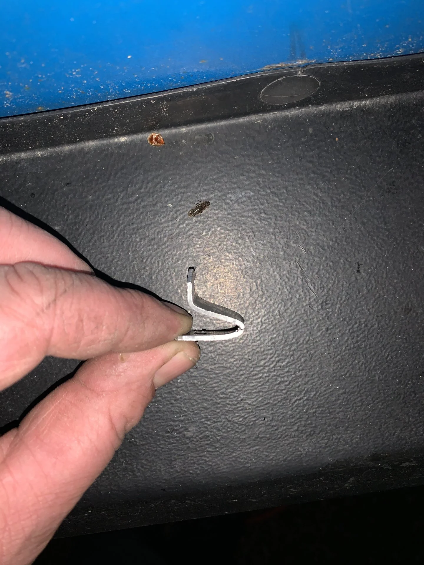

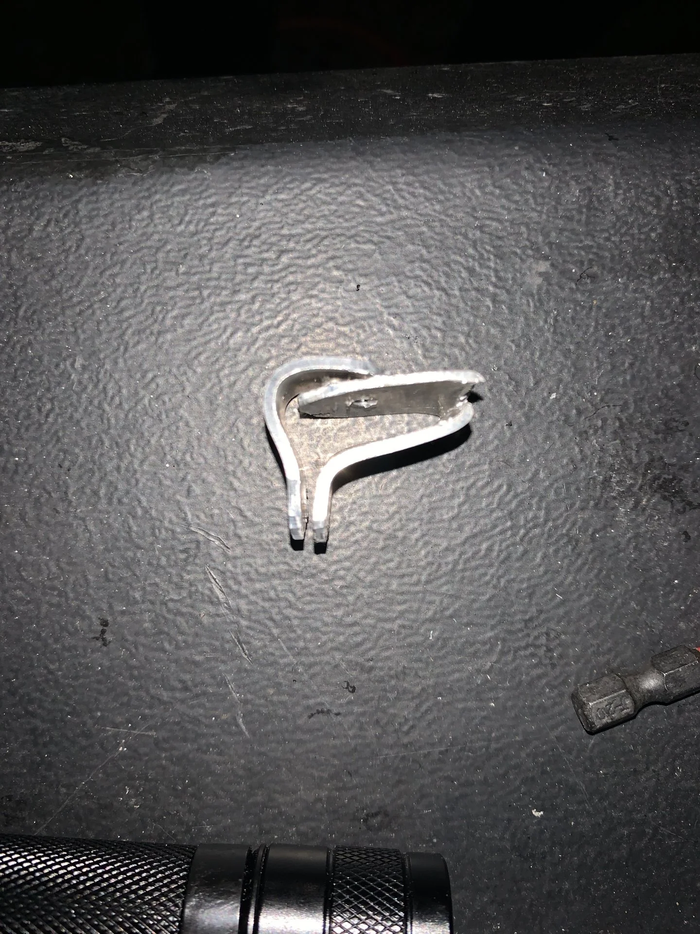

This small bracket was the first (prototype) mounting bracket... to mount a RYOBI fuel tank on my Stihl line trimmer. When I bent it up I knew that bending it past 90* was a compromise.
It lasted about 15-20 minutes. The small engine has almost no vibrations... but after using about 1/2 of a tank I discovered it broken at some point. Had it been a intercooler mount, turbo bracket, light mount, gauge mount, or 100 other things... the results could have more serious. In this case there were no problems as a result.
Here’s the new and improved version beside it
Note the angle is still past 90*, but only half of what the previous angle was and a wider radius.
For this application I used 1/16” aluminum. For a Cruiser I’d recommend a minimum 1/8”. Heat also helps to reduce internal stresses from bending metal.
