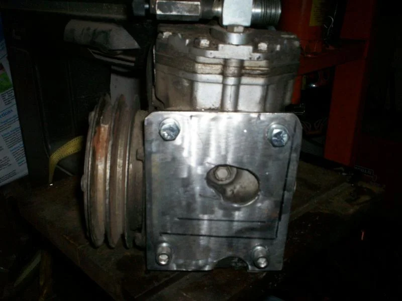

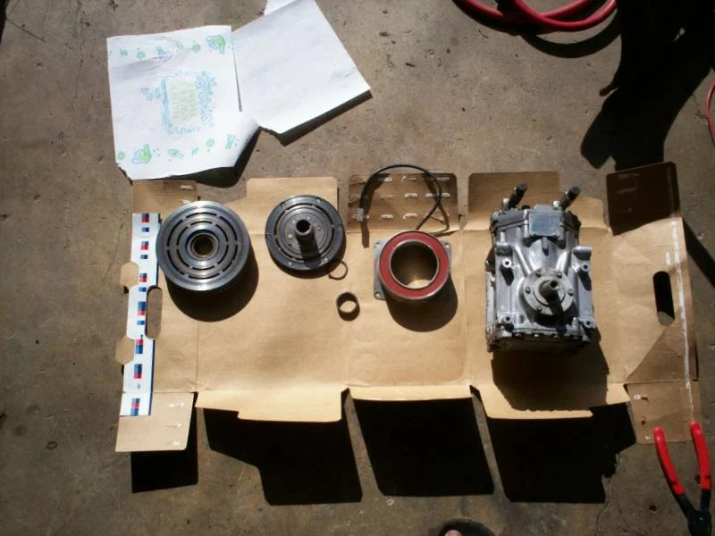

heres a couple pics from the york project.

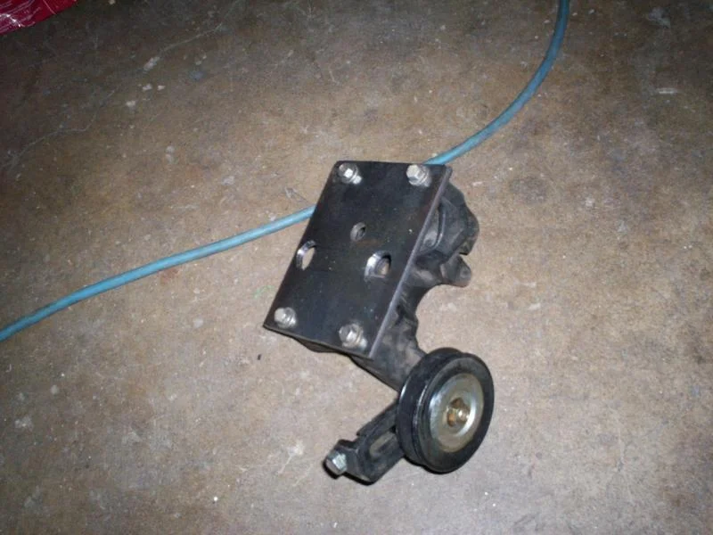

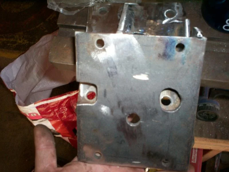

these pics are some rough bracketry pics.

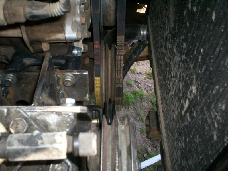

getting closer
cleaned up the pump and parts

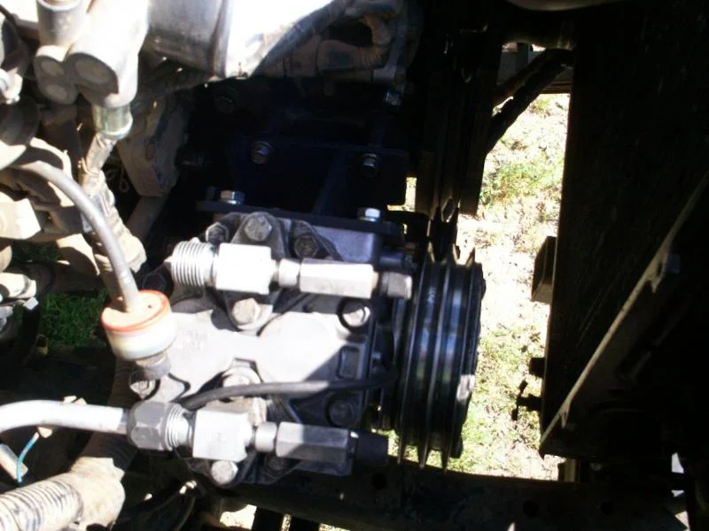

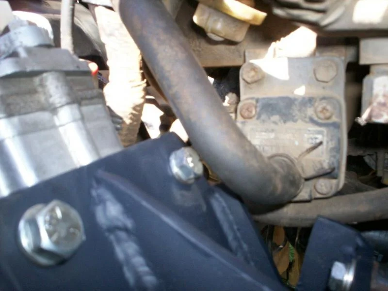

and on the truck

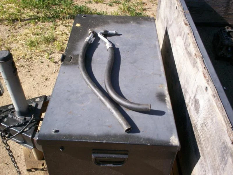

figuring out my hoses, these are stock yota A/C hoses that i kept from my runner.
my pile o' plumbing.

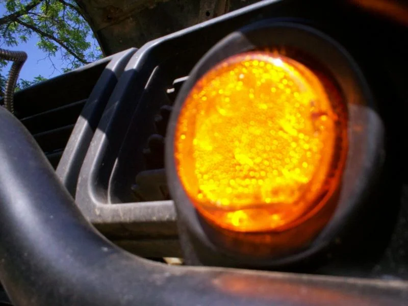

those fxxxing harbor freight special LEDs full of water, weak i bought some new ones from withams truck stop, the new ones are "trucklites" brand, havent installed yet, but its only two minutes.

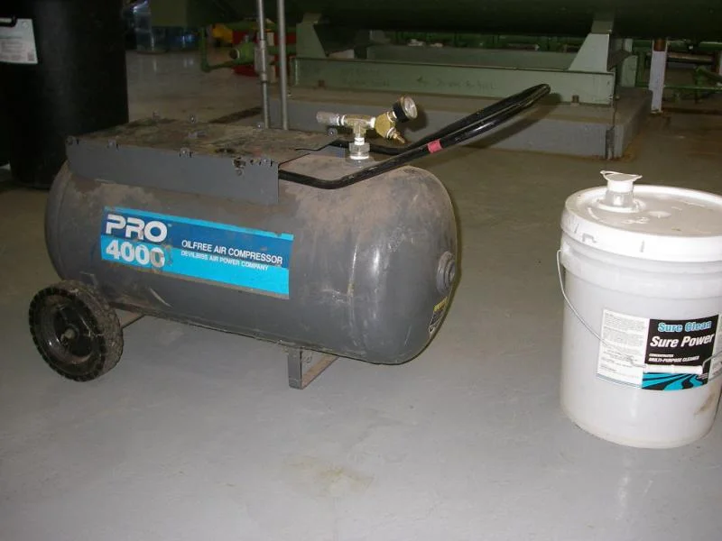

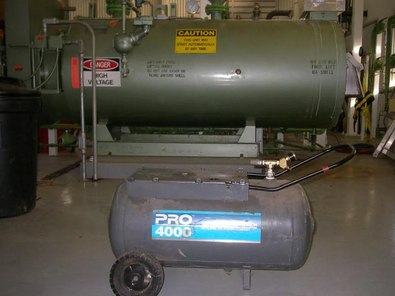

I got your air tank, it's bigger than you want, but the price is right;); 0.00 pesos.
I'll charge my camera and post a pic in a few, it measures 33"x14", was a lay down tank with a motor and pump bolted on top but the motor and compressor bits bit the dust a long time ago, it still has the handle and wheels, I trip over it more than I ever use it.

bucket for scale, boiler for hot water.

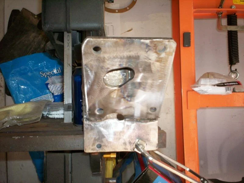

Was that Special K in the backround of pic 4? No but seriously very clean work!! You did an outstanding job fabbing up those mounts and such! Nice work!
