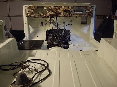

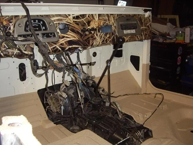

I used a single stage polyurethane inside my tub---have yet to do the outside but I am going to use the poly on that too. Reasoning that with no clear coat I can rub out scratches and touch up
I used interlux brightsides hatteris white (marine paint) ---a kind of off white, the tan is bedliner over top it. I like it, it is clean looking and will shine, but not too brilliant white which to me looks too modern on an FJ
but with paint to each his own eh?
