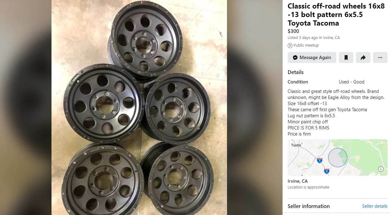

I found these cheap wheels and i think it would fit. i'm not sure what's the backspacing for these.
I want to put 285/75/16 all terrain on these.
my truck has some sort of lift already but im not sure what it is because i can't seem to find a name or logo haha.
do you guys think this would work?
As long as they clear the hubs they will fit fine. That is a minimal amount of offset.

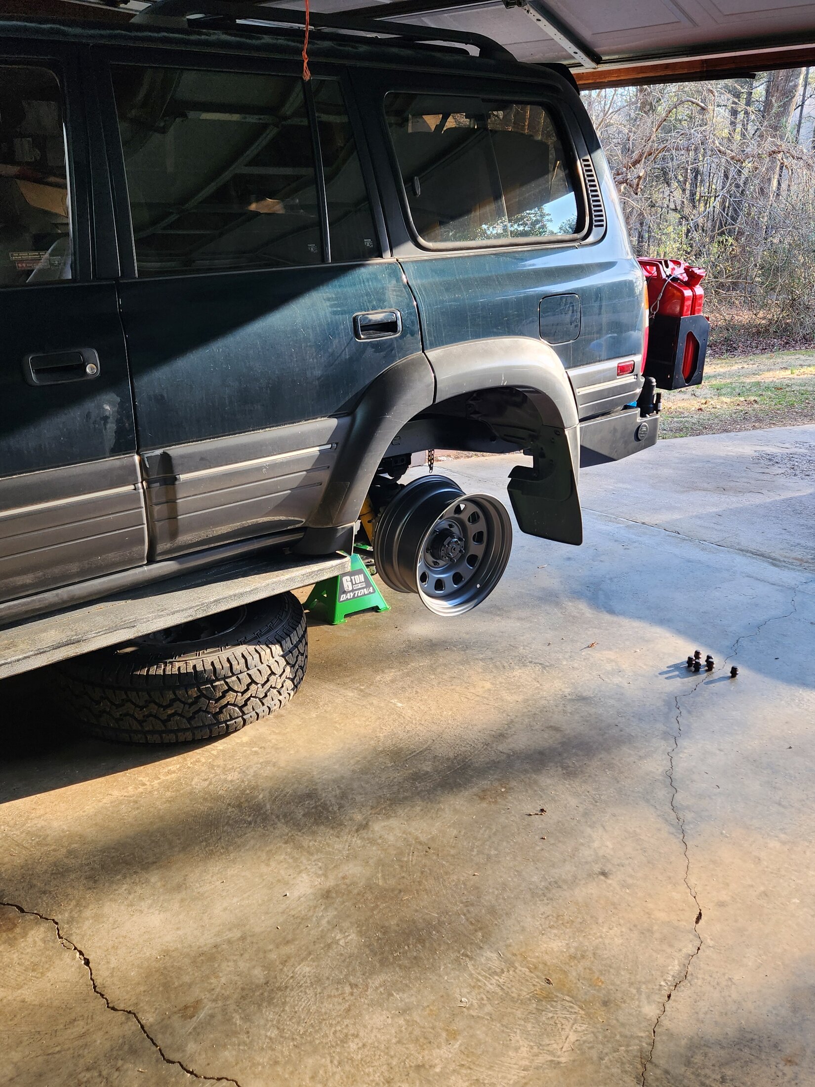

Here is a 16x8 -12 on mine
No I only purchased 1 to make sure they cleared the calipers. Haven't gotten around to buying the other 4. They do not stick out past the fender though. Can barely tell a difference from the factory wheels to be honest.

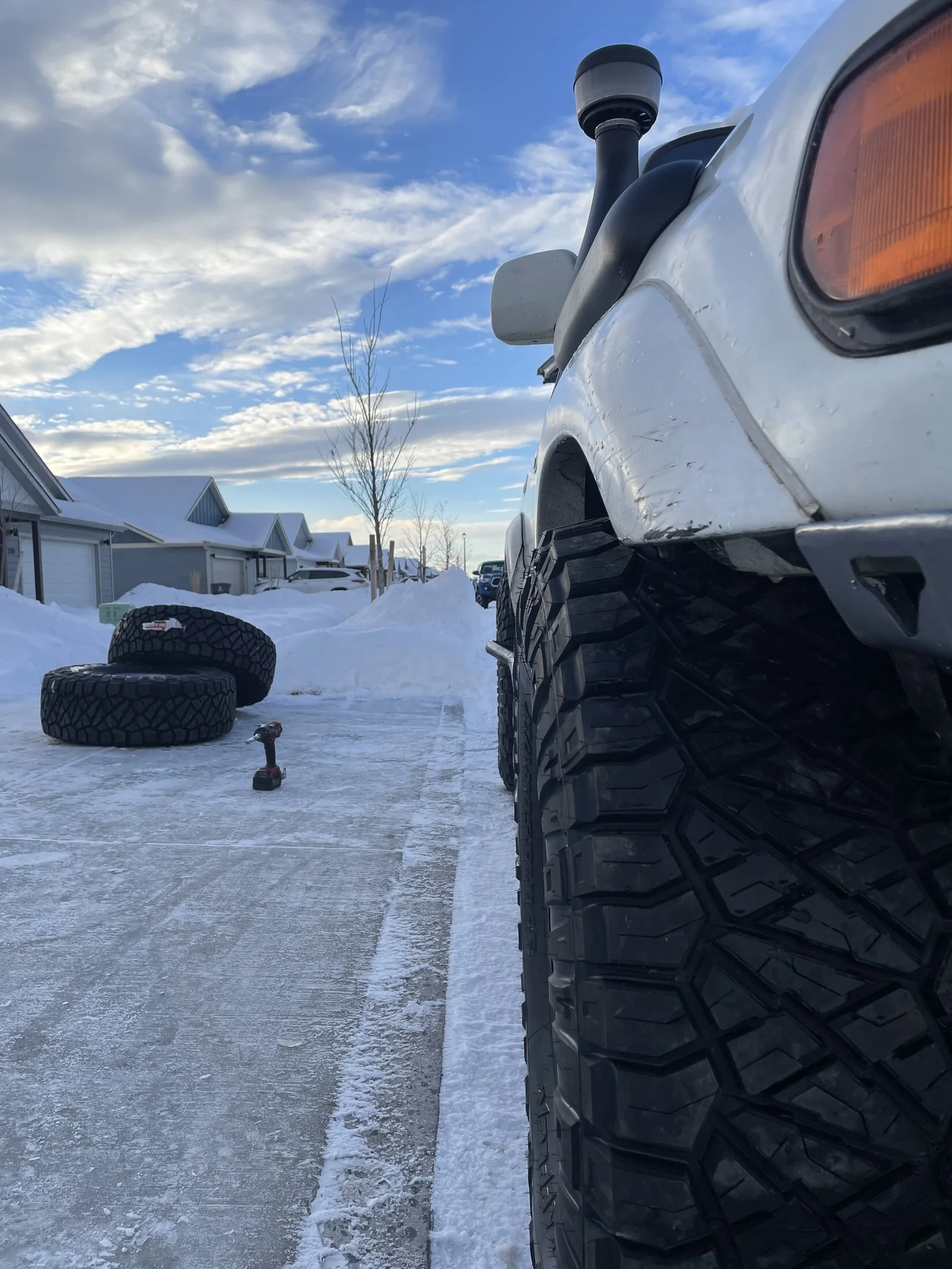

I have a similar question if anyone has this set up: 17x8.5. 0 offset, 4.75" backspacing with 35/12.5r17 (possibly Nitto Grappler MT or similar.
Please chime in, ready to pull the trigger.

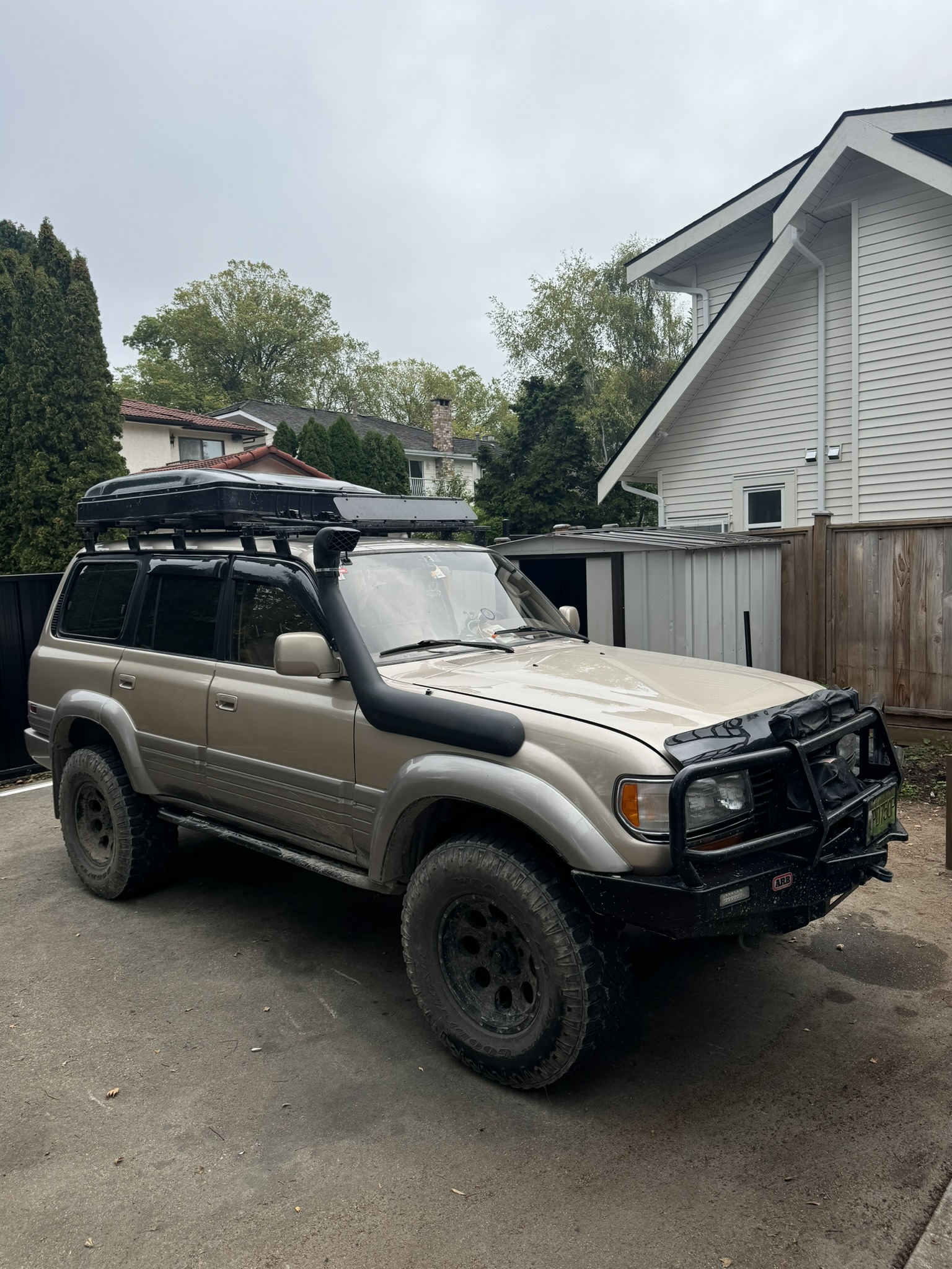

this is a sick setup! what size tires are those? what kind of lift do you have? what kind of tent is that? im thinking about getting a tent but my truck came with a roof rack. so im thinking about keeping the roof rack and try to build out a sleeping platform inside the cabin instead.
Thank you! It is running 315/70/17s and its on a 2.5" medium OME lift with 1" spacers. The tent is just a unnamed China clone we got it basically for free to do some testing. We used to do the sleeping inside the cabin thing, but I didn't enjoy taking out all our gear and finding somewhere to store it when its time to sleep. We still do it in the winter time as I don't have somewhere good to dry the tent off after winter camping trips.
