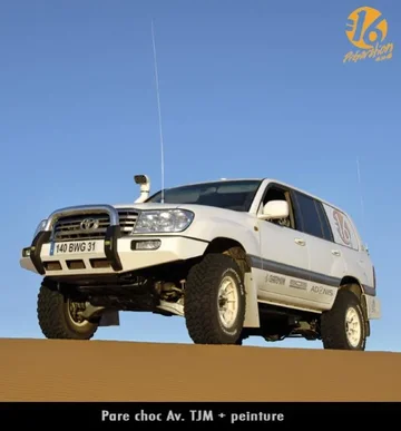

I think I can find pictures of a white 2003 with the BFG AT KO 265/75R/16s and stock suspension, macneills buddy that they just put the TJM side bars on had em.
EDIT - this is the only picture I seem to have
Well they certainly look comfortable under there. A little more narrow (-0.8inch) and a little shorter (-1.1inch) than the 285's according to the BFG website.
