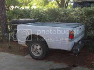

I have an Isuzu Pickup bed trailer similar to yours only my rear overhang is a lot farther. I have been kicking around the idea of bobbing the rear of the bed off and making it the same distance as the front box.
[URL="http://i31.photobucket.com/albums/c369/Curtis-J/IFS%20Off%20Road%20Trailer%20Build/DSCN0564.jpg"][/URL]
But so far the only thing that's keeping from cutting it up is there are is probably some guy out there who need a replacement bed for his old Isuzu pickup. I kinda hate to cut up something that somebody else could use more than me. These extended cab beds are getting hard to find! Mine has no rust and very few dents. Even the Tail Gate works.

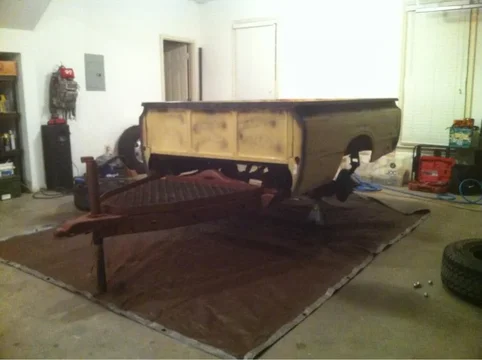

Bed is primed. Tongue is painted. Rest of frame, axle, springs, fender wells and bed bottom will get painted this week.

Well - the body has been wet-sanded and is ready for paint.
However, The big progress this weekend was sorting wiring and planning my harness. I ran a new 4-flat harness from the front through the frame rails to the back. This is a split harness so I have a brown (running light) lead down each side. It will use the OE connectors for the tail lights (you can see my labels). The lic plate lights and rear side markers (coming today from ebay) will be spliced in. All splices are looped, twisted, soldered (using my grandfathers soldering iron from waaay back) and sleeved w heat shrink. I attached the 4-flat ground in usual fashion to the frame up front. To ground OE lights, I've set up ground wires on each side of the frame. Everything will be wrapped in electrical tape. I've rewired probably a dozen boat trailers and campers. Never have I gone through so thoroughly as I am here. Not a single scotch-lock.
I also had to make a tool for raising and lowering the full size spare on the OE chain. I had some scrap steel tube. I ran a 1/4" bolt through one side, through 2 nuts inside the tube and out the other side then trimmed to to fit. I the epoxied the bolt and nuts in place from the inside. The tube was too fat to clear the OE access on the rear body. I made it long enough to work from underneath via a screwdriver through 2 holes. Yes - its long enough to clear the tire.
Borrowed a nice HVLP sprayer unit from a good pal today. This was my first experience spraying anything other than a rattle can. After thinning some Rustoleum about 9:1 (twice as much thinner as Rustoleum recommends) with mineral spirits & testing on some cardboard I went at it. After seeing some splatter, and not being able to rectify with the trigger adjustment, I thinned the paint further to about 3:1 and went along pretty satisfied. I put on 2 thin coats. Its been a perfect day and I almost shot on another light coat after 6 hours, but I'm going to be patient (again, unlike me), and let this dry well, wet-sand the whole thing and do a last coat right - probably at a 2:1 mix. So - sanding tomorrow, then Sunday's weather looks good for the final pass. I'm happy with it so far. I spent a lot of hours prepping, but I have to say - gloss black doesn't hide anything. Then again - as my wife reminded me - this thing is just a beater truck bed trailer. With the frame all painted, spare mounted, wiring all wrapped up and tested, it's coming together. My mind is racing with the thought of moving on to the "outfitting" portion of this project. For those wanting to try HVLP - its a lot cleaner than rattle-canning. I didn't have a layer of "dust" all over my garage when done. Just a little on my drop cloth. I didn't manage a single run, and I used less than half a quart of paint for these first 2 coats.
