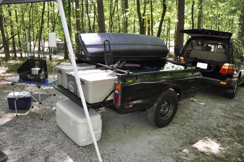

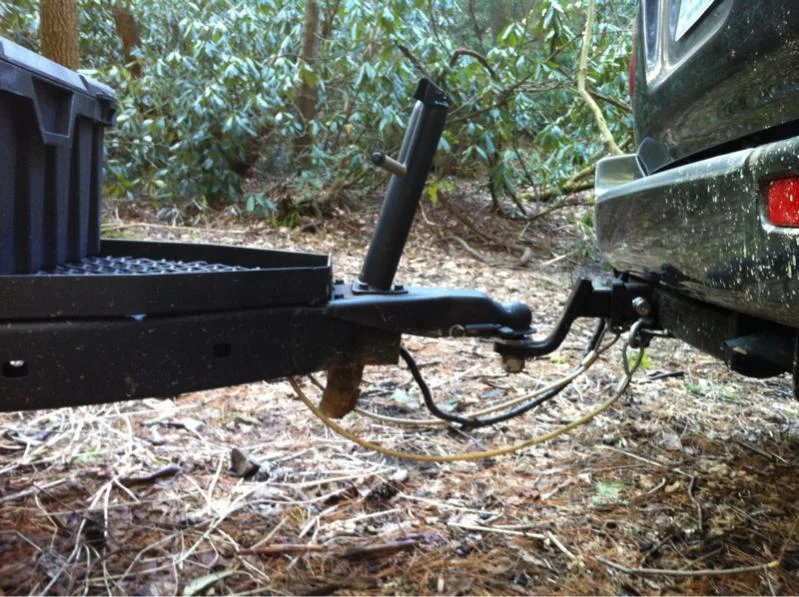

I just got back from camping in the Chattahoochee National Forest. I snagged my hitch and bent my tongue winch. Also snagged the license plate while grading a hill with the rear of the trailer :0)
This thing worked awesome though. Just tossed in a bunch of firewood, gear was in bins. Very smooth on forest service roads and trails. No beers exploded. Excellent camping was had.

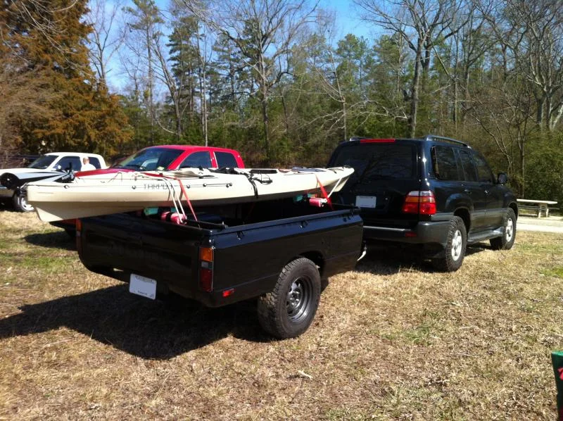

:beer: Finally got my Kayak. I mounted my Thule bars directly to the bed rails using Yakima Snap-Arounds. I need to make some better hull supports, but my ghetto pool noodle rigs support everything just fine for now.
The bars are almost 7' apart - which supports the 14' kayak well, but I'll need another crossbar or two to mount my Thule space case and my kids' 8' kayak. Will also set up a way to hang fishing rods and paddles under the crossbars.
I think I'm going to skip the springover. The boat is at a good height for storing it and being able to work on it. As for clearance, I pushed it pretty hard on my camping trip where the jack got bent. I've found a jack that has a few inches more clearance and that will make all the difference I need.

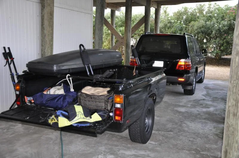

Update: This thing has been serving me very well. Camping rig. Beach Trip Rig. Hauled up to 4 kayaks. Countless Home Depot Trips & Dump Runs too.

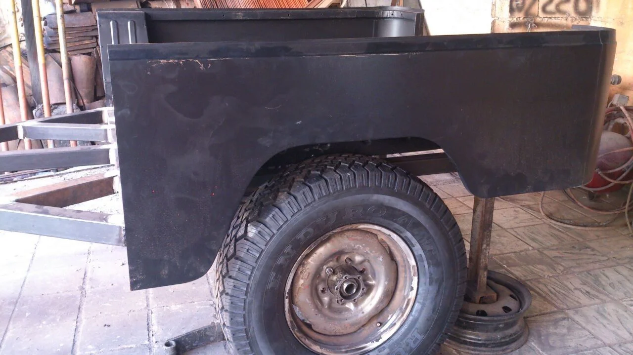

These are great trailers. Great reuse of a Toyota truck. I am working on a trailer using a new FJ43 tub. I have thread on here. I am doing a storage box on the tongue too similar to the contractor box. Using six bolt hubs. Those are 265/75/16 tires.
