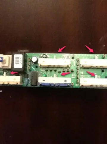

That sounds like the problem I had originally. I took the unit out to have a look, but nothing worked immediately after putting it back together. After a while, the other windows worked, but the drivers window and lock didn't come back.
Wondering if there is a way to reset, or did I fry it?
Highly unlikely that you damaged it. When you 'took a look', what did you do?
If you separated the white electronics board from the black rocker panel it possible that you missed setting the switch arm [white circles in my pic on the thread above] with the rocker slot. The switch def would not work if that was the case.
No cracks when I opened it up, but the white pins were in the wrong position. The rocker was not latching on. Going to put it back in tomorrow after the rain stops.
Thanks for the guidance! Couldn't come up with anything through search.
That did the trick.
The white pins on the driver window and lock had slipped out of place so the rockers weren't connected.
Much cheaper than a new master switch.

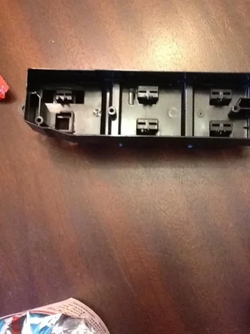

Am I the only person whose master window switch buttons ALL broke loose? They all still 'work' if you press and bend them in unnatural ways but it is an obvious poor choice of plastic for this function. I'm afraid I'll have to bite and buy a new one. Ouch. Thanks again Toyota...
Before you drop $300 on this, take your switch apart (link earlier in this thread). It may well be repairable. If you are unsure, post a pic of the black plastic switch base and we'll have a look. Its typically spider web cracking in the plastic and the repair is stronger than the original.
