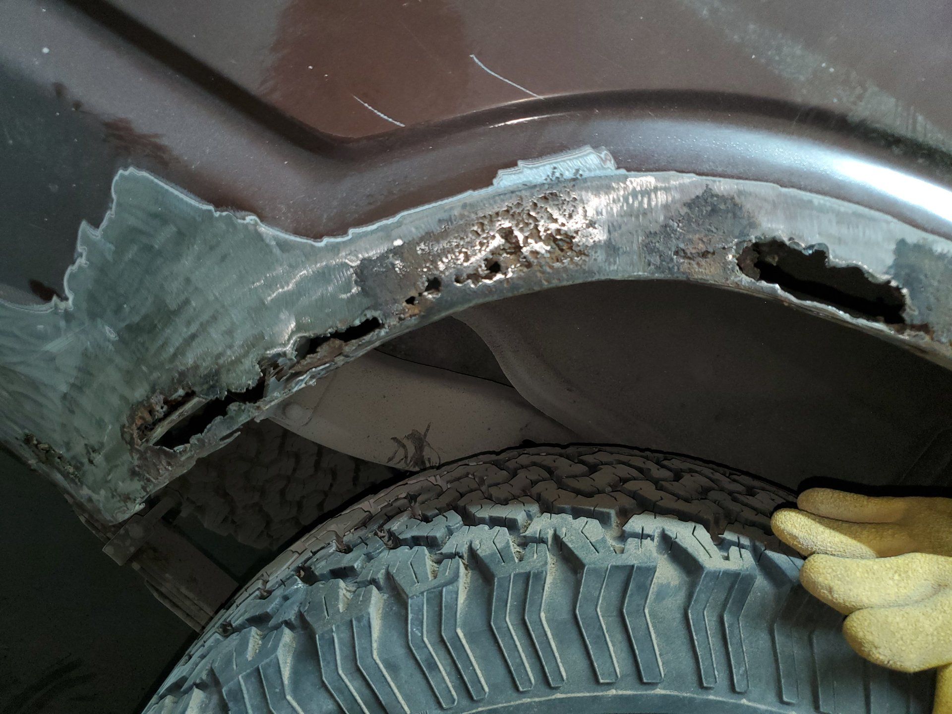

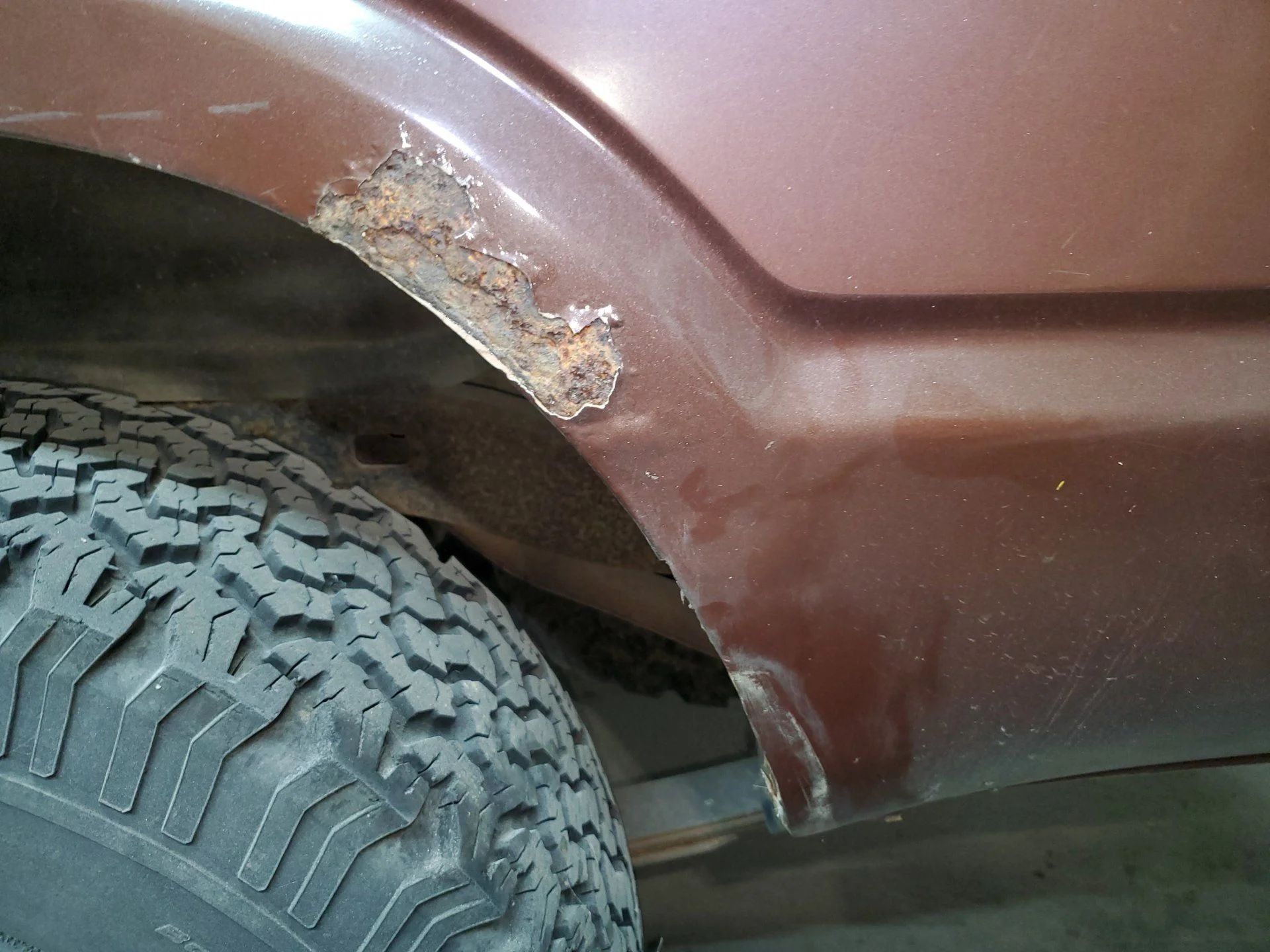

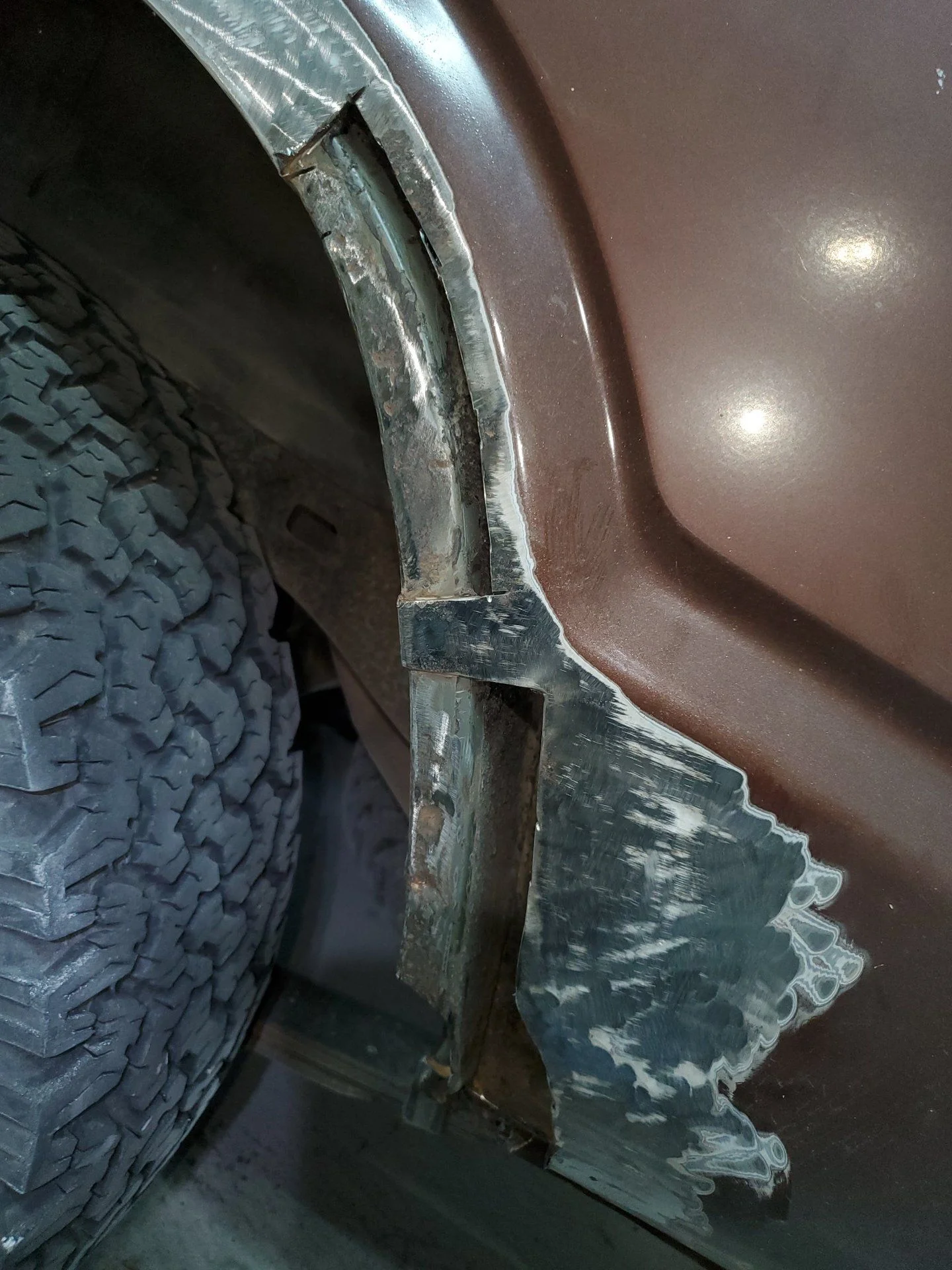

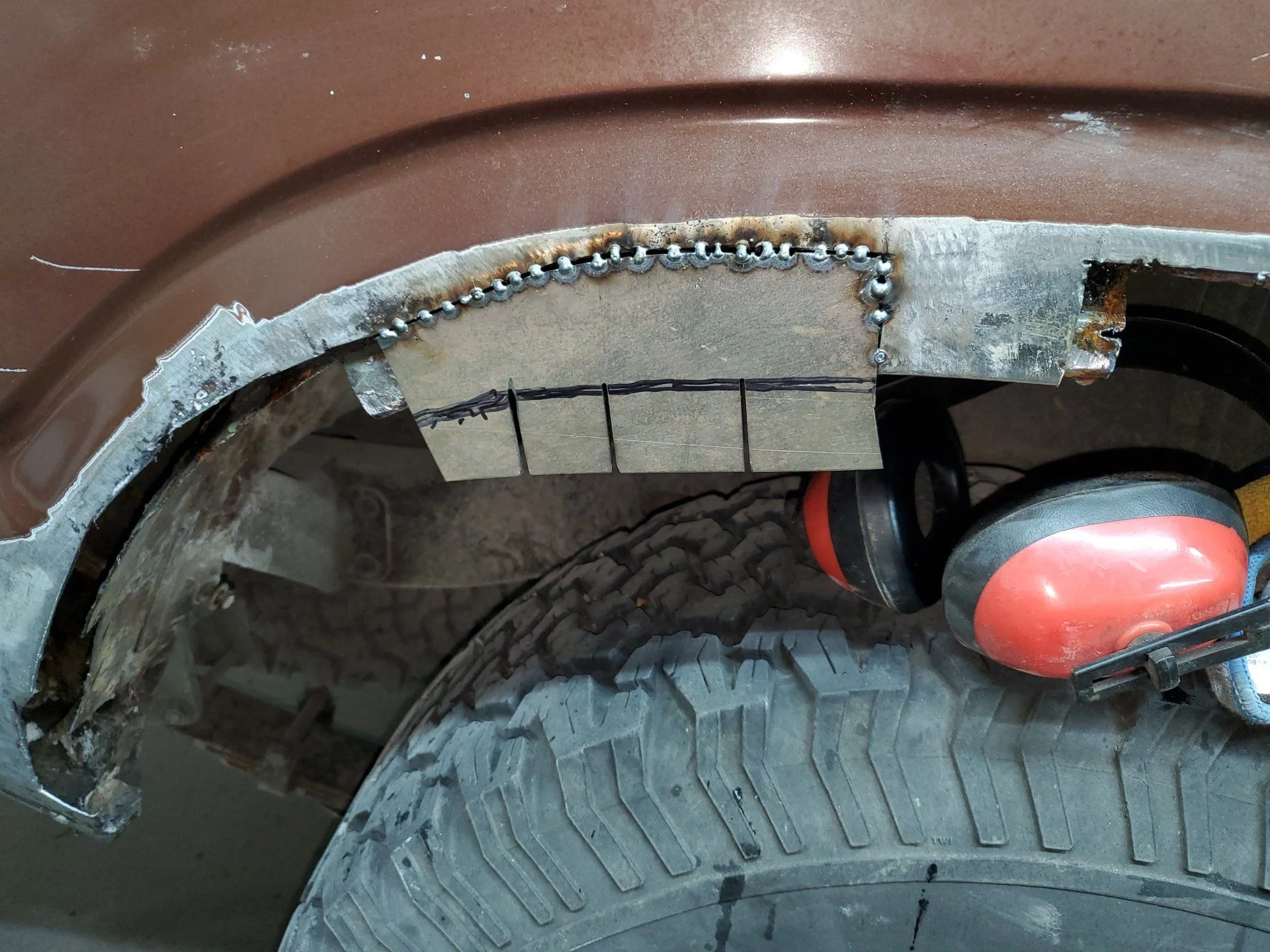

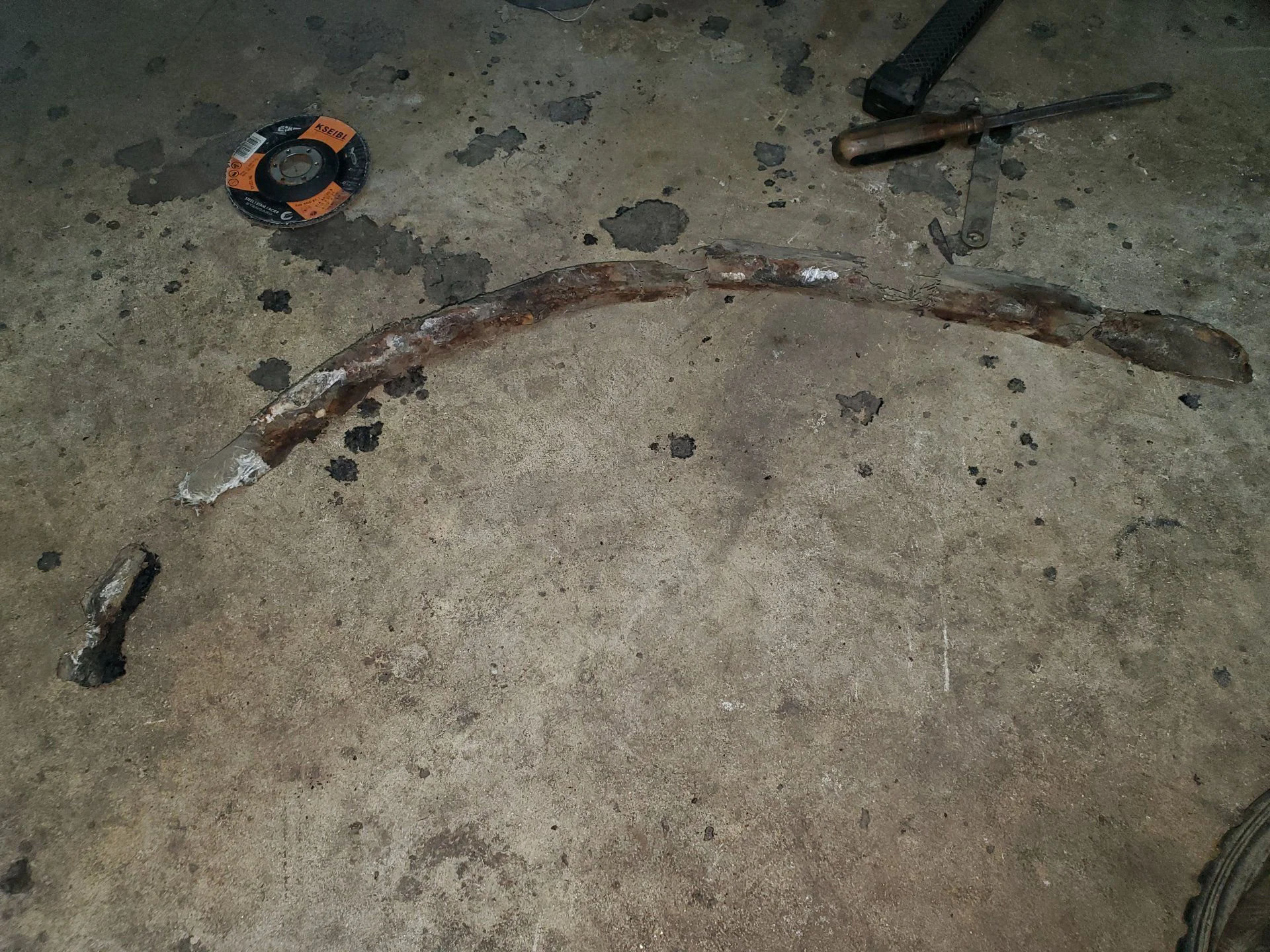

So the fun begins! I got out the flap disk and got that paint off there to see how bad it was, it's not great, but I've seen way worse. Some body shop years ago, I assume, went to fix some rust and they just stuck fiberglass over it all. Then for good measure used Bondo to smooth it out. The fiberglass is still solid, of course, but all the metal it was stuck to has turned to dust.
Anyway, while I had the line I traced it and made sure I could recreate it.
Here's what it looks like without the paint, Bondo and fiberglass
And the fiberglass just popped off, so all it did was hold moisture against the fender

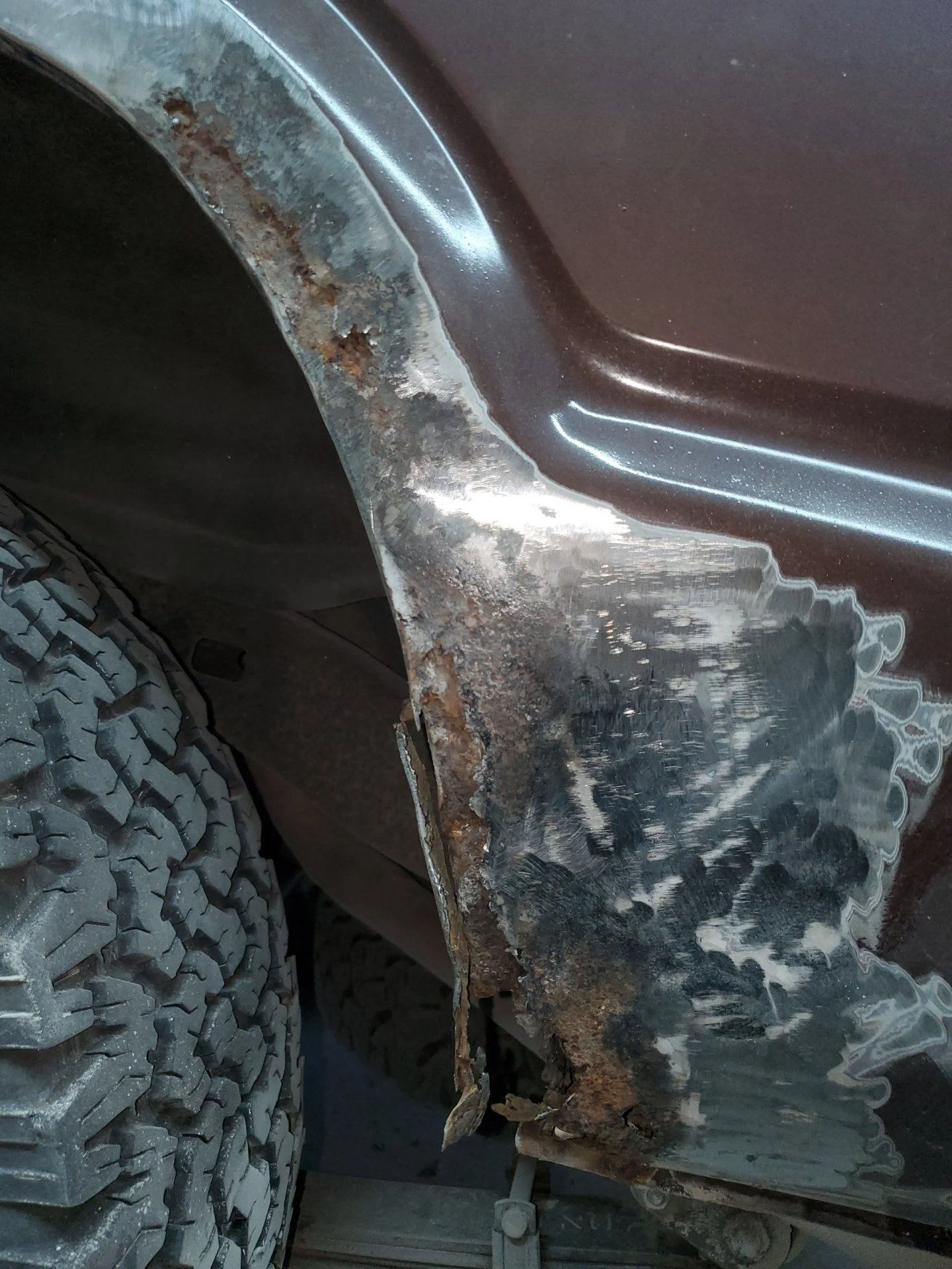

Now I'm cutting away the bad to get in the and see how deep it goes. Honestly, not that bad. Couple days making a few patches and it'll be good as new.
This should be the worst of all the rust, so fingers crossed, I'll be wrapped up with rust repair in a couple weeks. Then I will move onto the front end and remove all the dented stuff.

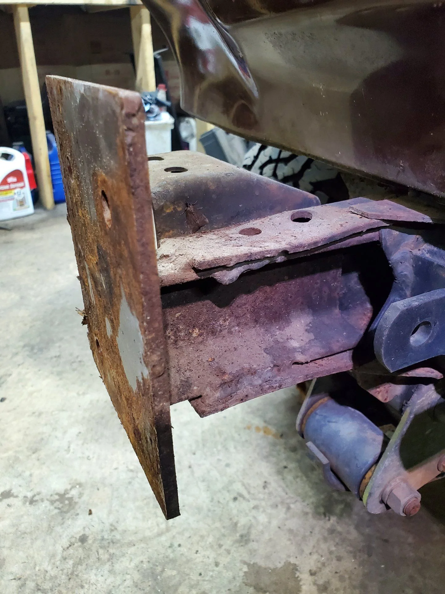

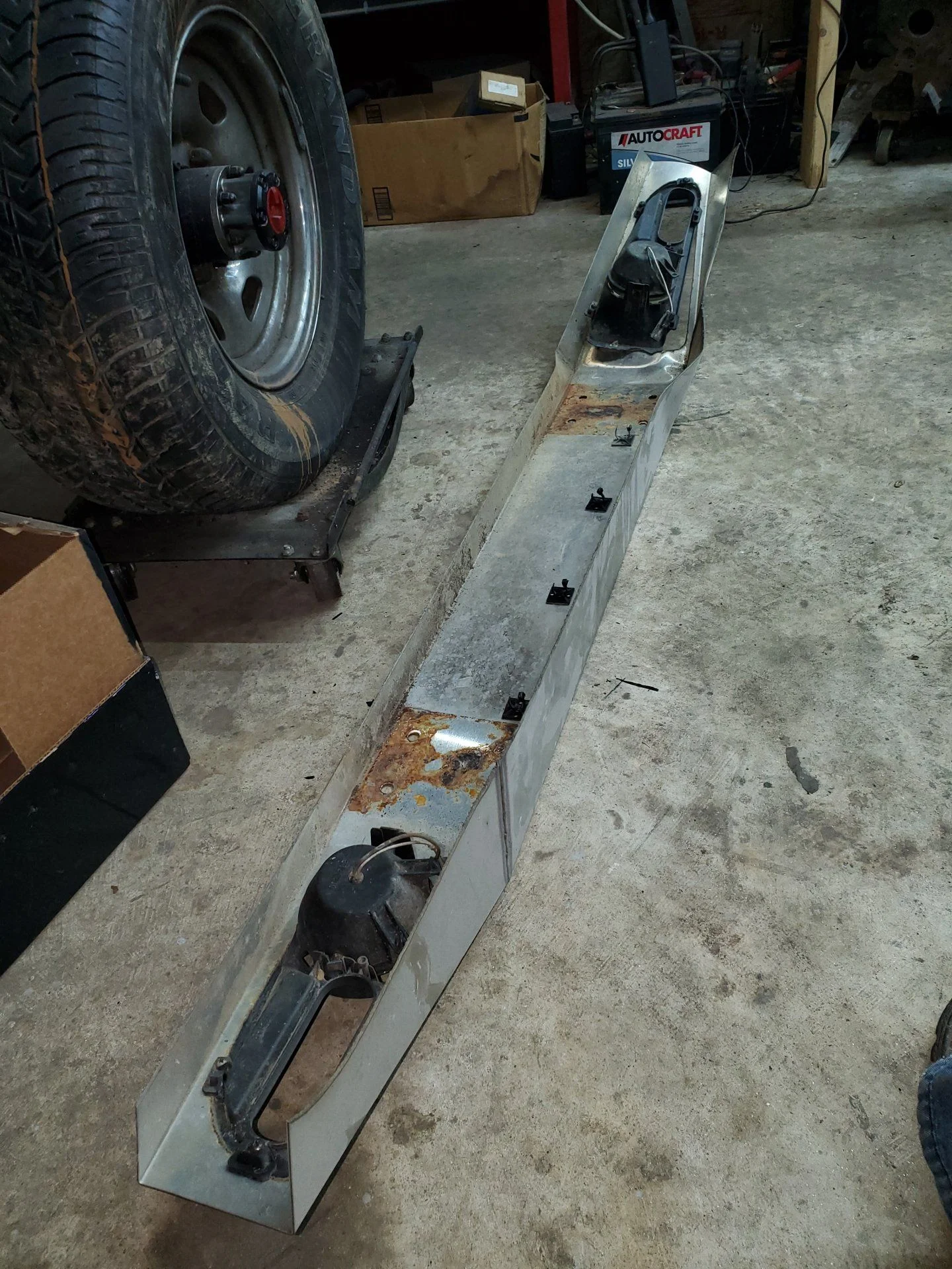

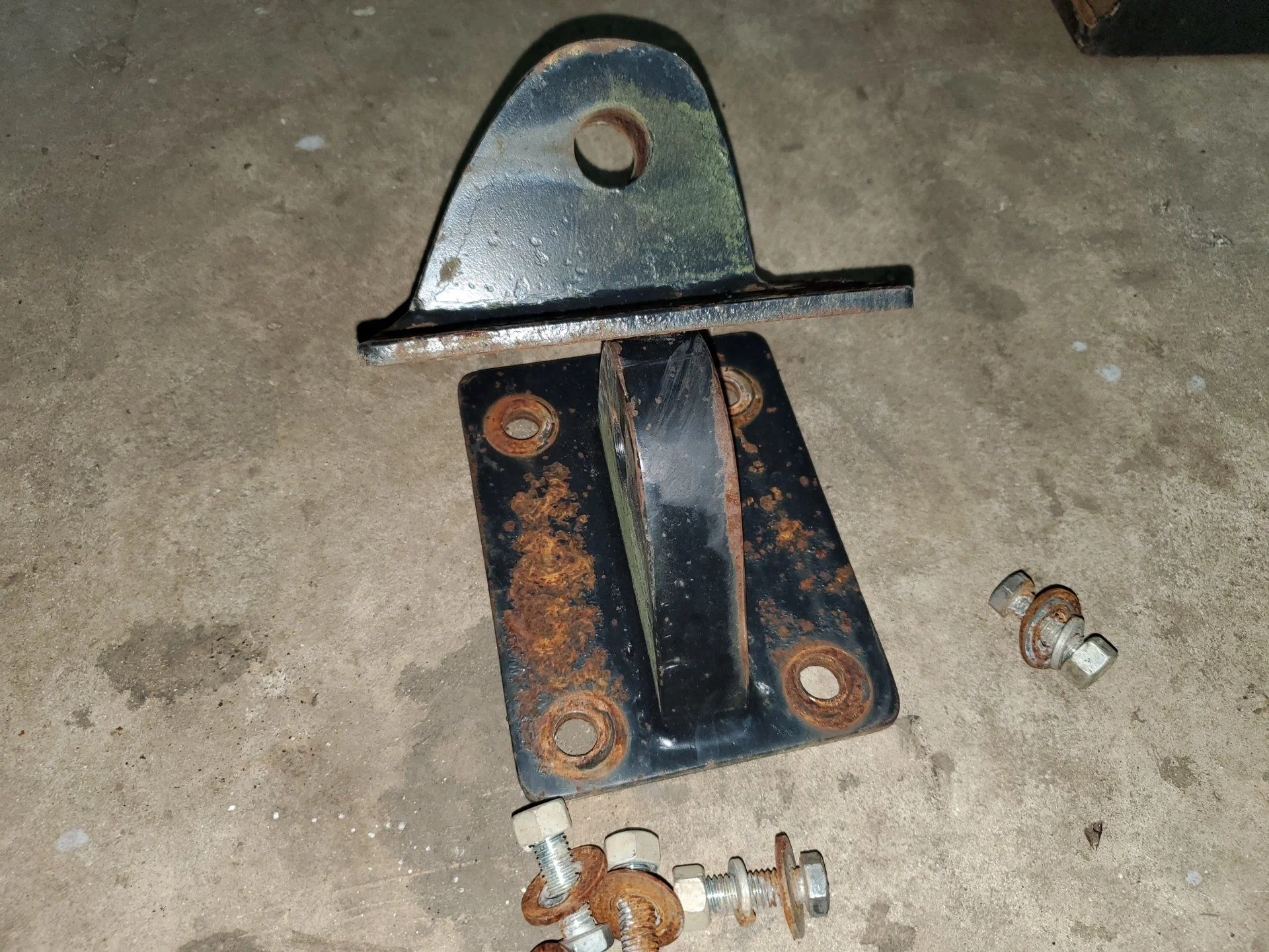

That front bumper, it's a sight to behold in person. It looks like someone took some stainless cover and went it it with a plasma cutter and a welder. Then they fabbed up their own mounts and mounted it all with some cheap home depot bolts, so the recovery point are purely aesthetic. It must have gotten in a fender bender at some point and got a new front passenger fender and this bumper at the same time. The frame mount points are slightly tweaked. Oddly, they used legit ARB fog light assemblies, so they knew about real bumpers.

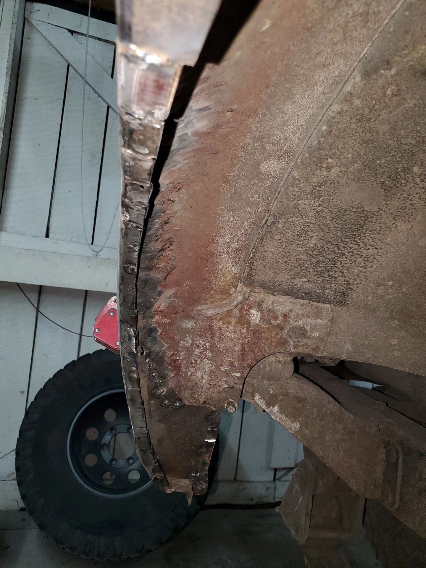

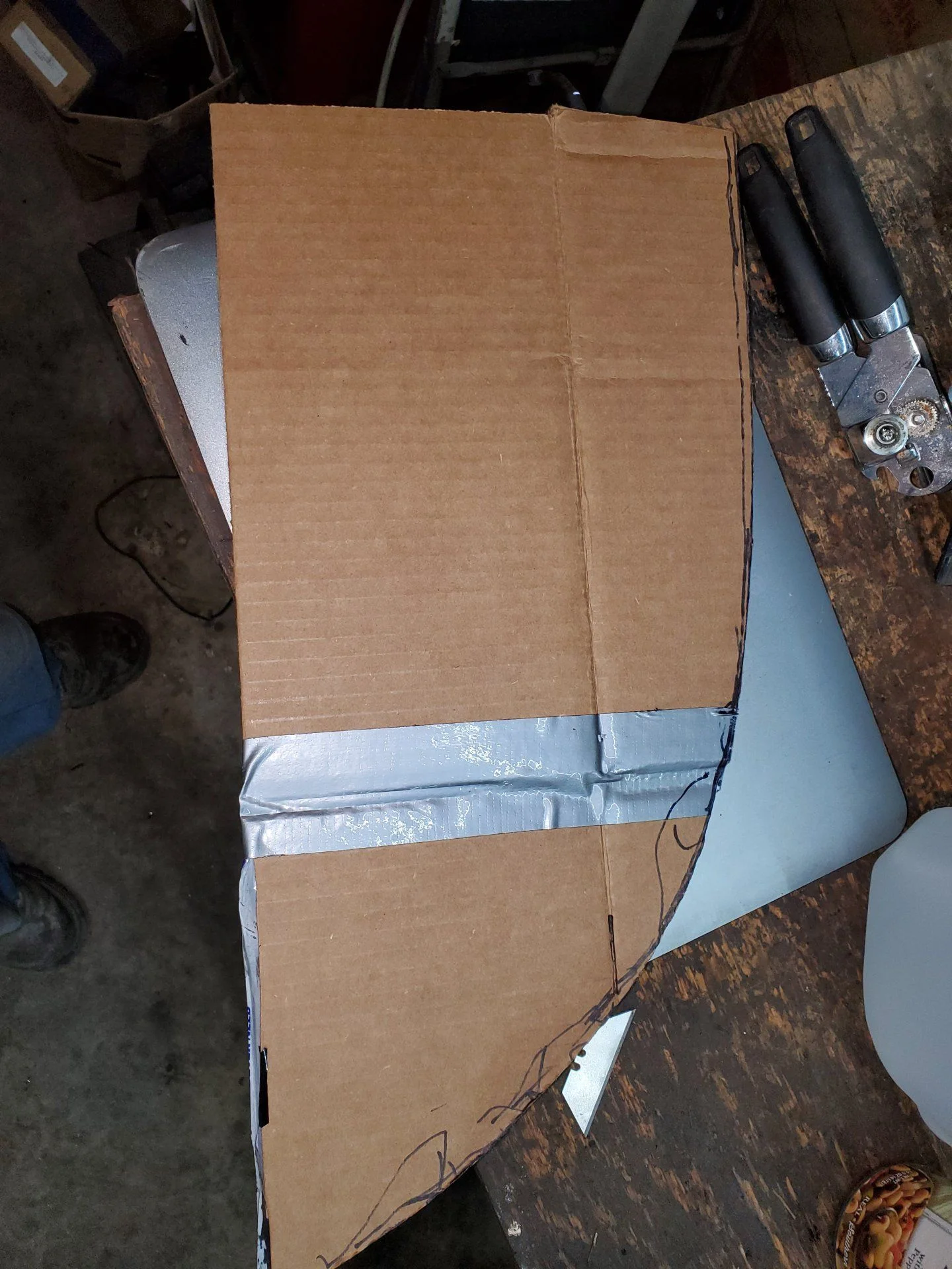

It's just metal, right? Fabricating wheel arches seems hard, especially considering I have no actual training and just figure this sh:t out as I go. I did create a cardboard template so that I can reconstruct the line, but it's the lip that's going to be a biotch. Right now I'm creating patches that are longer than necessary so that I can create the lip later. Then I'll create the inner fender well pieces and weld them in place prior to folding the outer fender lip. I know I need two layer for rigidity, but not sure if this is the "best" way to do it. I figure a bead roller would be best, but if a frog had wings... Any pointers are appreciated here. I've got lots of metal, so I'm fine with starting over if that's what's needed.
You can't see it in this picture, but I have a cardboard template taped up out of the way. I tack in the patch then let the template hang down and draw the line. I know that how I'm doing it will work, but I'm curious if there is a faster/better way in lieu of fancy tools or preformed metal bits.
Well I followed my Screwit philosophy and pressed on. I got one of the wheel arches pretty well back together. I wasn't sure if the method I had in mind would work or not, but I think it's turning out ok. Now just some finish welding and hit it with the flap disk and she's as good as used.

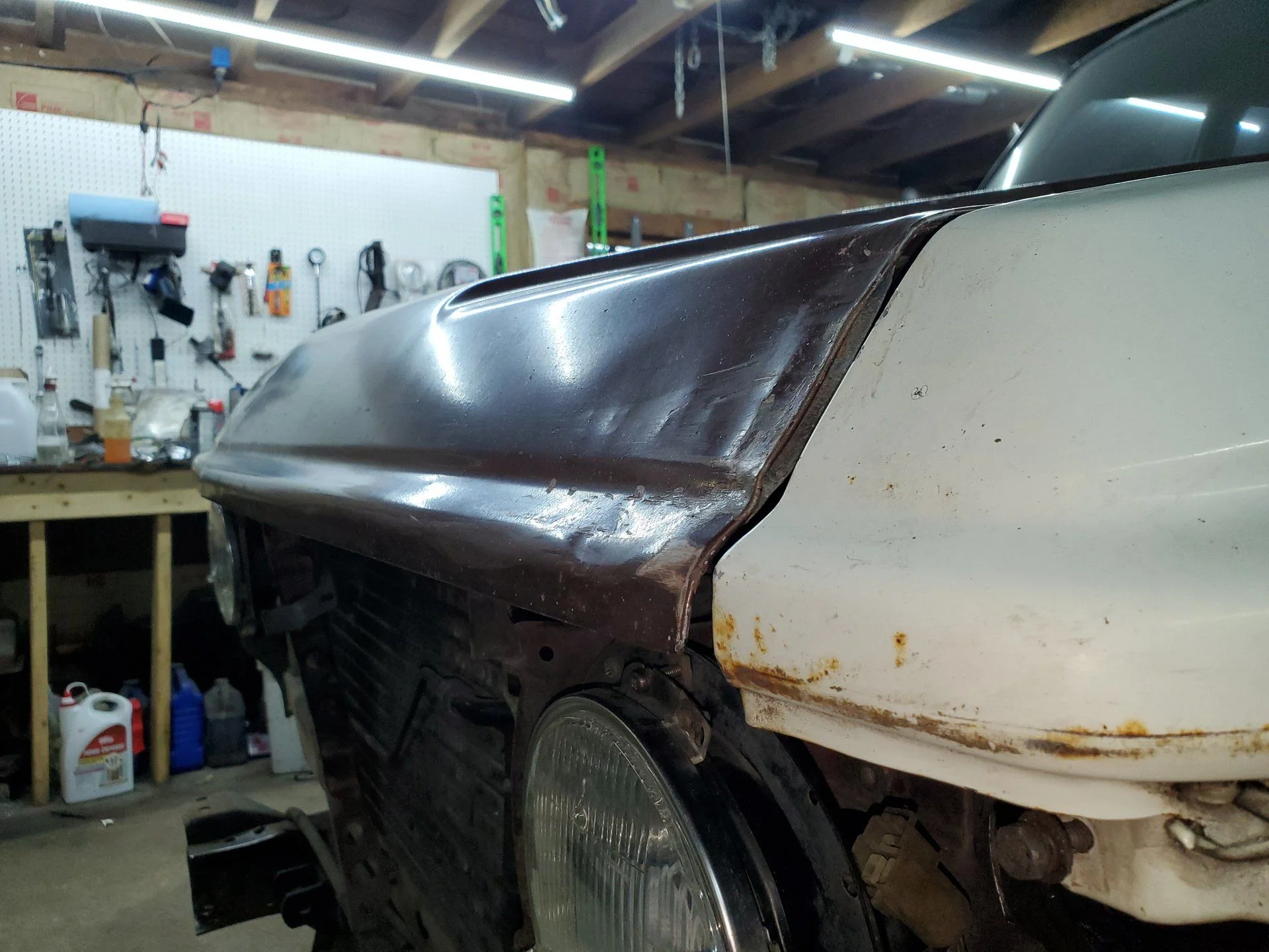

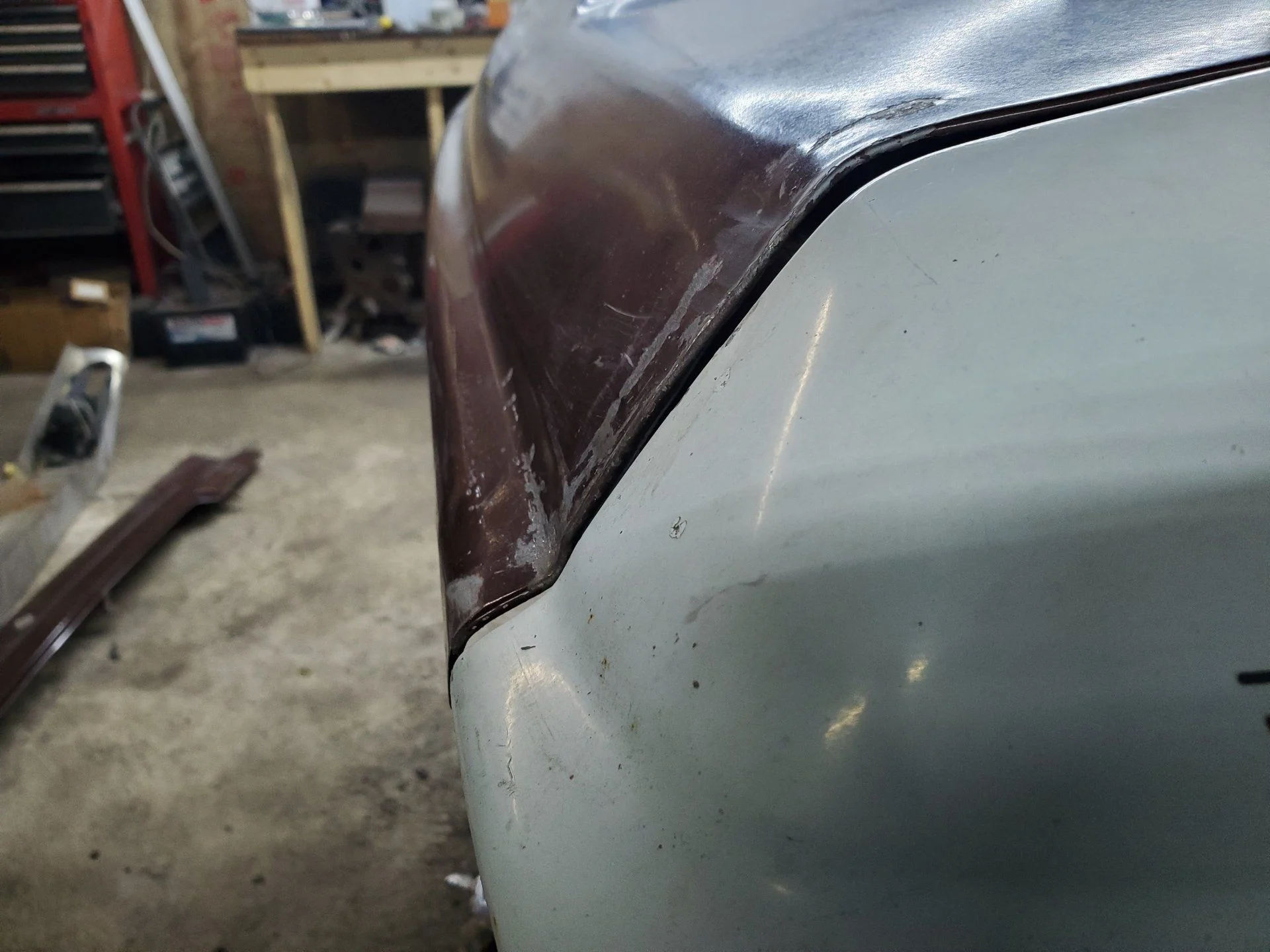

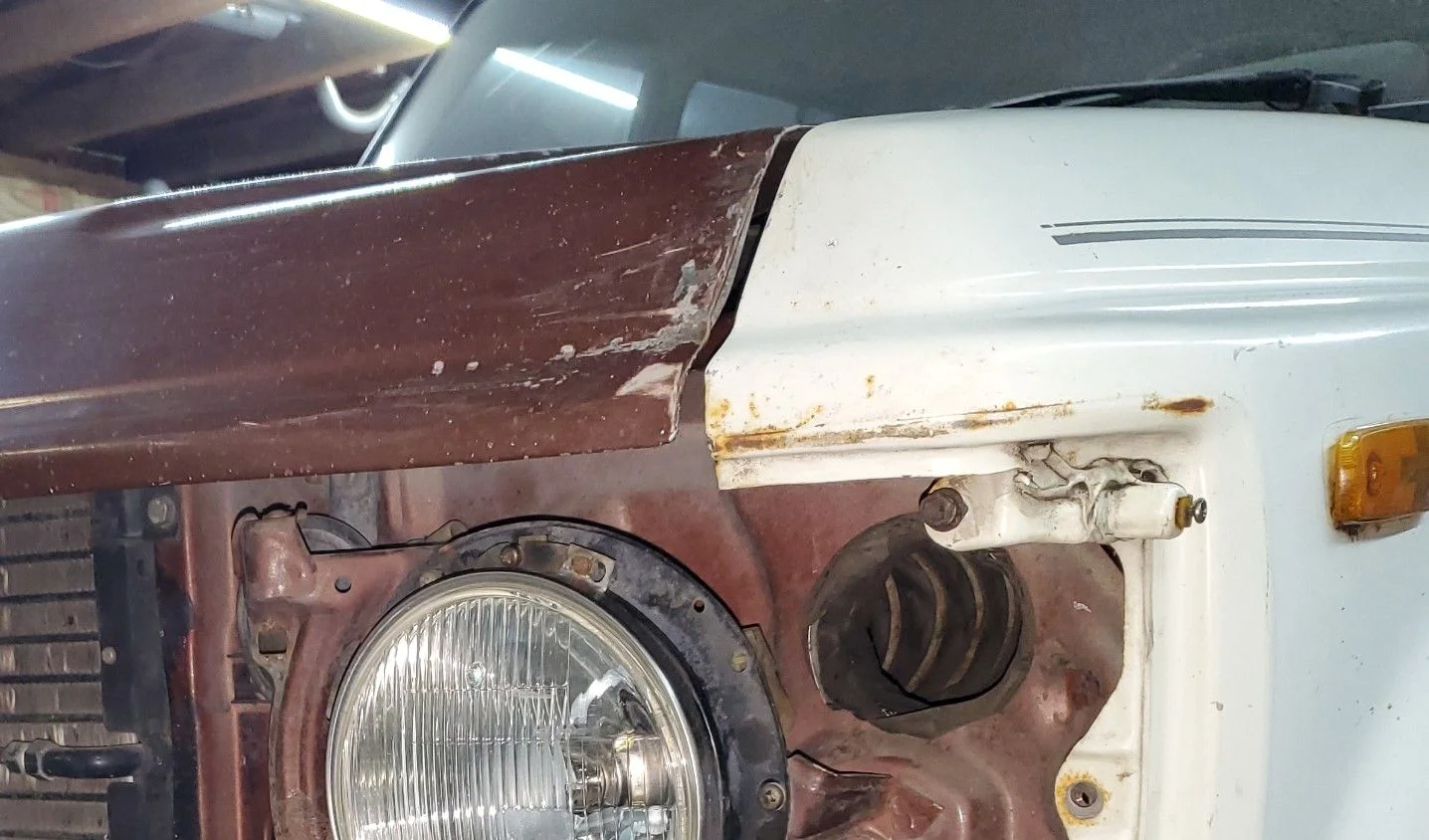

Spent a fair bit of time on the hood last night. The impact curled in the front drivers corner and got it out of whack pretty good. It was pushed back about 1.5 inches, so it took a fair bit of persuasion to get back in decent alignment. I stuck the 62 fender on it for alignment purposes, and then used the passenger front corner to create a template of the contours so I could set the template onto the hood and see how close I was/wasn't. Turns out what I saw as nearly perfect was very much not so. Then I spent another hour or so getting the skin back in close enough shape that I will be able to skim coat it and smooth it all out. It should only need a couple mm's of skim to smooth it all out now.
This was just a bunch of work with the hammer and dollies, after all the work with the big hammers and channel locks to get it close.

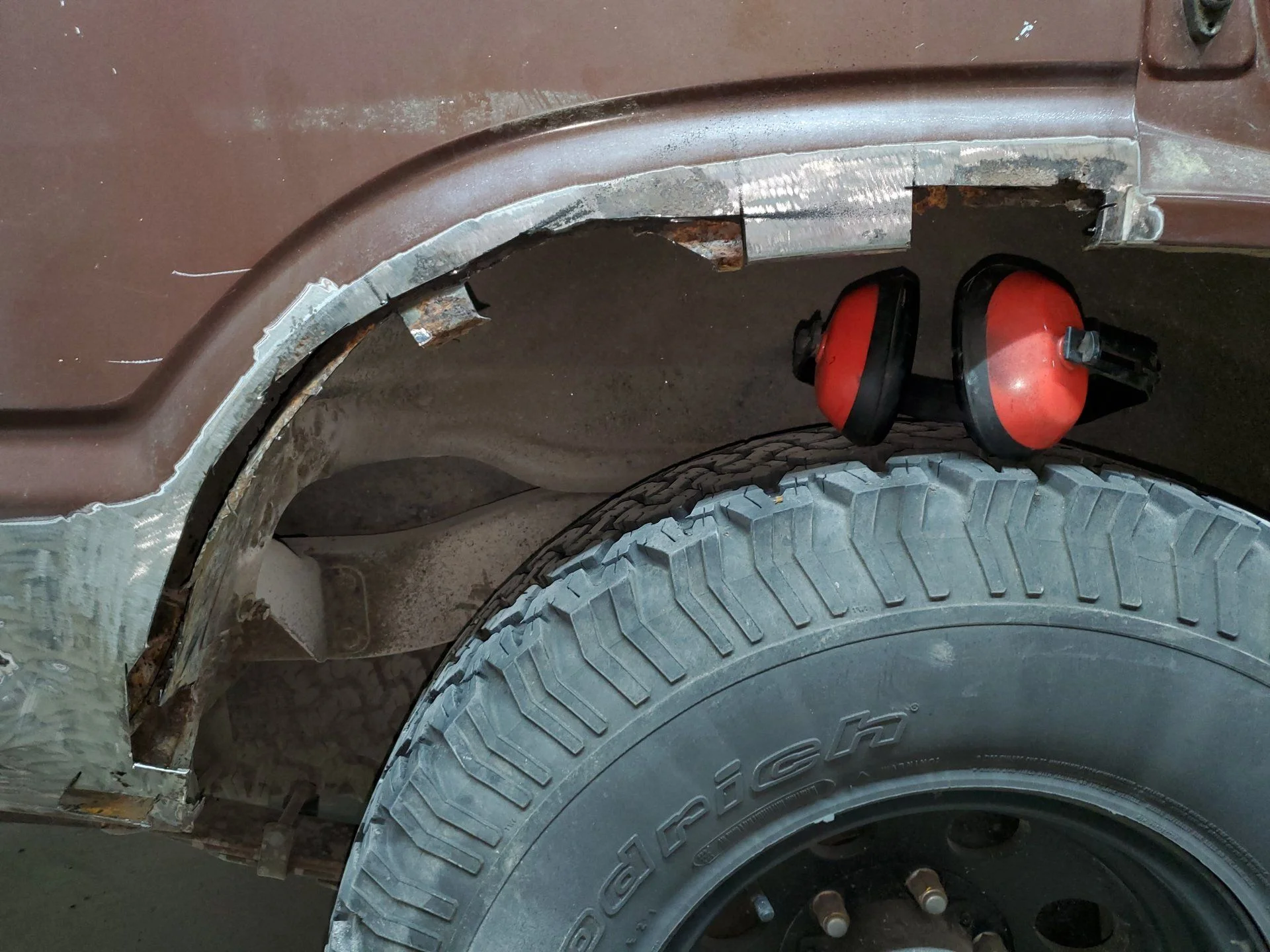

The rear wheel well is coming along. I'm buttoning up the lip and have cut it back. It's very strong with just a single layer of sheet metal. Once I start welding up all the tabs I was surprised at just how rigid it was, pleasantly surprised actually. I will still probably add another layer since I will have some gaps on the inner fender to fill and I'll be welding in there anyway.
Progress is good, and it's so much easier to work on a truck with so little rust.
