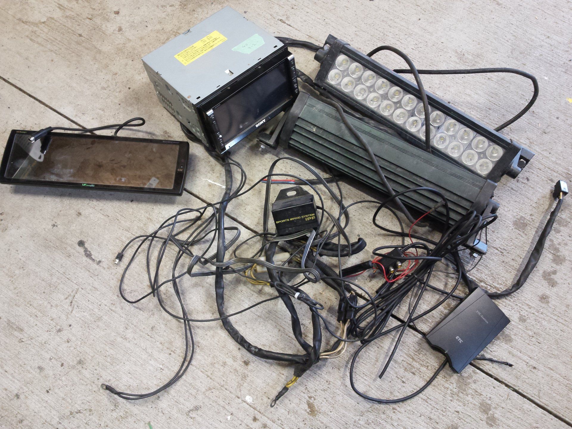

Pulled out some more janky Japanese wiring. There was some sort of card reader that was probably for a parking garage, some wiring for the second backup camera that fed to the oversized rear view mirror/LCD screen thing, some of the other stuff that fed the TV unit, and a lighting switch. Most of it's garbage, but I think I'll hang onto the LCD screen thing just in case, and definitely hanging onto the two LED bars for future somewhere. Still have a GPS antenna to take out.

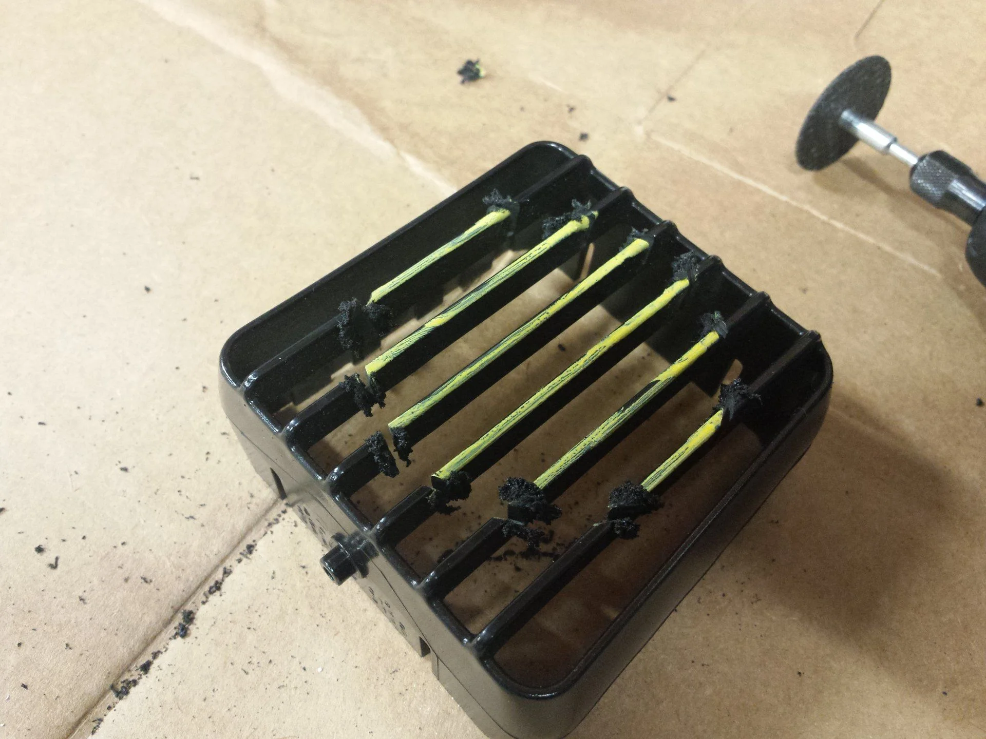

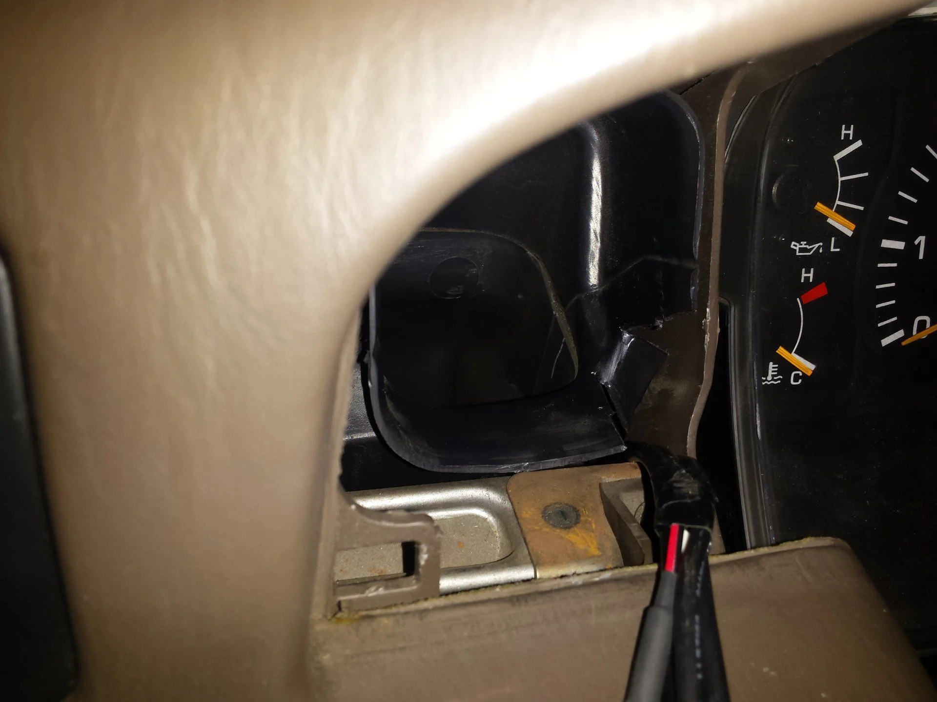

I took some inspiration from the way @70sguy put his gauges in. Took out the heater vent, removed the adjustable louvers from the back, then I marked out a cutting template. He said he used a drill press EXTREMELY slowly with a hole saw, but I ended up using a dremel to cut it (I felt safer that way), then cleaned up the cut edges with a knife. The gauge was fitting very snug, and I almost just used pressure to hold it there, but ended up using the mounting bracket on the back to help hold it in there solid. I also put on the sun shade because I think it looks neat.
I notched both the vent housing and the vent in the dash in one corner to allow the wires to get through. Then I wrapped the wires in some pipe insulation so it plugs the hole and protects the wiring.

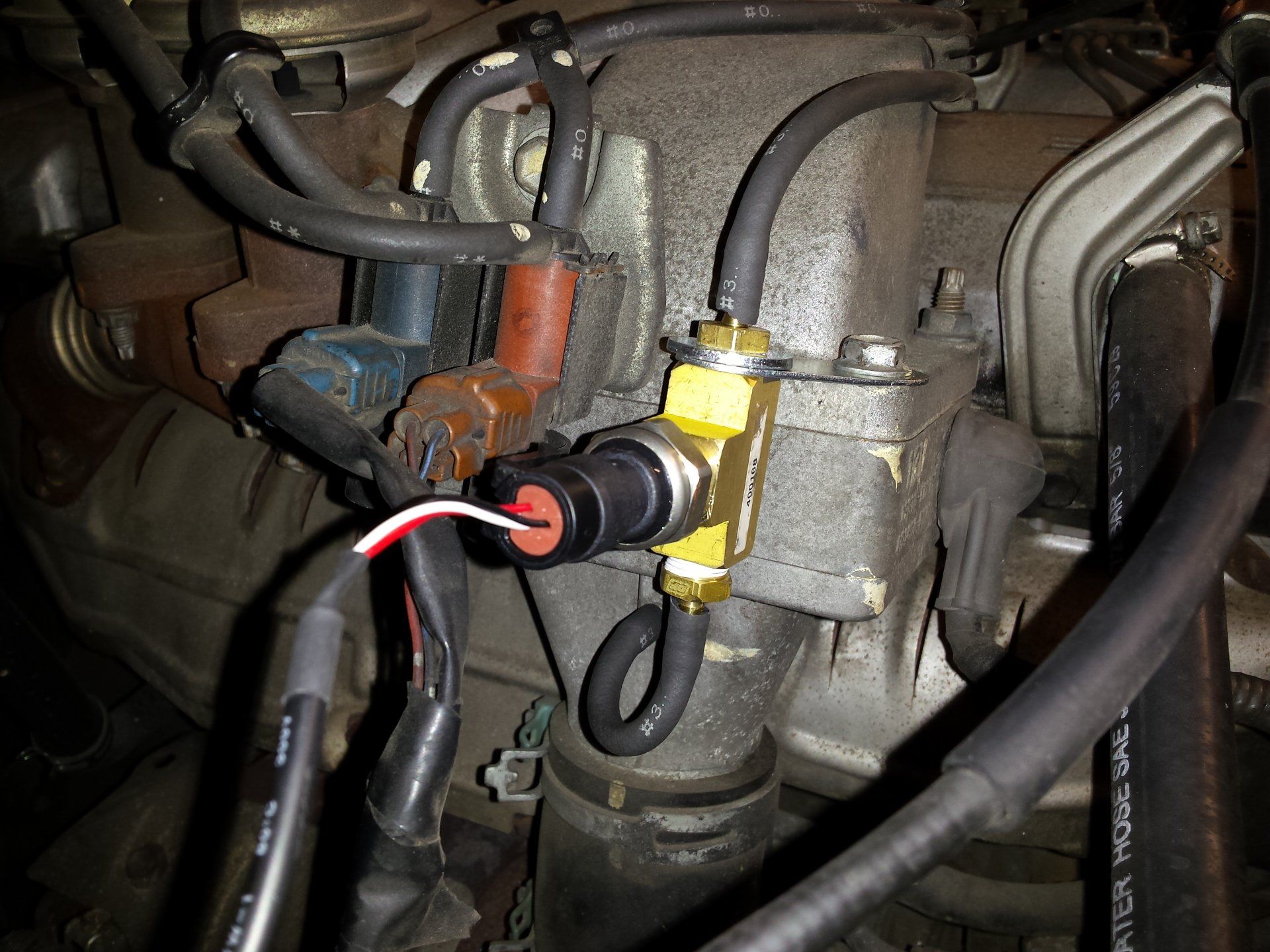

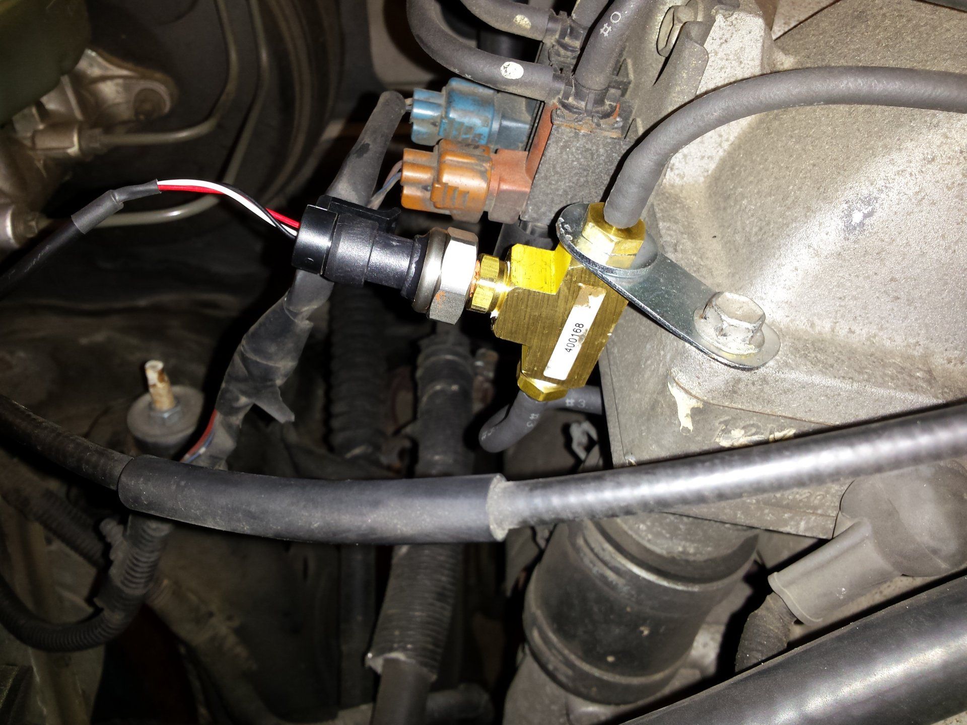

Got the boost sensor installed.
First test drive shows a max of about 10psi normally, but I did manage to hit 11 for a split second up around 3500+ rpm while doing a really hard pull and leaving it in 2nd gear.

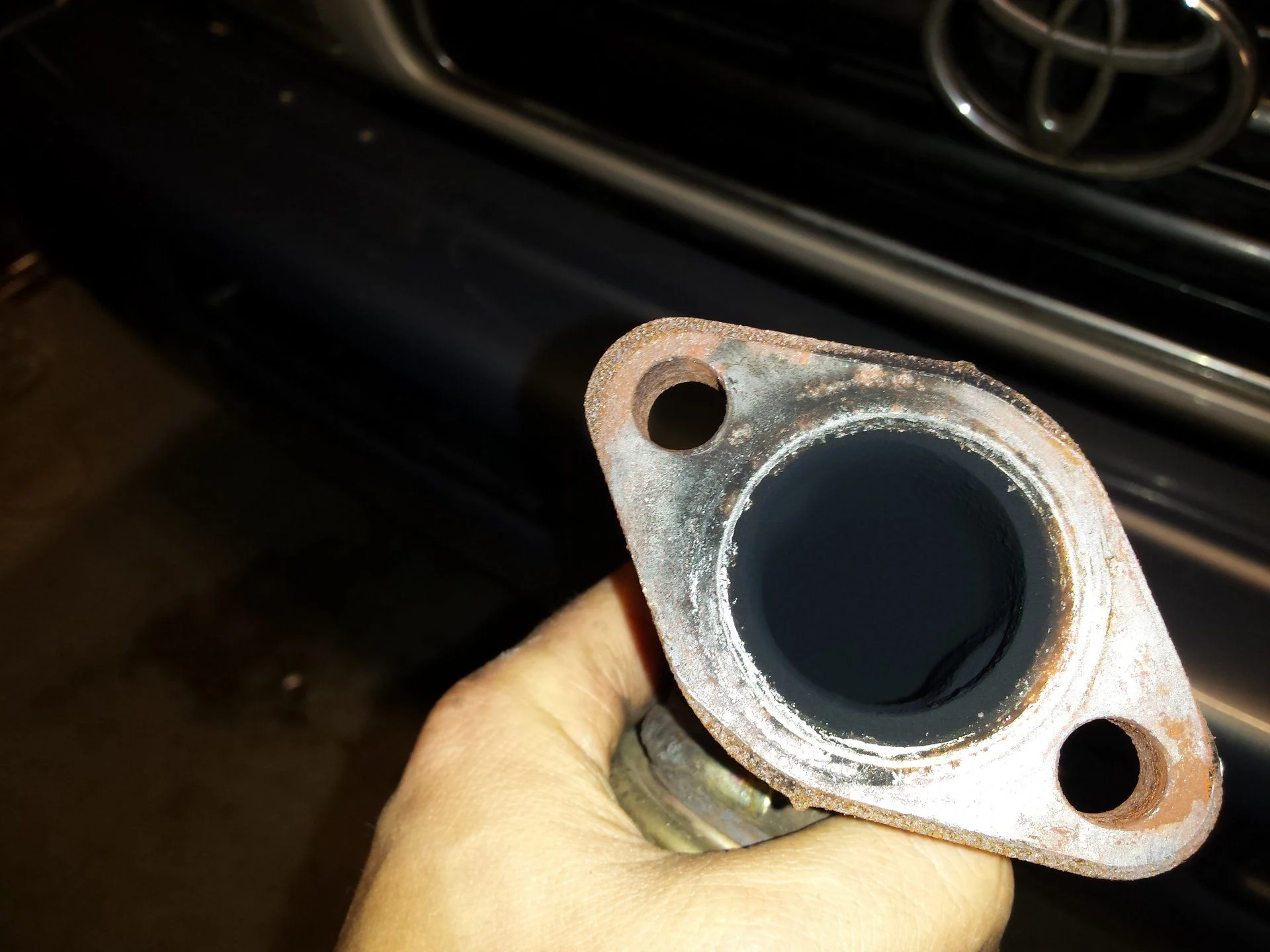

See the black on the bottom of the top stud?
full
The connecting face of the EGR pipe, all black on the left side. Looks like a leak to me.
full
