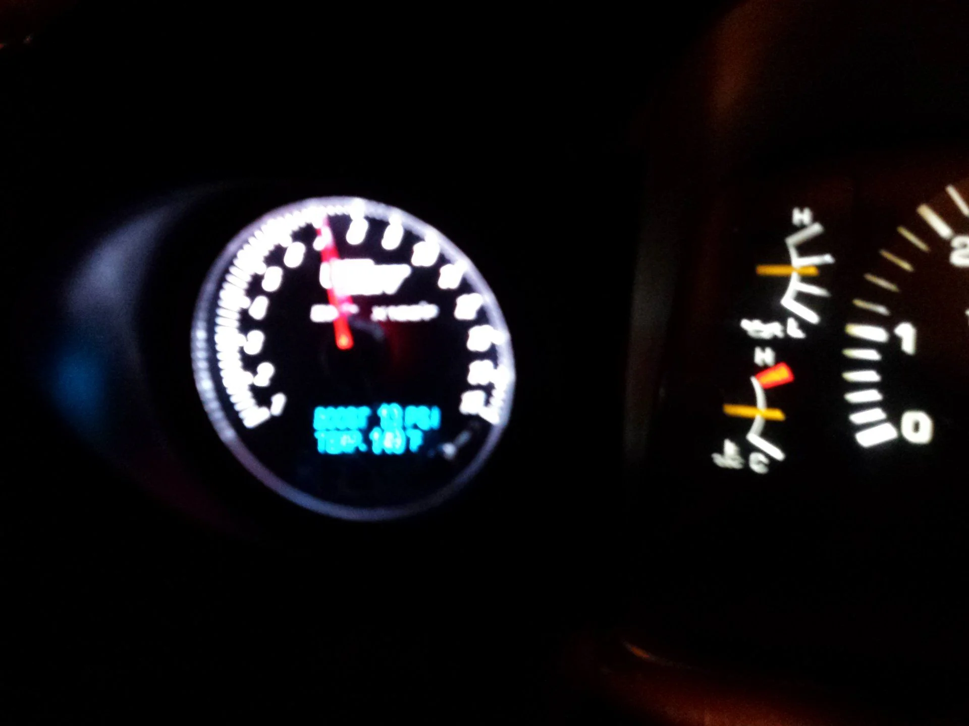

That shaky, blurry image is supposed to show 13PSI of boost, but it's tough to take a picture at night while in a heavy ass vehicle bouncing along on an Alberta highway at -25C. Yeah, I got myself one of these and installed it.
full

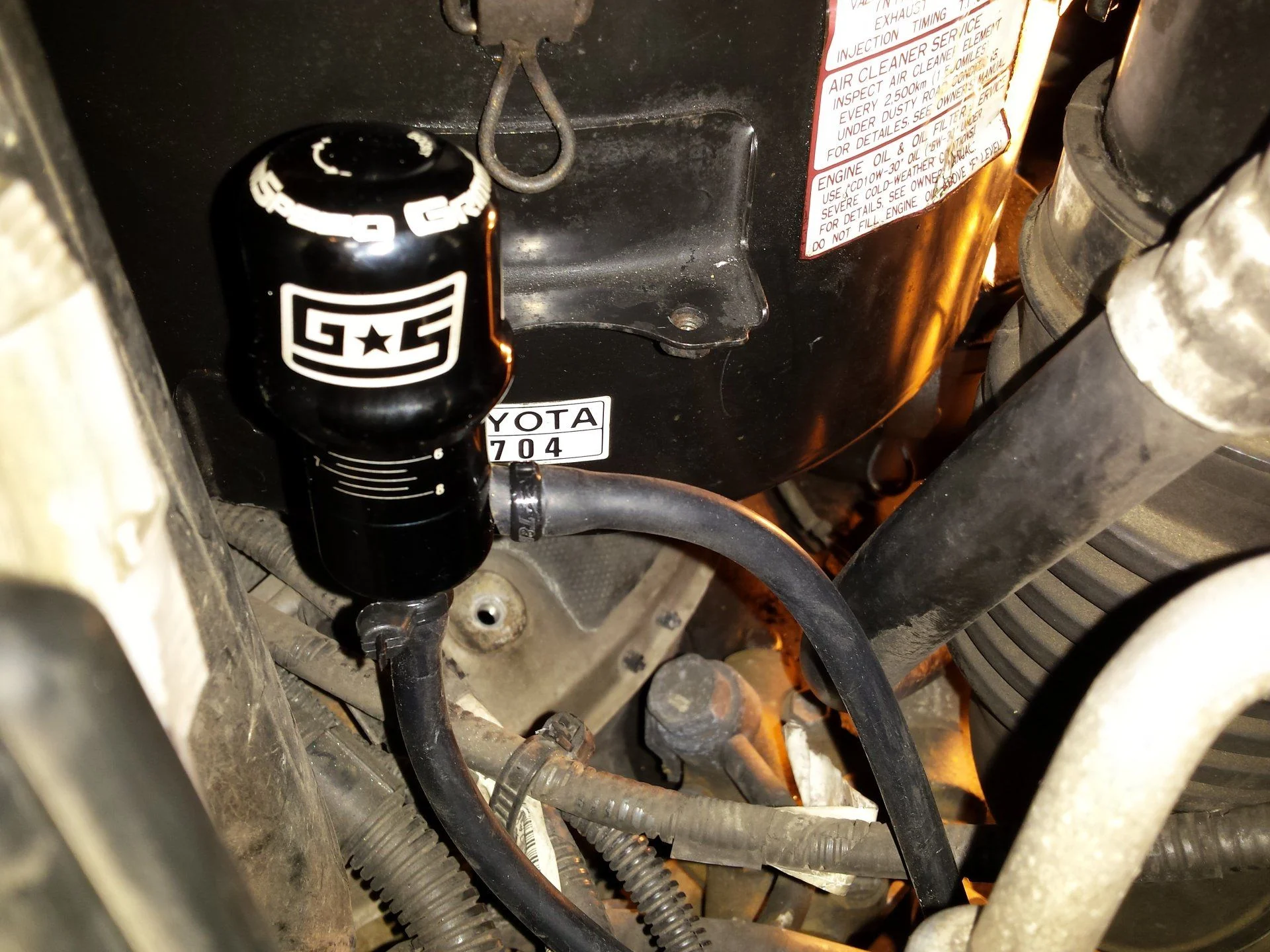

GrimmSpeed Universal Manual Boost Controller. Build quality seemed good, nobody seemed to have any complaints when I checked around online, price was reasonable and I thought the name of the company was cool. After a really boring amount of time starting and stopping down a highway in the dark, it's at 13PSI, EGTs are at around 750f in 3rd at 100kph, but I don't necessarily trust that today because of the fact that it is -25c out there right now. I'll adjust and play with fuel and stuff slowly during more regular weather.

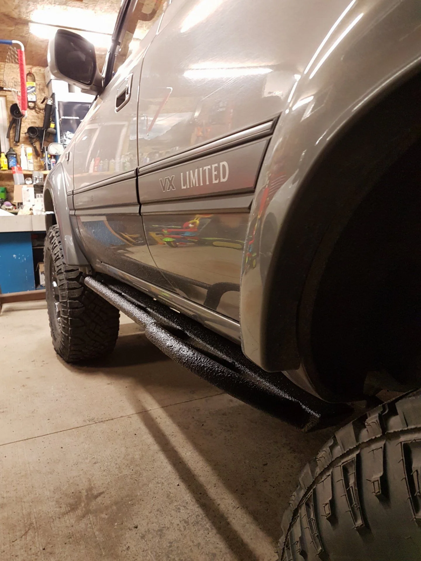

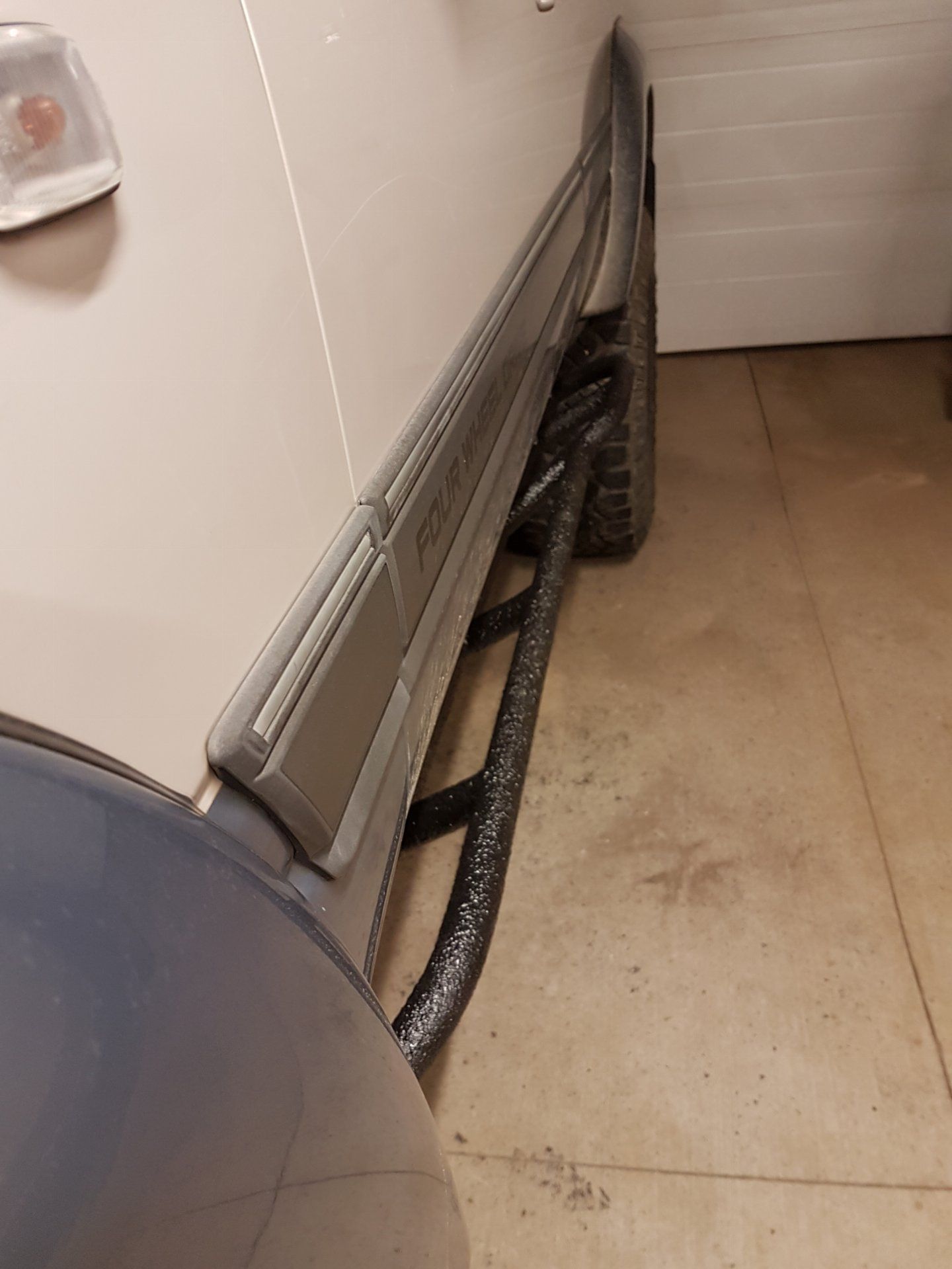

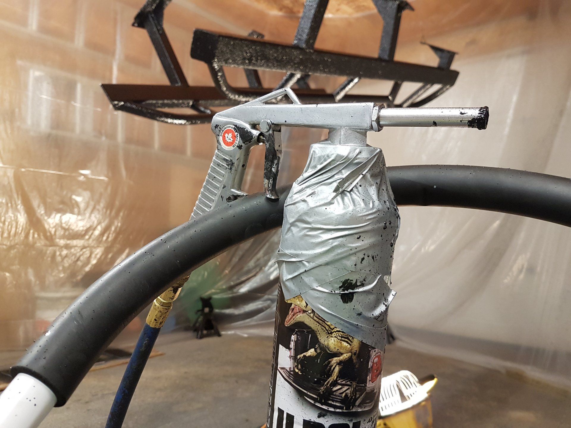

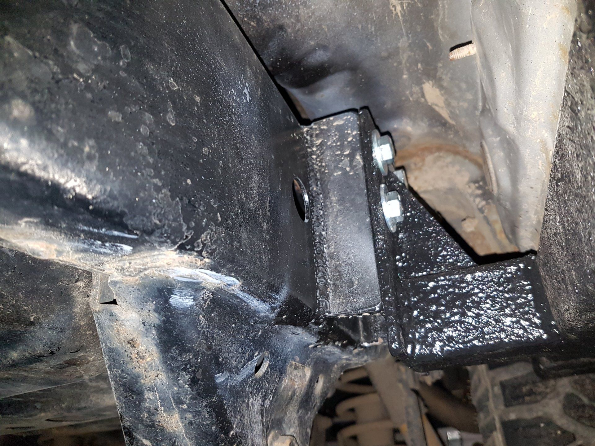

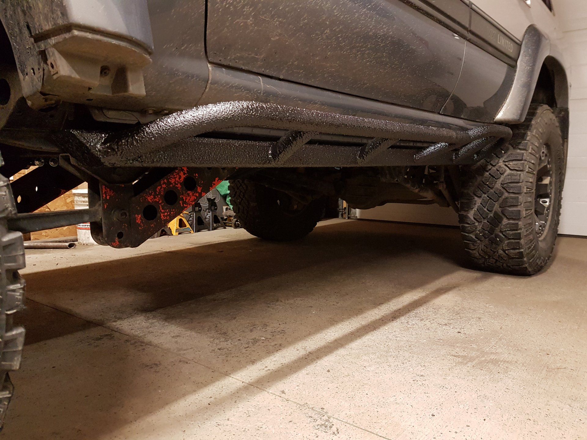

After a very long process, drawn out with help from one of the busiest holiday seasons we've ever gone through, sliders are done.
Made 'em out of a 2x3 main bar, with 1-1/2" outer tubes, 2x2 support brackets and 1/4" plate for the gussets and mounting brackets. Ended up welding them myself, 'cause I figured "why the hell not, I like to learn stuff and what's the worst that could really happen". Some welds ended up better than others as I progressed, but I think they'll be more than fine. Rearmost support bracket is bolted to a piece of 4" C-Channel that I got welded to the frame (didn't trust myself with that one). Received some free sandblasting thanks to a customer contact at work, blew clean, degreased, primer'd, scuffed and then shot with a box of leftover Raptor Liner inside a makeshift paint booth in the garage. Last time we used the Raptor Liner, we had the Shutz gun that it comes with, but figured throwing it out and buying another one for $25 was easier than cleaning it. The new gun I was able to find and buy from Cambodian Tire has a larger threaded bit on it, so it didn't fit the bottles. Duct tape worked fine. I did 2 coats of Raptor at 50 psi, then did a 3rd coat at around 35psi from a much larger distance to give it a really rough final texture, in the vain hopes it might help with foot traction a bit.
But I also think the rough coating looks cooler. :princess:
They pass the "jump on it like a madman" test.

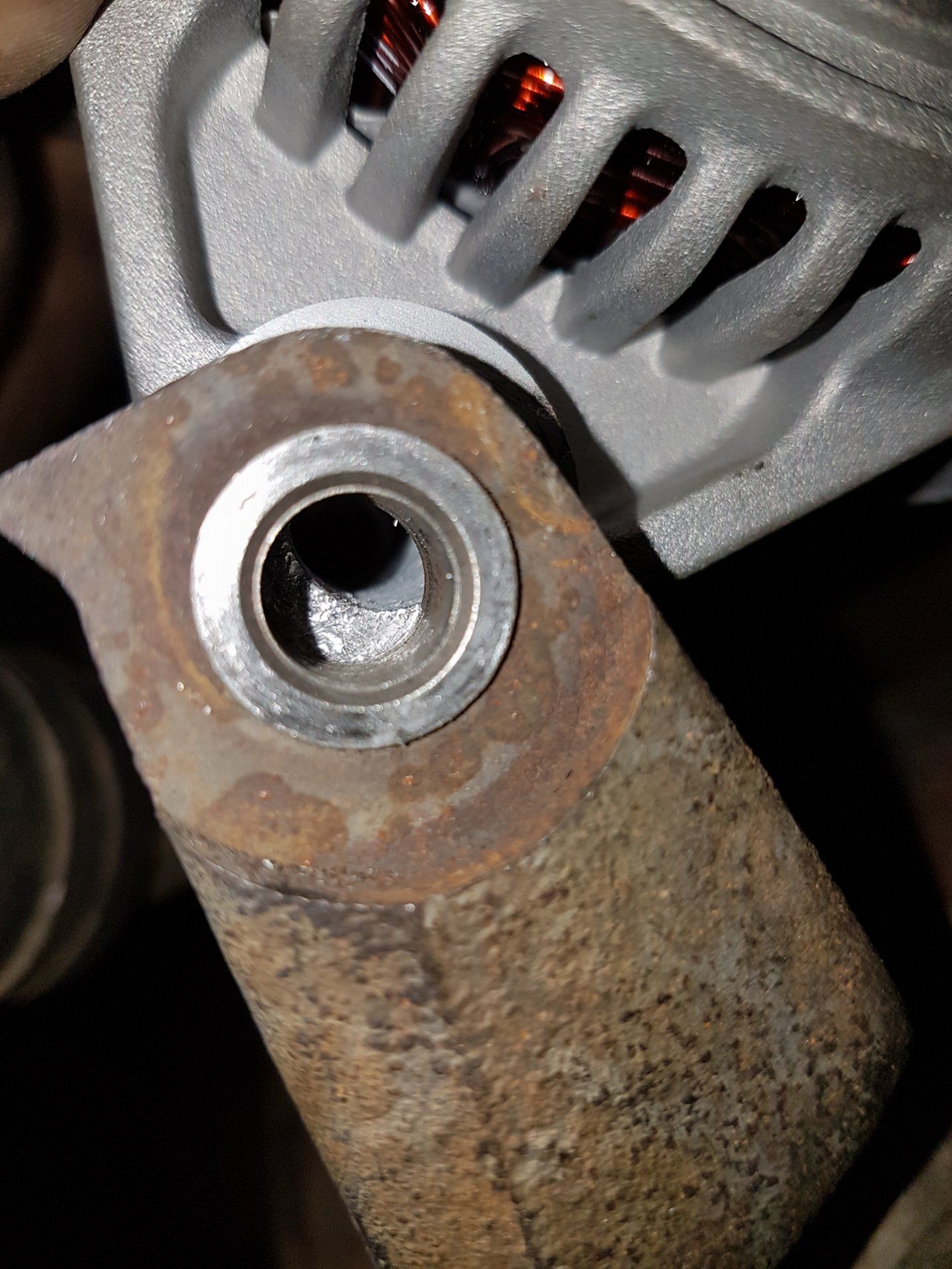

During "installation", I'm struggling to get the bolts in far too long, trying the top bolt first, bottom bolt first, top one loose, top one tight, all to no avail. I decide to put my phone camera up there to see what the issue is:
full
No matter where on the adjustable bracket the top is sitting, this is what the bottom looks like. Just not quite there.
The replacement unit that i was given is a 27060-17171, and all indications online say it's for my truck, but a slightly higher amperage unit; 110A instead of the 100A 27060-17181 Denso unit that was in it.
So, why is there nearly 1/4" difference here? Why is this simple repair becoming so damn frustrating?

There are 2 different alternators on these, the difference physically is the distance center to center between top and bottom mounts which is about 5mm different. Only way to check is to have both alternators on the bench and measure them.
You could try removing the top bolt and them put the lower one in. If you do have the smaller alt and should have the big one the upper adjuster will need to be modified as it has 2 bolts holding it to the engine and doesn't move up and down.

Bottom bolt first, top bolt first, didn't make a difference.
What sense does it make to have two different alternators that are so close to being the same? I would think it makes more sense to have slightly different brackets on vehicles, but use the same alt. So much for that legendary Toyota engineering prowess.
I'll see whats available, but i guess if i pull the top arc bracket off and ream the holes a bit i can probably make this unit work.
Thanks @KiwiDan80 for getting me going in the right direction, 5mm difference just like you said. Here's what I've learned so far.

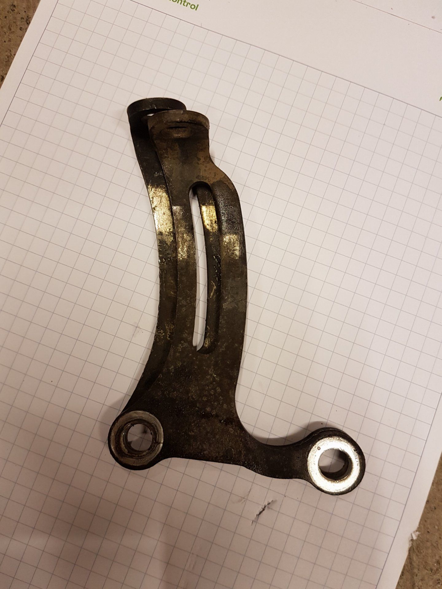

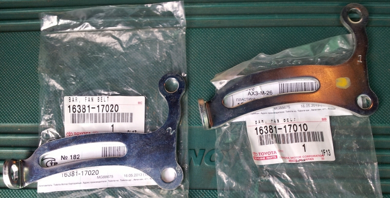

There are two different upper brackets that were offered for these trucks to accommodate the different size housings on the alternator, stamped either #1 being the 80A, and #2 being the 100A. The cruiser shop had one of those brackets available, stamped #1. When I get home tonight I'll be pulling the A/C compressor off so I can get at the bolts, and hopefully I have a #2 bracket, which will mean I can put this other more readily available alternator on instead.
27060-17181 - 100amp alternator
27060-17171 - more common 80amp alternator
16381-17020 - the #2 100amp bracket
16381-17010 - the #1 80amp bracket
Here's a look at the different brackets side by side from some Russian website where someone has apparently gone through this already.
This also means that if someone really wants an extra 20amps out of their diesel 80, but still stick with OEM Toyota parts, they can order the bracket for like $5, and then try to find an alternator for the price of roughly one mortgage payment.

Here's a photo of the differences in the brackets for those who are interested.
