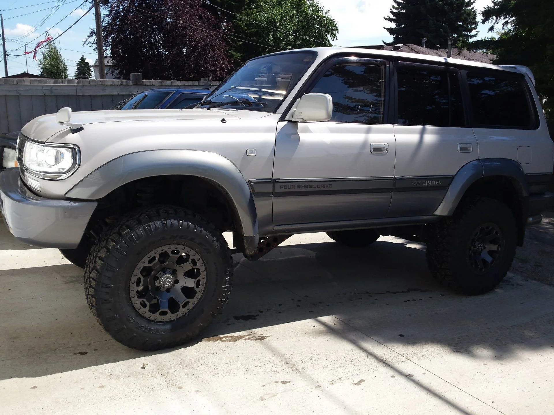

New boots are on!
Rims are Black Rhino Warlords in 17x9, 6x139.7, -12mm offset, matte gunmetal and wrapped in 315/70r17 Wrangler Duratracs. Wheels have a 112mm centerbore, so a 112-106.1mm centering ring was provided by the manufacturer just for this application. You can see how they stick out just about perfectly in the picture, the edge of the tire lines up just right with the top of the flare. The old snow tires were mounted on the Mickey Thompson wheels that had a -24mm offset, so they stuck out about a half inch further. I kinda like this look a bit more I think. Should help keep the mud/rocks in check as well this way. These are quite a bit stiffer than the snows were, feel the road a lot more, but handling is nicer.

Nice new rims!

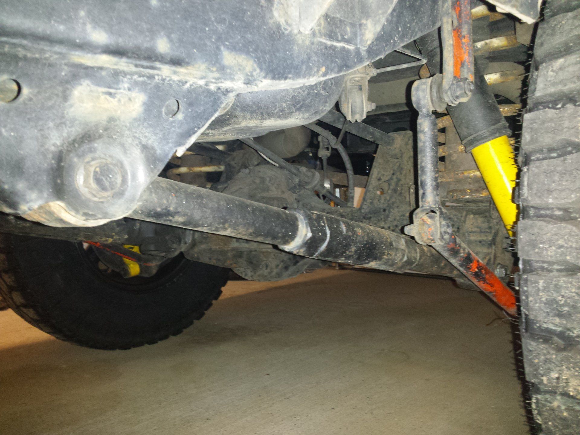

I notice you have some kind of drop brackets for the front control arms. The look huge! Any chance you could take a picture?

Sure. Here's the pics. The front bracket has the control arm sitting in the 4" drop position, and the bottom hole measures 6". This has led me to believe that I have a 4" lift installed on the vehicle, but I don't know for sure, because I don't know what the stock height of everything is. It's beefy, but it looks like it will kill my breakover angle, and I will probably end up dragging on them quite a bit. You can see the big swaybar drop extensions in the picture too.
I have no clue whatsoever what brand of lift this is. The brackets are a mystery to me, the coils have no names or numbers on them that I've been able to find yet, and the shocks were ProComp in the front, and Ranchos in the rear.

As part of the lift that was pre-installed, the rears have adjustable lower control arms already in there. I haven't touched them, or even checked what the angles are yet. I'll get around to more investigation during the winter maybe.

Those drop brackets are huge! and indeed will catch some rocks when you go wheeling...
