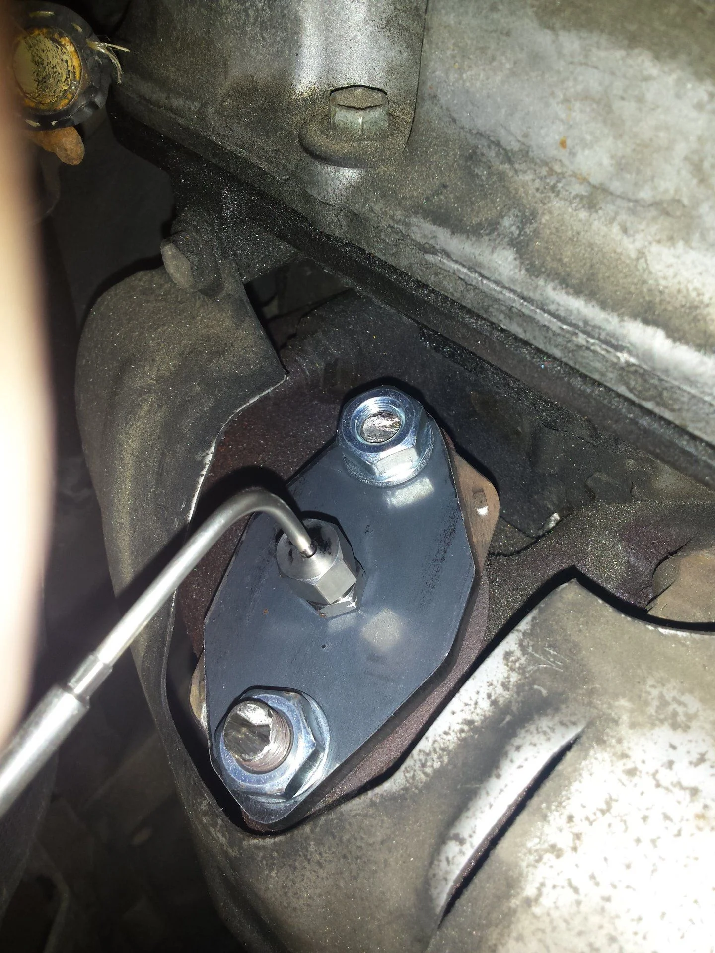

I'd like to, sure would mean a lot less work for now, but the top of the broken stud is pretty twisted and mangled. Is a tough spot to get to so i don't have room to spin my die to clean the threads with that. I could try cutting just a sliver off the top with the dremel and then try a new nut before taking everything apart. Last thing i need is more studs breaking while I'm taking off the manifold.
How about hitting the studs with a little heat and penetrating oil a couple times and then trying to remove the studs. Then you could just use bolts in the threaded holes the studs used to be in. If it was me I'd just try and fix/use those two holes or studs that are there vs. dealing with all the studs & nuts that hold the exhaust manifold on. If you don't have one it might be worth it to buy or borrow a proper stud remover to try and make the job easier.
Predictably, I suppose, I ended up giving up pretty quick.

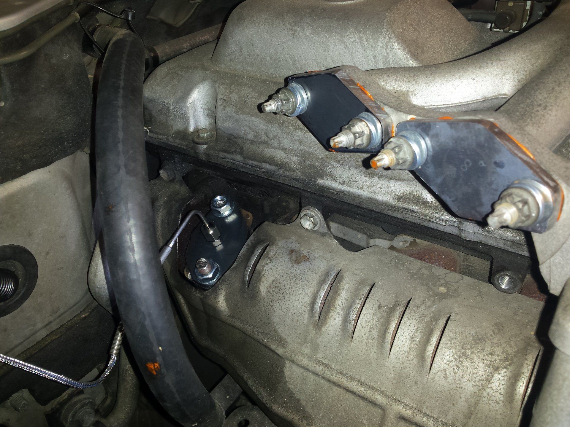

In a decision to avoid a longer period of work at current point in time, I cut the mangled bits of stud off with the dremel, then tapered/cleaned up the last thread and bought some nuts. I'm trying to do all my work on the vehicle after kids are fully in bed, and before having to go to sleep myself due to the responsible requirement of being active part of the work force in the morning.
Those studs are a M10-1.25 if anyone else doing this is wondering.

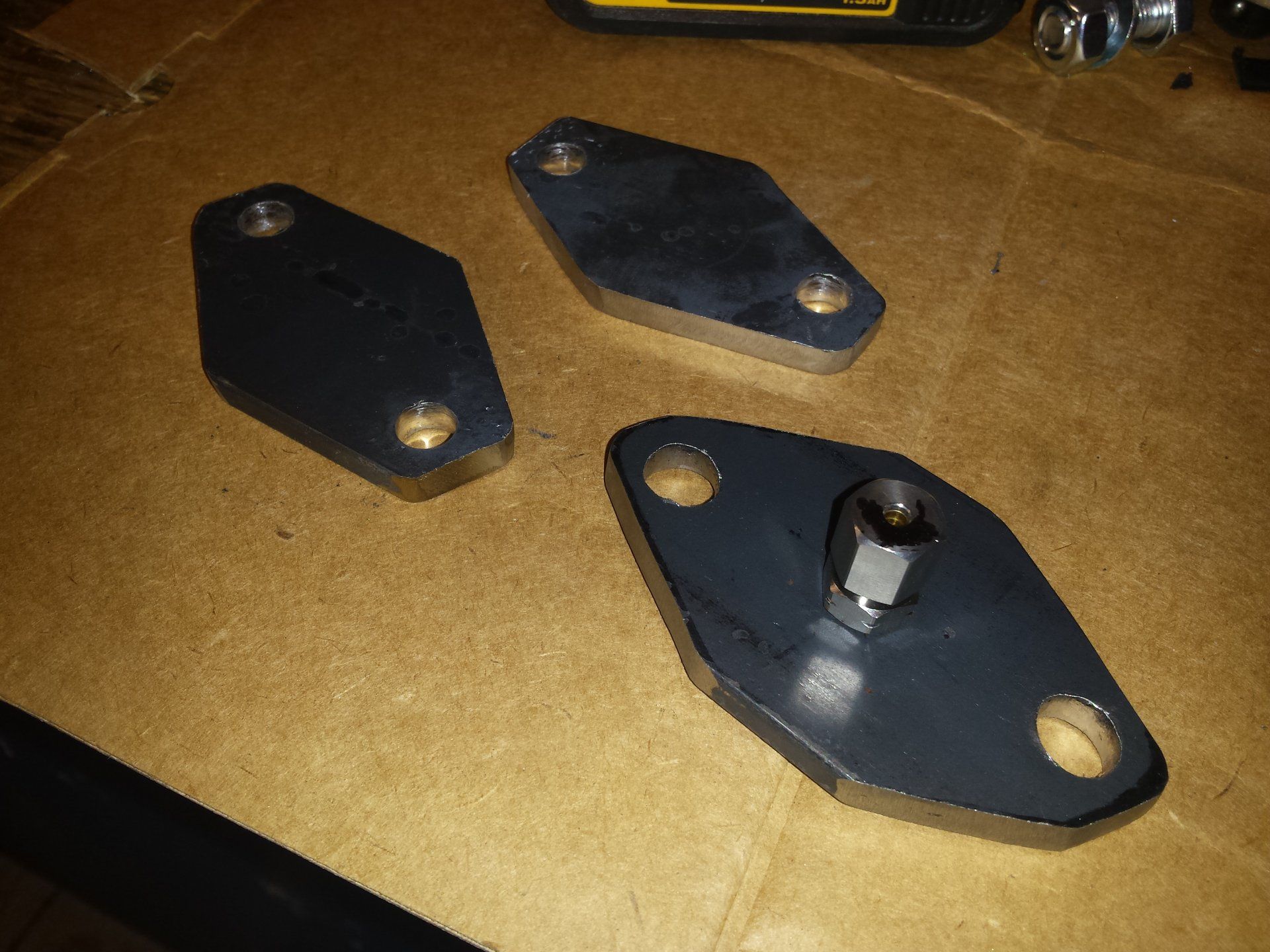

Bought a small scrap piece of 1/4" plate, used the gaskets as templates and cut these up. Used a grinder to round the corners a bit, drilled some holes and ended up with something that looks like it would do the trick. I know they're not the 1/2" thick fancy CNC'd 6061 aluminum that all the big truck shops like to sell, but I think they'll be strong/stiff enough for the pressures they are going to be seeing.
Yes, I still ended up putting the temperature probe in there so I can faithfully keep an eye on #6. It was just really easy to do it this way right now, and it still gives me a pretty good idea of what the truck is doing, within an acceptable margin of error.
I used some ultra copper RTV for the intake blanks, but I re-used the original gasket on the manifold side for now.

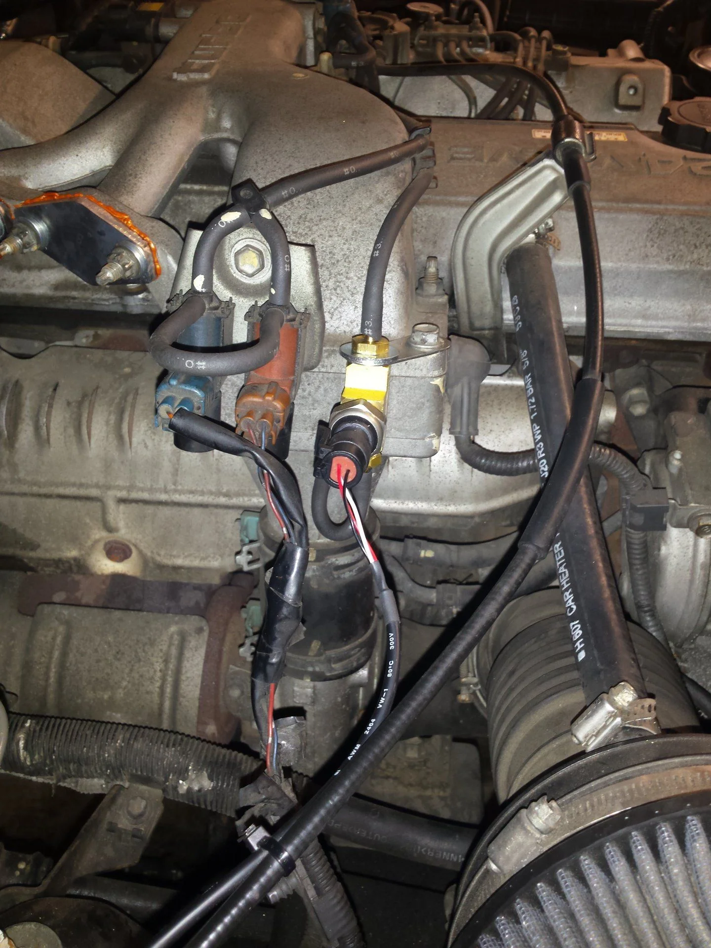

As part of the delete job, I just took the vac line from the solenoids to the doohicky and tied the two solenoids together. Since there is no ODB on this vehicle to worry about, I'm assuming I can completely remove the solenoids/wiring and plug the vac line to clean up the area even more? Anyone anticipate any issues doing so?
I also included a close up picture of my sloppy/lazy work, e.g. the stud being about 1 thread too short for the nut. I think it will hold OK. If not, I can always resign myself to spending more time doing the job right.

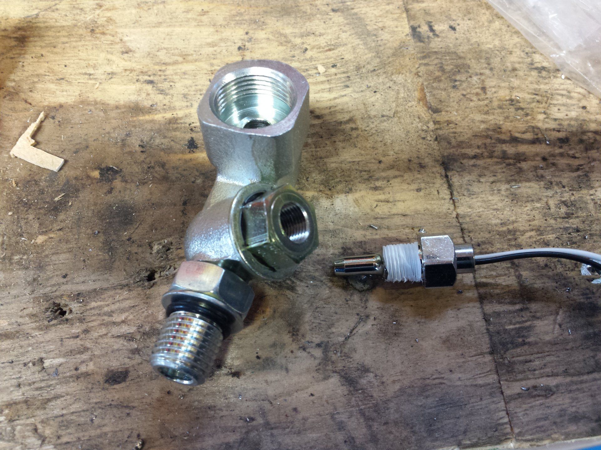

Got the tranny union in the mail from @IanB. Started looking at drilling it so I could keep both parts, but the sender that was provided is pretty long, not the flush button type that the factory one is. Looking at the 90 degree bend in the union, the hole gets REALLY small in there, so I didn't want to impede the flow any more than it already was. Ended up grabbing a M16x1.5 plug, and drilling that out to replace the factory temperature switch. It seems to fit pretty much perfectly, with the end of the sensor just entering the fluidspace in the union.

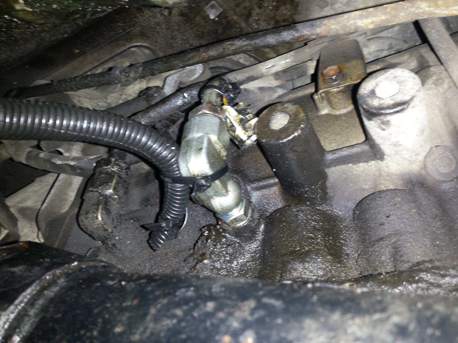

Installation was a BITCH, to put it simply. Looking up there, I figured that union is in a pretty accessible location, and shouldn't be a problem. Actually trying to do it was a different story. The JIC/Compression (I don't know which it is) fitting on the hardline going to the rad was CRAZY tight, and in a spot where a wrench can only turn about 5 degrees before hitting everything else in the area. Spray the whole thing with PB, smack it with a hammer, and grunt like hell. Then, once its loose, the hardline is so difficult to move out of the way because of the awkward position. Once that's figured out, you can't turn the union out of the tranny because of that wierd useless looking mounting bung beside it, so you have to take the factory sendor out first. And do it all in an area that's been having grease from the driveshaft slung all over it for the last 20 years. Then reverse of everything to put it back in there. Wasn't much fun.
Routed the cable from inside the engine compartment down the shock tower to the frame, and followed the frame over.
The factory sensor must be N/O, because I'm not showing the error light at all, and I figure having the temperature right there should be a bit more informative than the error light anyway. And, it's a Japan vehicle, so no OBD to worry about throwing a code by removing it. So, I just tye wrapped the plug there and will leave it alone.
First couple drives around town show me I'm running around 150-155F when it's up to temperature, which seems reasonable, haven't had it on the highway or in any hills yet.

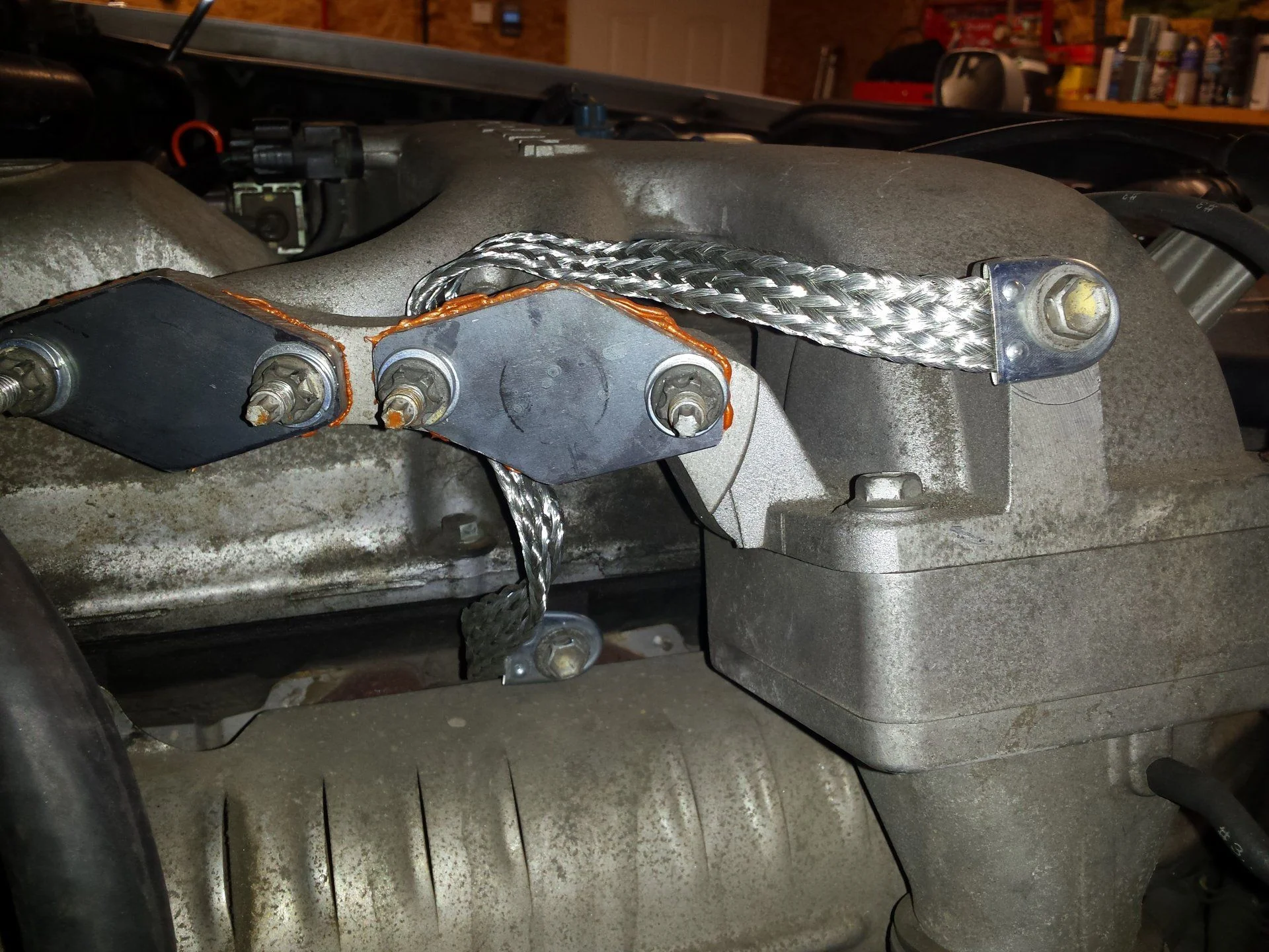

On another thread somewhere in the far reaches of the internet, while in the middle of a quest for knowledge regarding a glow plug light that stayed on occasionally (while not often enough to be a immediate concern), I saw a suggested explanation: When removing the EGR pipe that connects the intake to the exhaust, you now break the path to ground that the intake heater makes use of, so the intake should be grounded to the engine. It was even claimed that it ends up shorting inside the injection pump, which sounds like a bad thing.
So, I took a look. The intake heater is just a one-wire feed, so the electronic wizardry that tells the dash indicator to turn on must be connected somehow, and once the ground is gone, it thinks something's up, then that gizmo turns the light on. With the intake hose from the turbo being rubber, the next point that the heater gets a chance to ground out is going to be where the injection manifold attaches to the engine. If you look closely at the bolts, however, there is a rubber/plastic gasket type material that is in between the intake and the engine block, which even appears to isolate the bolts that hold it there. If there is good enough isolation, I suppose the next path I can guess is that the diesel inside the injection lines would be acting as the conductor.
I haven't pulled a multi-meter out to check this theory out further, but it makes sense to me, and was an easy fix: I tossed a ground strap on it. Could maybe use a smaller gauge wire and make something neater one day later, but for now, I want to test the theory. If I never see the pre-ignition heater light turn on, it worked. If the light does still come on again, does better grounding hurt anything? Probably not.
Maybe anyone with the 1HDFT and a removed EGR system should take a look at theirs? Does the EGR coming out of the gasser engines have a similar effect?

We shall see how this works.
