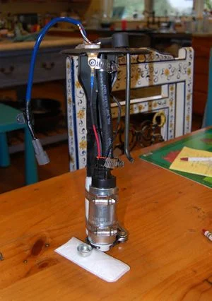

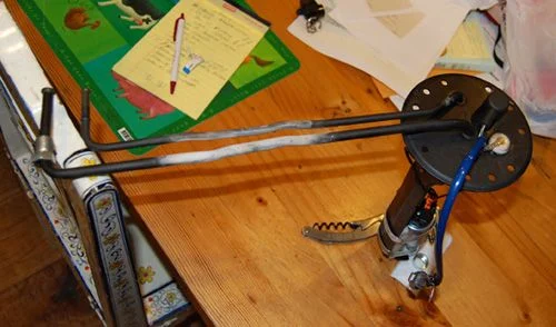

I picking away at my conversion slowly and finally got all the elements for the fuel pump fixture.
This is a stock FJ60 fixture from Cruiser Dan that I had lengthened to match the depth of the MAF long range fuel tank and a Holley pump that someone on this board pointed me towards all hose clamped together (with some HDPE as a spacer) and soldered to the stock harness.
Hopefully it will even work.
Peter
looks pritty much how mine looked on my 62. i didn't splice the power and ground. i replaced the factory wire with the ones i got in the kit from MAF. it works good. did you lengthen the float?
