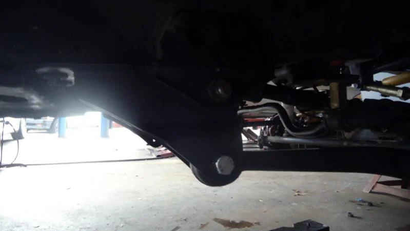

Easiest way, go to the MAF page or better, email them. I have the 4" but I have 4.5" lift. BTW Those brackets are worth the money I paid for. I had the caster correction bushings and the only lasted 1.5 years.
80 Series Caster Correction
