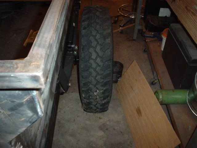

Thes pics should show what I mean....:beer:
Hub...at least on my axle, is not a problem.
Hope to re-start this soon......maybe tomorrow?:D
https://forum.ih8mud.com/trailer-tech/179496-trailer-build-started.html

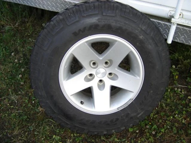

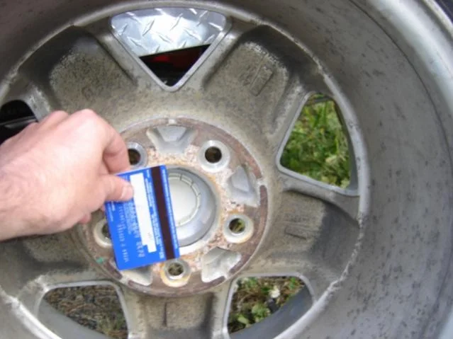

Thanks guys, but a 2006 wheel (not wagon wheel type).. here are some bad pics:doh:

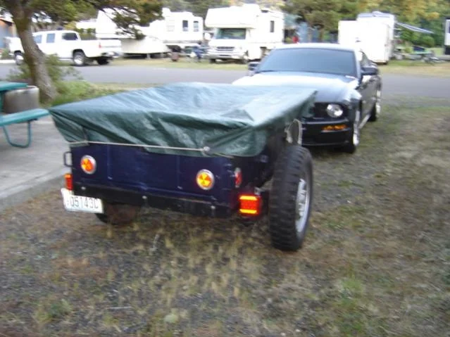

I wouldn't order the same axle length as the TJ ... it's gonna be REAL wide on the trailer. I used the same length as the stock axle on my M101 CDN and the funky offset jeeper wheels worked out just fine. I used the Cepek wheels instead of the stockers but should be the same deal.
As a side note, VERY glad I got the electric brakes when I ordered the axle. The jeeper seems to go alot better than it stops. :meh:
https://forum.ih8mud.com/trailer-tech/123309-m101-cdn-build.html
:flamingo:
Wow Kowboy.. Thats the color of my jeep.. Want to start over and do mine and i will hang on to yours for awhile...?? I am going to measure the stock axle, but i think i will have to get wheel spacers also so that the axle hub will be behind my rim. I dont think the axle hub will fit thru the rim like on yours.. I have read some where in these forums that i need to get a 52" or 53" axle.. Man would nt it be easier if someelse had the same problem or a least lived in WA.. Thanks everyone and awesome trailer Kowboy..
