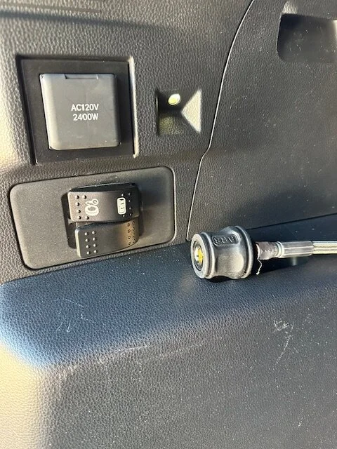

I mounted the ARB brushless compressor in the foot well of the third row which I deleted. It will be under a new floor when I get that installed. Very convenient for wiring to the battery and I used the button spot for the third row for the switches to control the Compressor. Works great here so far. I have a single but there is room for a double If I feel I need more air over time.
