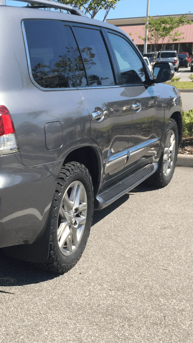

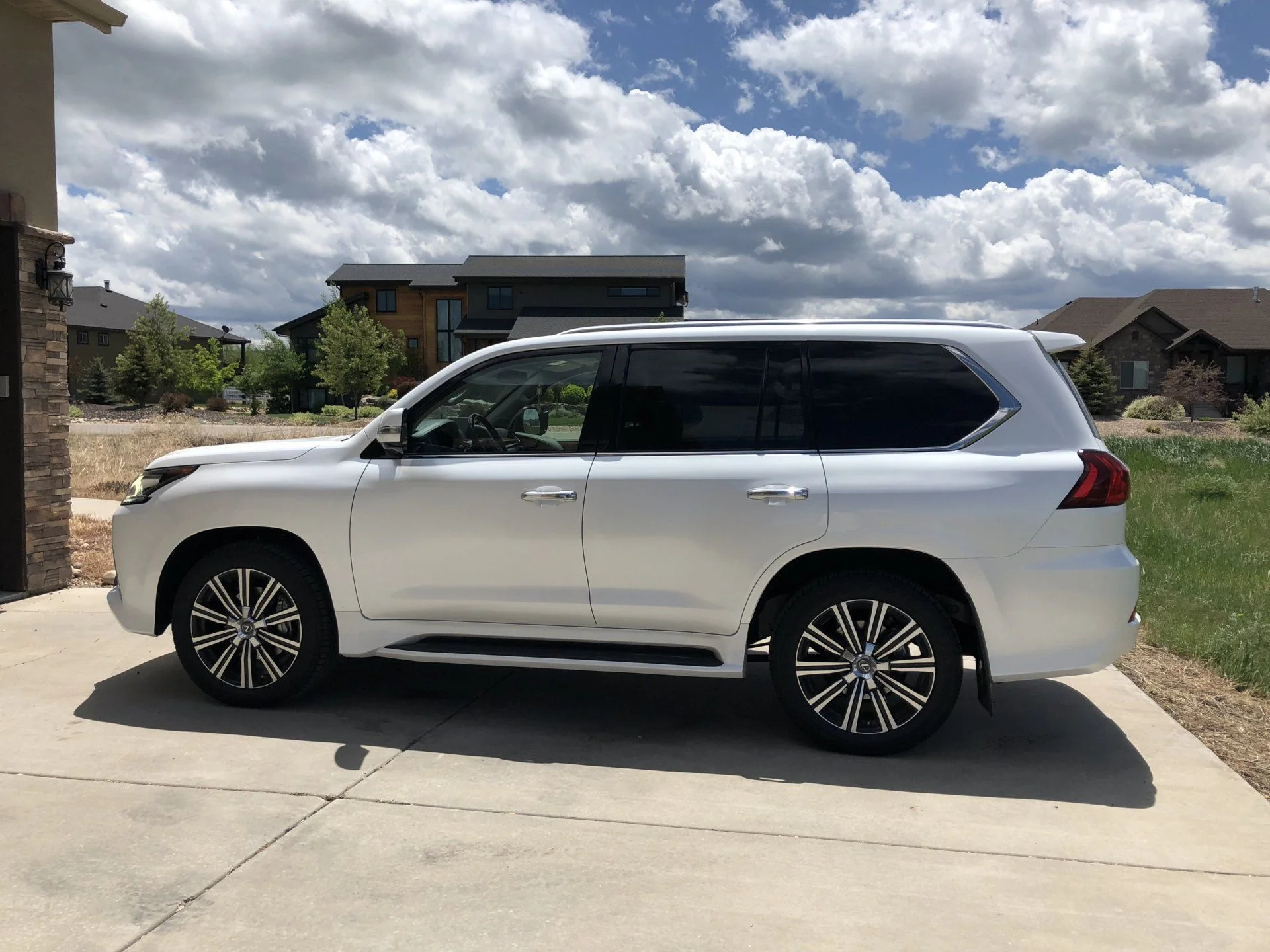

I will be fitting a set of 275/60R20 BFG KO2's to our 2019 LX and it's factory wheels next week. This size works out to be a 33x11x20. I think it gives the truck a more aggressive look without forcing the purchase of new wheels or detracting from it's factory look, it's subtle but still allows for light off-road duty when necessary and that's what the misses wanted. Pic of 275/60R20's on a 2017 LX 570 in High AHC mode, not too shabby if you ask me.

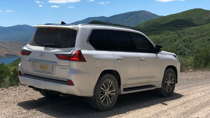

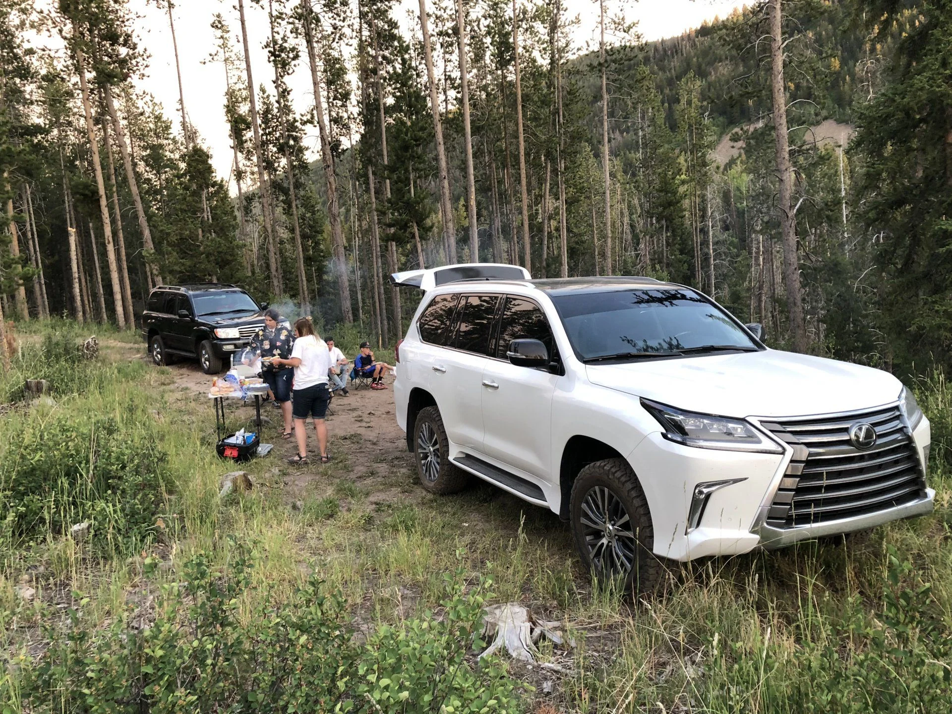

I had the 21” rims and opted for the factory 20” rims with 275/60r20 ko2’s. I do pretty light off roading with my 570. Family camping trips, etc etc... when I go a little harder I just load up my lx470 which has 275/70r18. I have scratched, dented bumpers, dinged it and bashed up the bottom of the suv... things I’m not willing to do on my LX. Here is how they look on a white one vs factory 21”

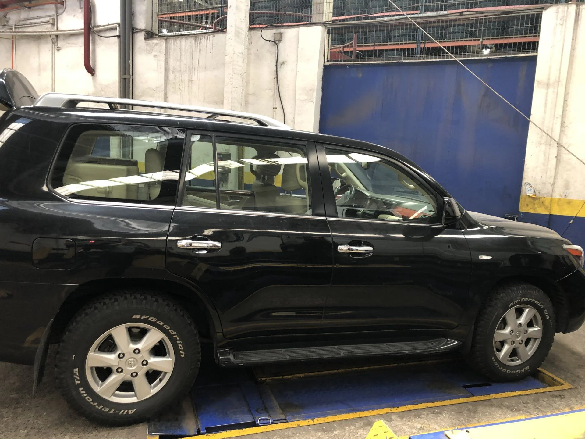

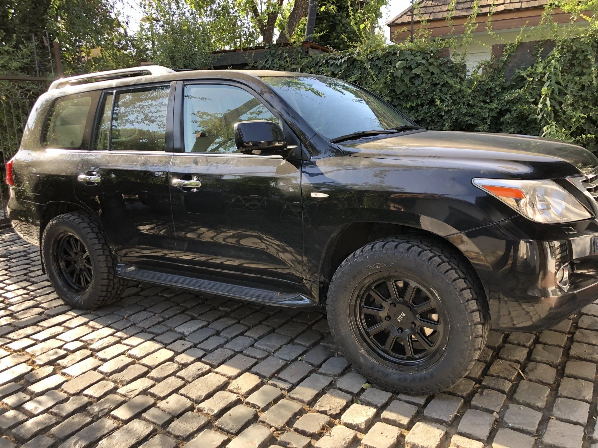

My 09 LC has 21 LX570 wheels and tires as shown in post 12 above. The PO swapped the original 18" wheels and tires for these. Ride is great! Speedo is spot on, Odo reads 3% slow so have to correct mileage driven by 3% to get accurate MPG. I am looking on returning back to 18" wheels.
