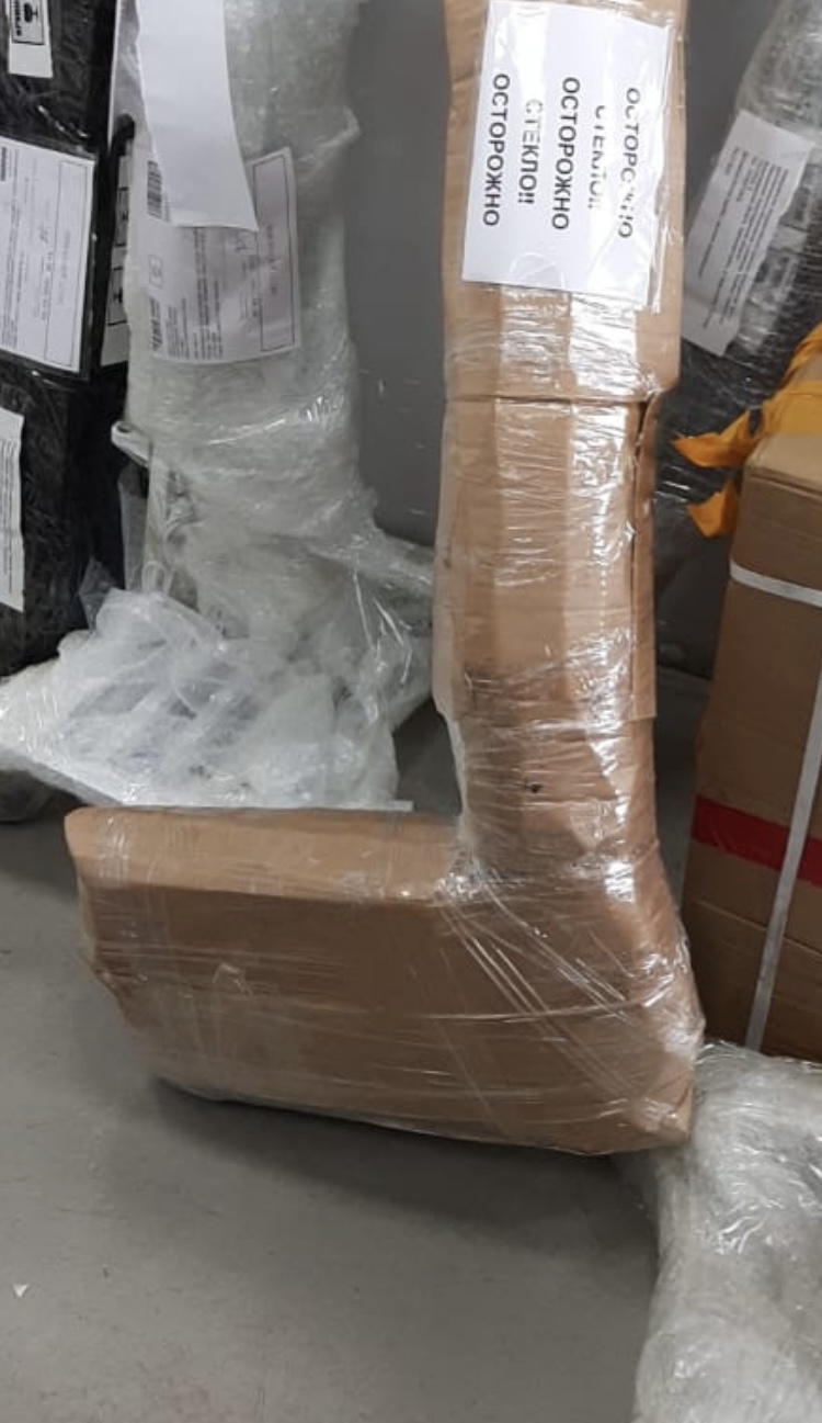

So my snorkel is here. Unboxed and it looks good. @RDR78 did you do much smoothing putty or Bondo before you painted? There are definitely sanding and or grinding marks on it. They sent a sweet fiberglass template that fits the vehicle nicely. Also did you paint it or did you pay to have it professionally done?
