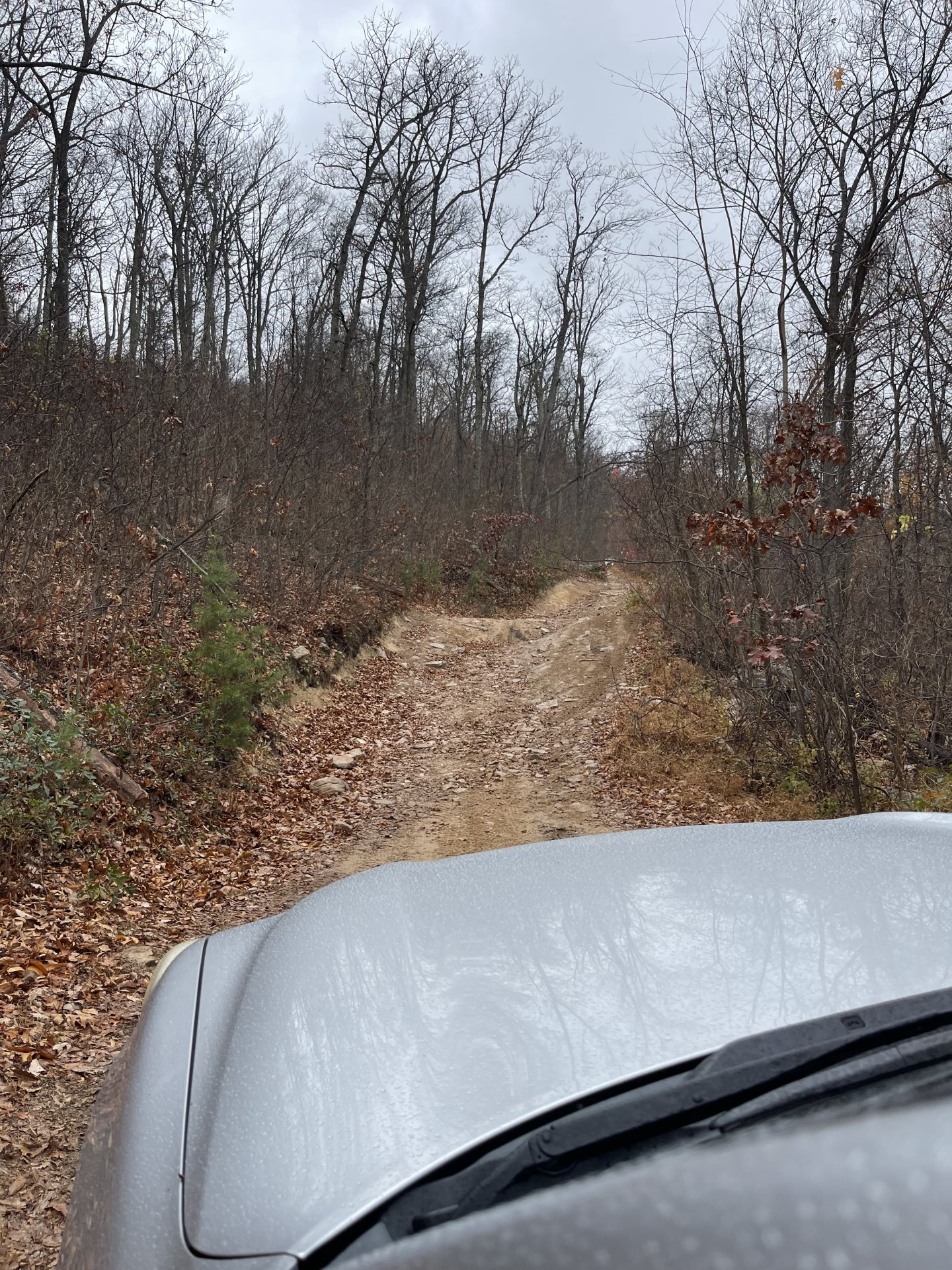

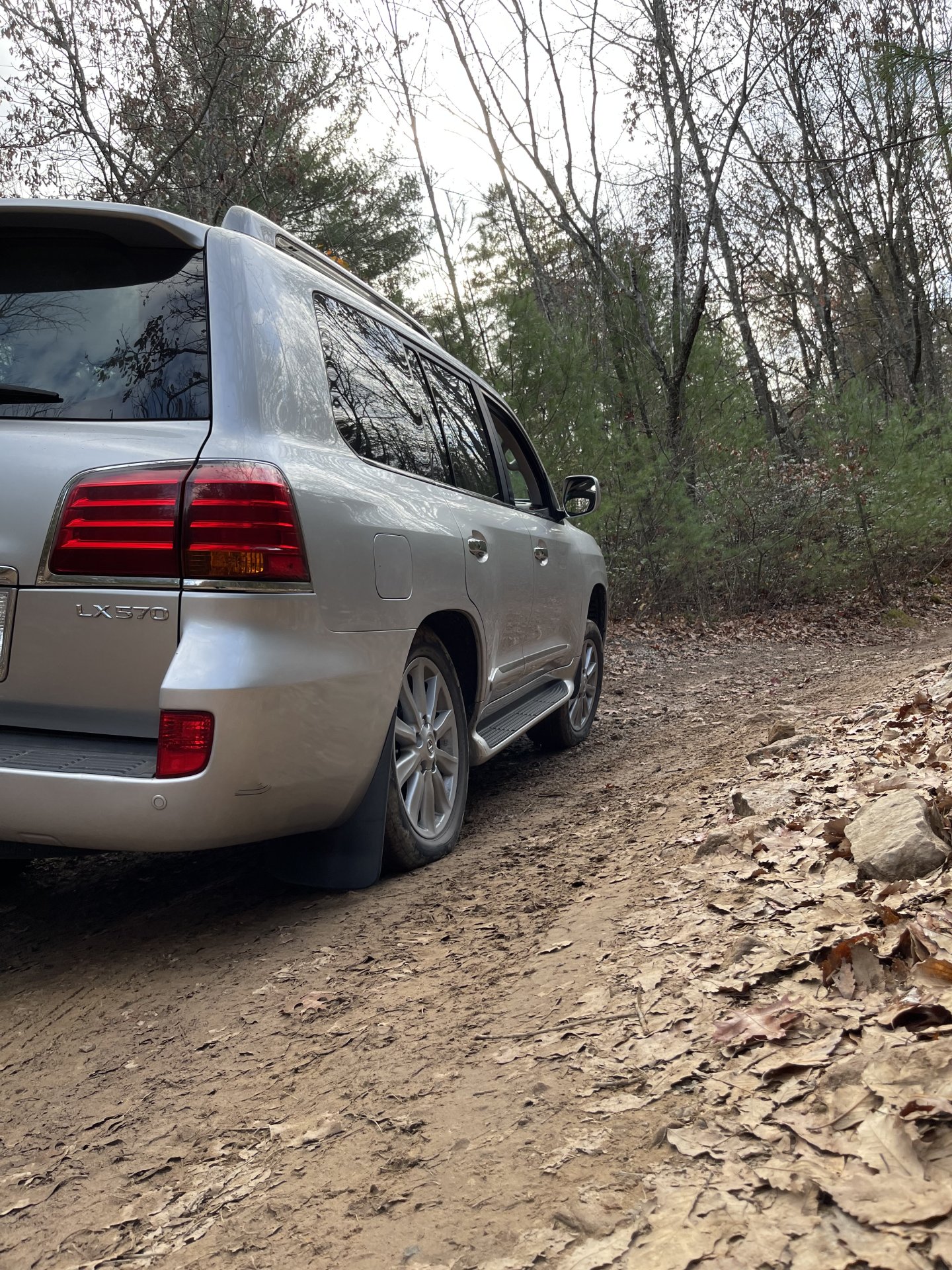

I just picked up an 09 LX570. I subsequently took it out to Peter’s Mill Run in VA which is a Jeep Badge Trail. I made it through yesterday with no problems and was doing well today even with a bit more mud/wet conditions until a rock took out the side of one of the Michelin street tires. I’ll see if I can attach pictures.

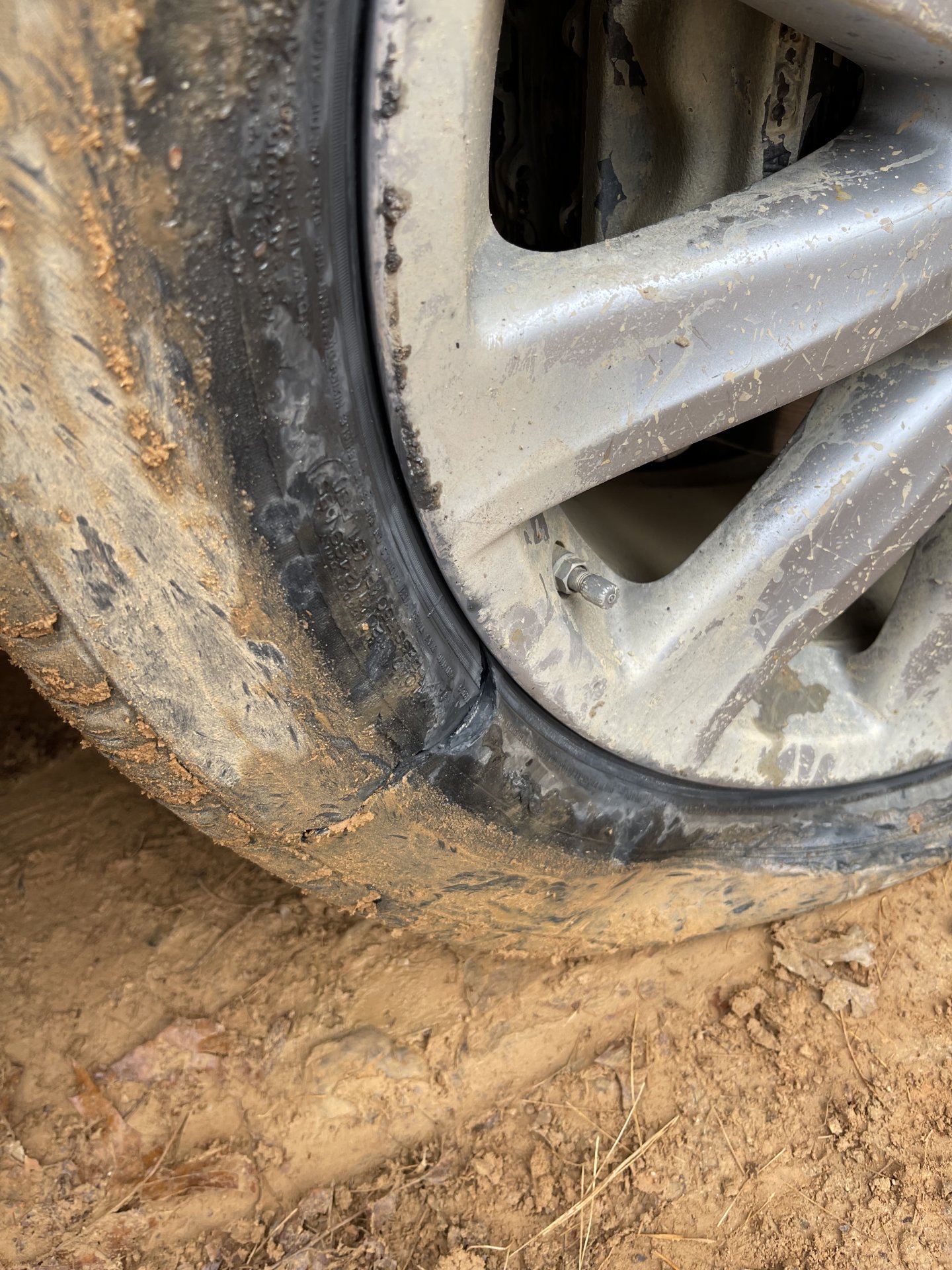

I was on a steep incline when I heard it pop, made a three point turn ASAP, made it down to a flat section but not before losing all air. I was very fortunate to make it down and some good people to help out. Whoever had the LX before me removed the jack, so while I had tightened the wheels up and knew the lug wrench kit was in the vehicle, I didn’t verify the jack was. Turned out not to be much of an issue as a nice guy on an ATV went to his campsite and got one.
With track driving it’s good to take vehicles out stock and see what needs to be addressed first. Well aside from proper planning for the trip like verifying a jack, tires would seem to be it.

What Michelin tires do you have now?
At least in pics above, you aired down, right? If you did, then this exposes the sidewall of a street tire even more to damage.
And THIS is why I always favor a tire with strong sidewall. Sidewall punctures just suck to no end! Been there, done that. On the trail is the last place that you want to change your tire(s) out. And once you’re down to your spare, then that is end of the day for you...turn around and head home. It just sucks.
Honestly I don't know what they were. LTX? I did release a couple of PSI, but they were at 34 or so when this happened. Funny you should mention this, as I did not air down at all on Saturday and had no problems. I did release some air yesterday as it was raining and muddy, and I got the puncture. Definitely was the end of the day and did suck.
