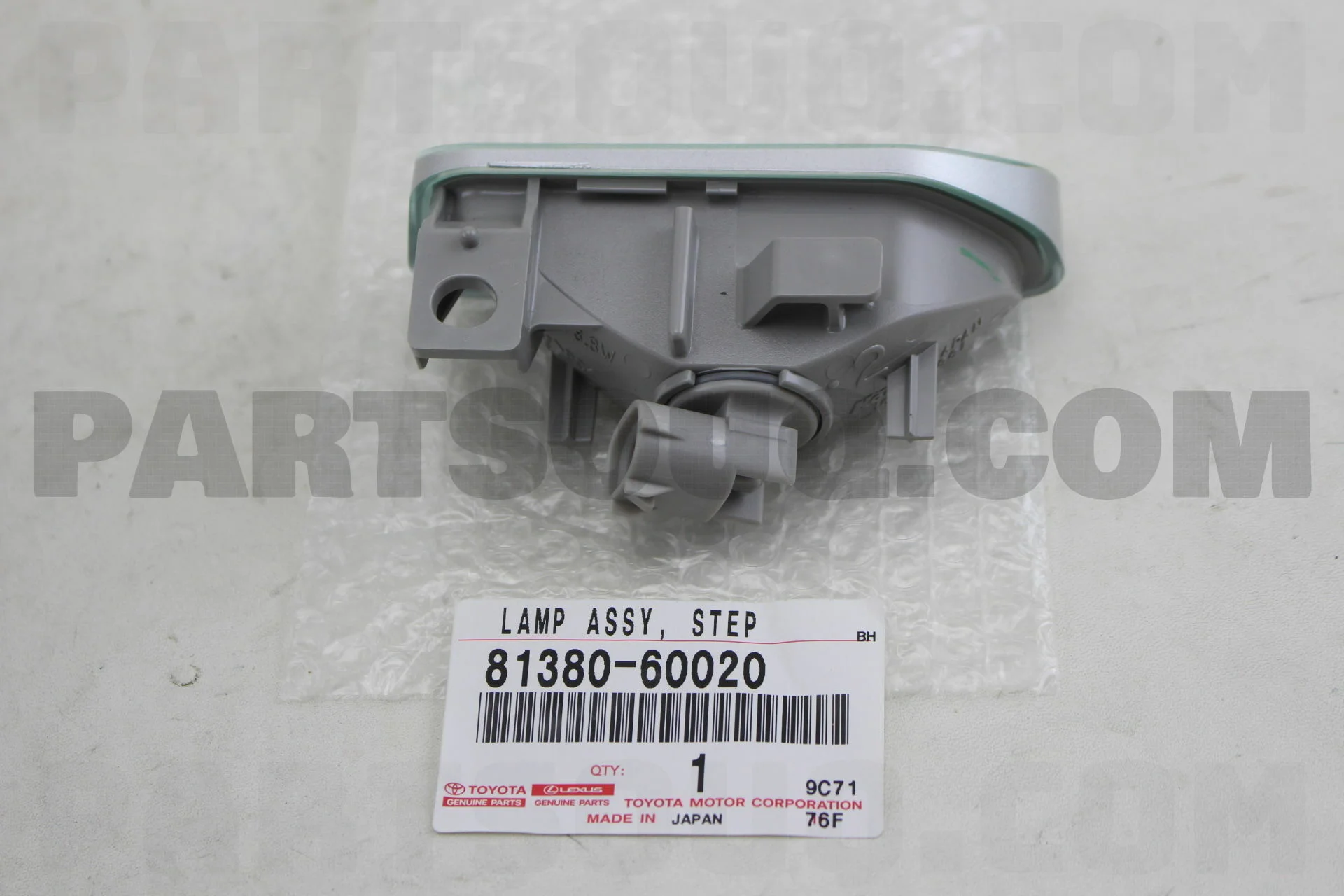

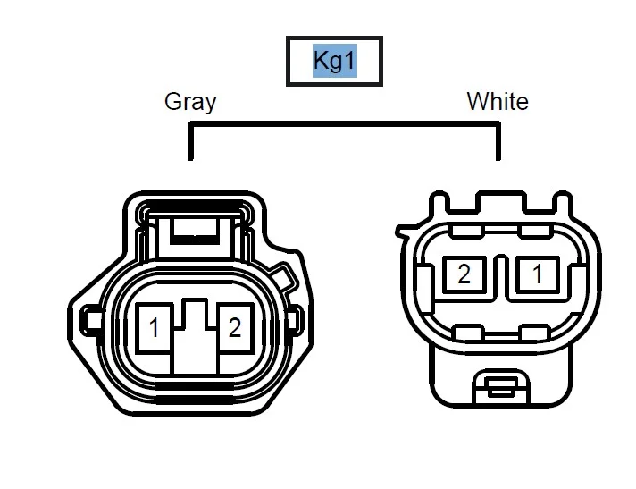

Wondering if you could please help me out obtaining the part # or aftermarket connector type for the electrical connector that is attached to the running board lights, (Part #81380-60020 photo below) I found it labeled as KG1 on the EWG wire in body section, but can't seem to locate a part # or the connector type. I plan to use the connector to wire after market lights that I can plug directly onto the OEM harness. Thanks!
With the tremendous help of @ToyotaMatt , was able to find the connector part number that can connect directly to the OEM step board wiring harness.
Part #90980-11168
