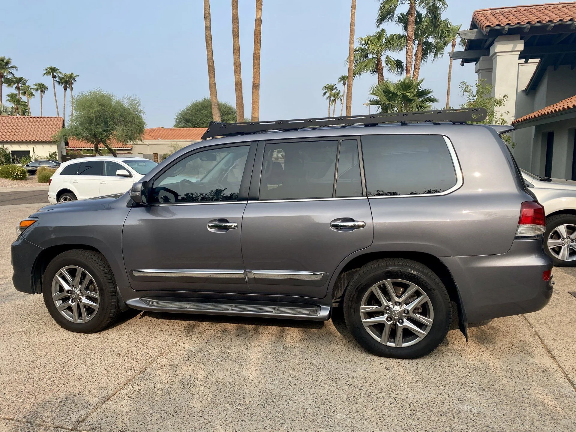

I have started to do a chrome delete on my 2015 LX570. What is everyone’s thoughts on pulling the door molding opposed to blacking out the chrome.
If you pull it off you'll need to cover the holes in the doors through which those mouldings attach. Some here have had bodyshops fill the holes with bondo and re-paint, others have used vinyl.
The door molding will pop off and the chrome unscrews from the painted base.
You can then paint/wrap and reinstall.
How does the silver chrome around the windows get addressed? I would like to delete my chrome also, prefer to paint to match body.
I think 'mud member @Eric Sarjeant has the chrome window trims painted on his chrome delete packages.
On the back I have taken some off and painted while others I used Platidip to see f I liked the look. It was really easy to spray 5 coats of plastidip. Over the next few weeks I will see how durable it is.
Do I have to take interior door panel off to take trim off. I haven’t seen a clear answer to where it is screwed. If I remove trim does actual door have a hole?
No. It all pops off from the exterior. Just pull it.
