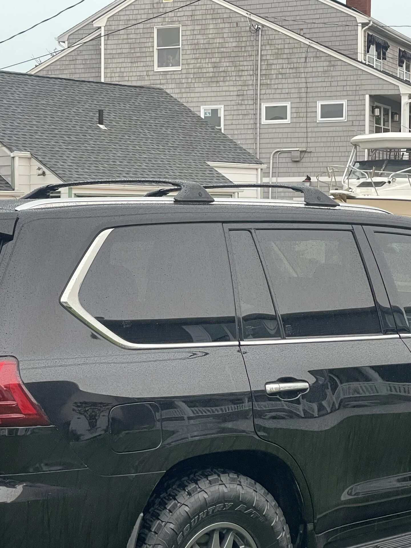

What year LX570 was this on? I have a 2017 that is leaking out of the passenger side B-pillar as well. I just got it back from the dealer where they installed a whole new sunroof and it is still leaking. This I my roof rack, is this the factory one?
Where does it leak? Around the bolts that attach to the roof rails on the inside? Where do I put the silicone? I had some bodywork done on the roof and I’m wondering if they took off the rack and didn’t reinstall it correctly. Thanks!!

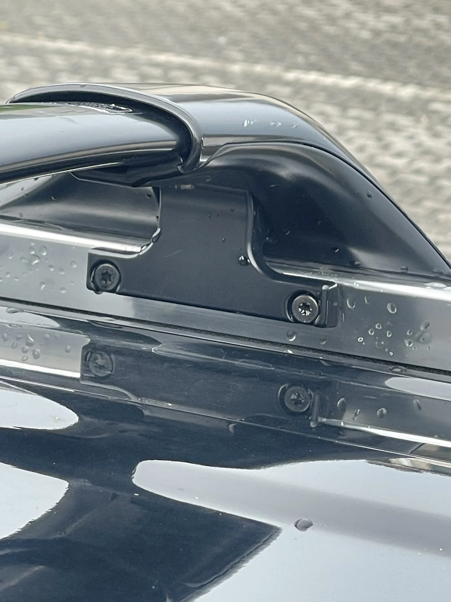

Thanks @doru. I’m assuming it is not the sunroof since the dealer just got done replacing it. But I will try the hose. Is it these bolts it leaks around?
Or is it bolts under the chrome roof rails. It looks like the only way to get to those is under the headliner.
Alright so I took the hose and sprayed over the sunroof and inside of the roof rails. No leaks. As soon as I sprayed the outside of the rails I got a ton of water gushing in. Video
The bolts are under the rail, not visible, attaching the rail to the ruff structure.
