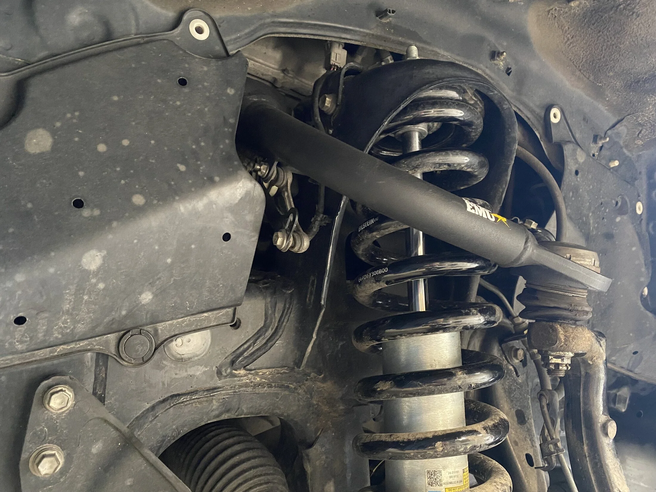

OME does. Can’t confirm the proper angles as I’m not on AHC anymore (just kept the height sensors for the AFS), but they bolt up just fine.
