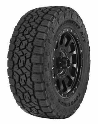

I'm going with Toyo AT3s
Tirebuyer.com with the coupon code tiresize05 seems to be the cheapest way I could get them in 275/75/17
I ordered from SimpleTire through ebay as they currently have $100 off $400 coupon. I ordered 2 pairs (seperate orders) to receive $200 off. They obviously expect this, because my 4 tires shipped with one tracking number. Got them in 2 days.
example auction

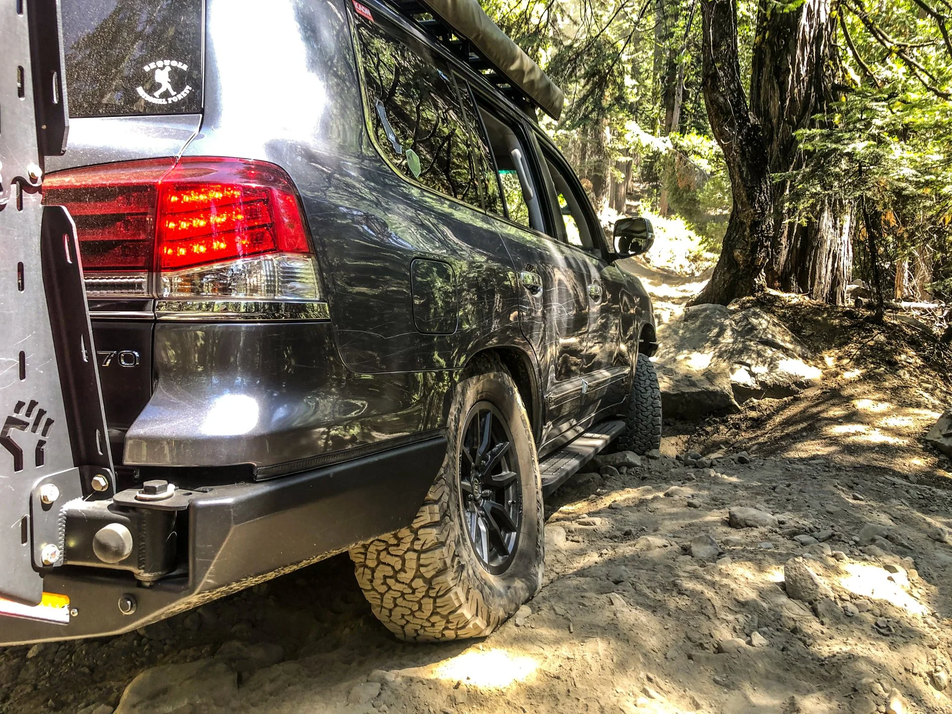

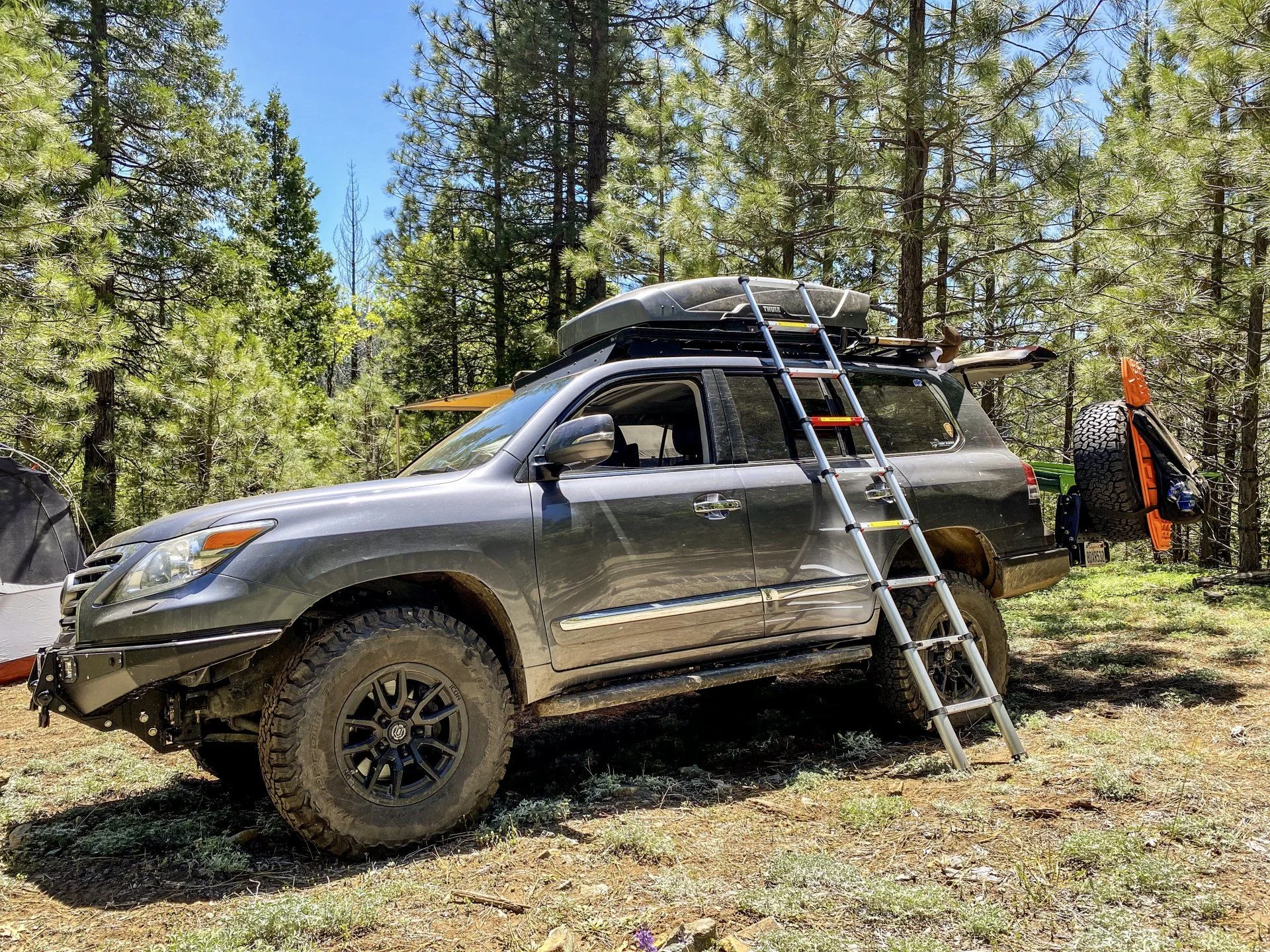

Do your 285 75 r17’s on 25’s poke out past the fenders?
No, they are inset just a bit. Here are some recent pics. The first you can see how they fit, and the second you can see how they tuck:
View attachment 3122101View attachment 3122102
Very good. Do you think if you had a relatively sharp drop, would both rear wheels tuck into their fenders at the same time?
Or do they need to angle/flex a bit in order to “rock” into the fenders?
I have hit a few woops and never had an issue. When I first got the wheels and tires installed, the fronts would rub the front fender liner when I hit a bump with both sides at the same time so I had to push it in with a heat gun, but I have never had an issue with the rears.
