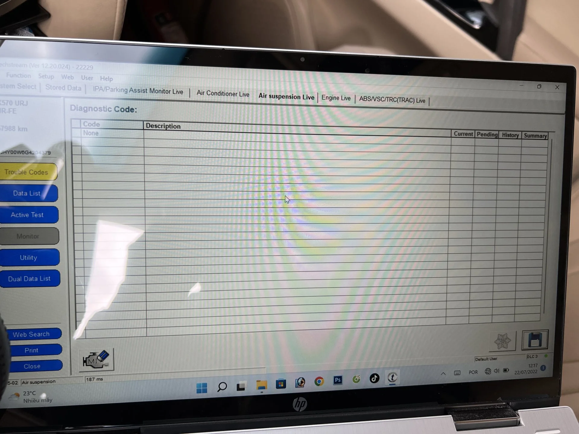

As in the title, my lx is rough, feeling every little bump on the road.
i have replaced the fluid and 4 ACCUMULATOR but nothing improved. this is what i got from techstream. no error code. Any ideas?

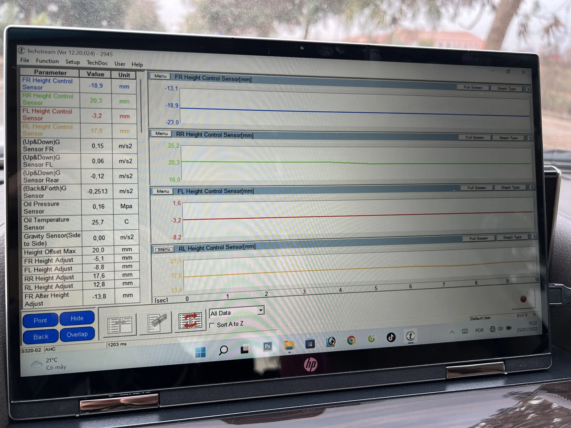

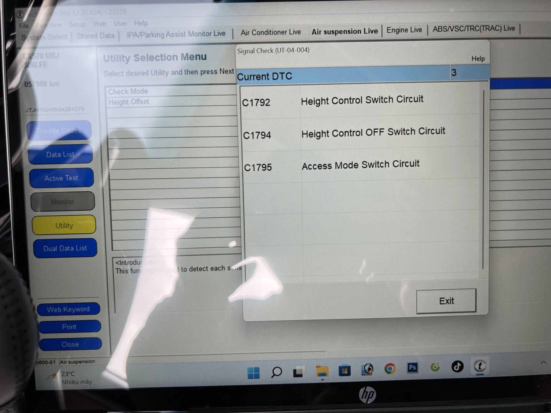

I do not, but a few things look odd.
1. Air suspension? Is the techstream vehicle selected correctly? LX shouldn't have air suspension, I don't think.
2. Heights are weird. Too far from normal.
3. Trouble codes. Seems the system has 3 current faults. Might be over common fault triggering three codes. Gotta fix those.

3 trouble that I have to replace what?

The three DTC code you see on your screen - those need to be addressed first. So far you have gotten responses from the folks who own older 100 series LX, so we don't know what those codes mean exactly or how could they be fixed.

There are electrical faults. The three DTC that you show in your screenshot are not normal. You or a mechanic should look at the service manual and wiring diagram to find potential causes.
Replacing parts seems unlikely to fix anything. Check wiring. Simple job, but not easy or quick.
The height control switch and height control off switch are both in the center console. The access mode switch is on the dash to the left of the steering wheel. I suspect they tie back to the suspension ECU. I wonder if someone unplugged something going back to that.
It is strange that your menu says "air suspension". That might be an anomoly of it being a 2016+ and possibly foriegn to USA market. I know when I go to that same data list screen, i have to go to the "AHC" menu in techstream. But that's on a 2010 model.
It looks like you ran a utility to get it to show thoses DTCs. I wonder if you just didn't run the utility correctly. Testing all those 3 buttons is very easy. If you hit the AHC off button, do you get a notification in the dash that it's off? The Access botton has a light on the dash as well (looks like a stick figure getting out of a seat). And if you can change the height from N to either L or H, then the height control switch is working.

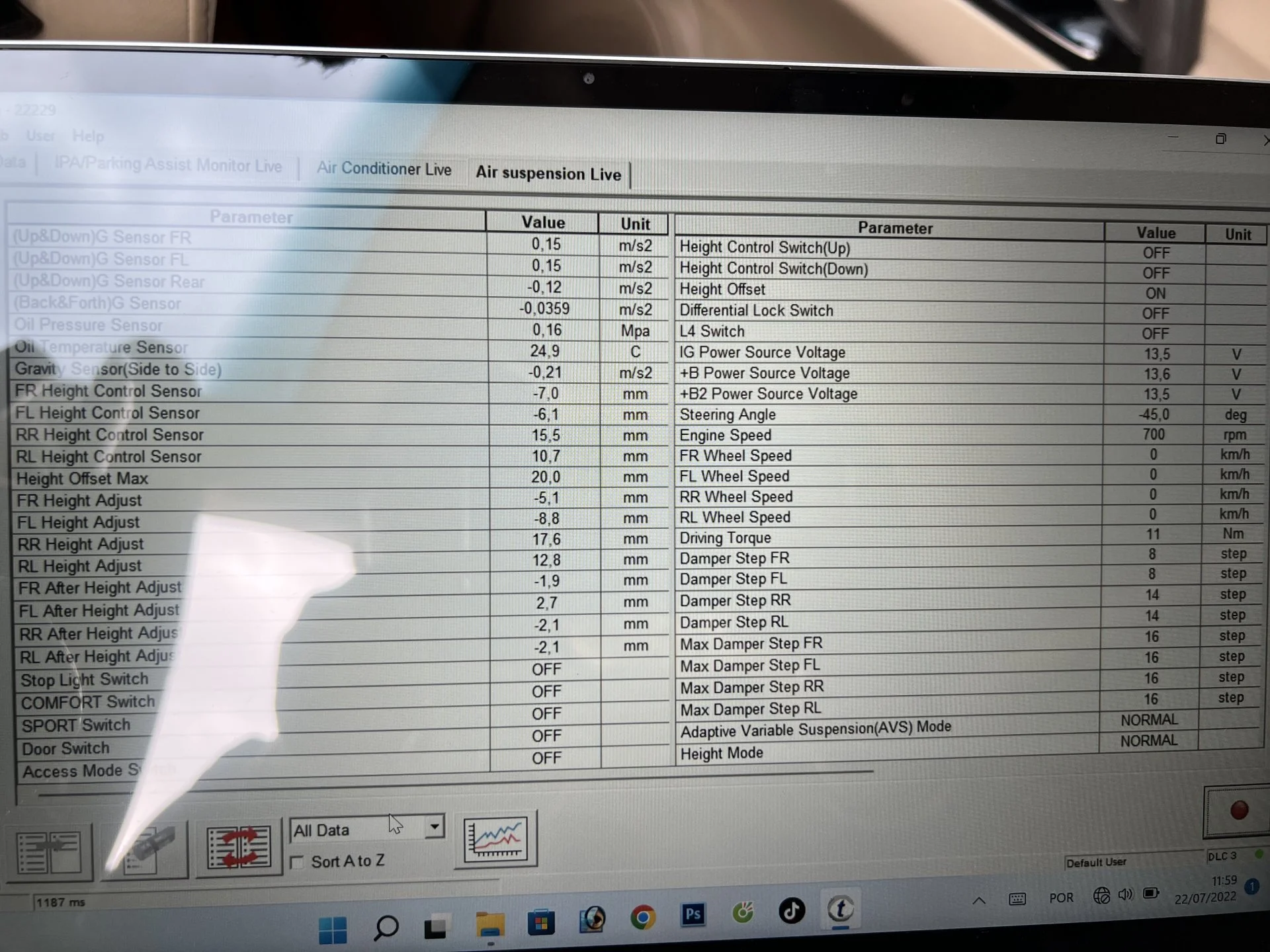

I don't agree that your height sensors look off. It looks like you are just on a slight decline when you took the picture. Everything looks pretty normal. It says you are down a quarter inch in front and up a half inch in rear. You damper steps look normal.. You could try putting the car in gear while connected to Techstream and see if those numbers change. At low speed and in D, they should change to something between 1-4 probably (at least on my 2010 it's that way, it's possible the later models could have a different "curve").

sorry for replying late. I've been sick for the past few days so I can't go online. all the switches you mentioned are working properly. Both lifting and lowering are fine. Until now I still have not found the cause. really headache.
