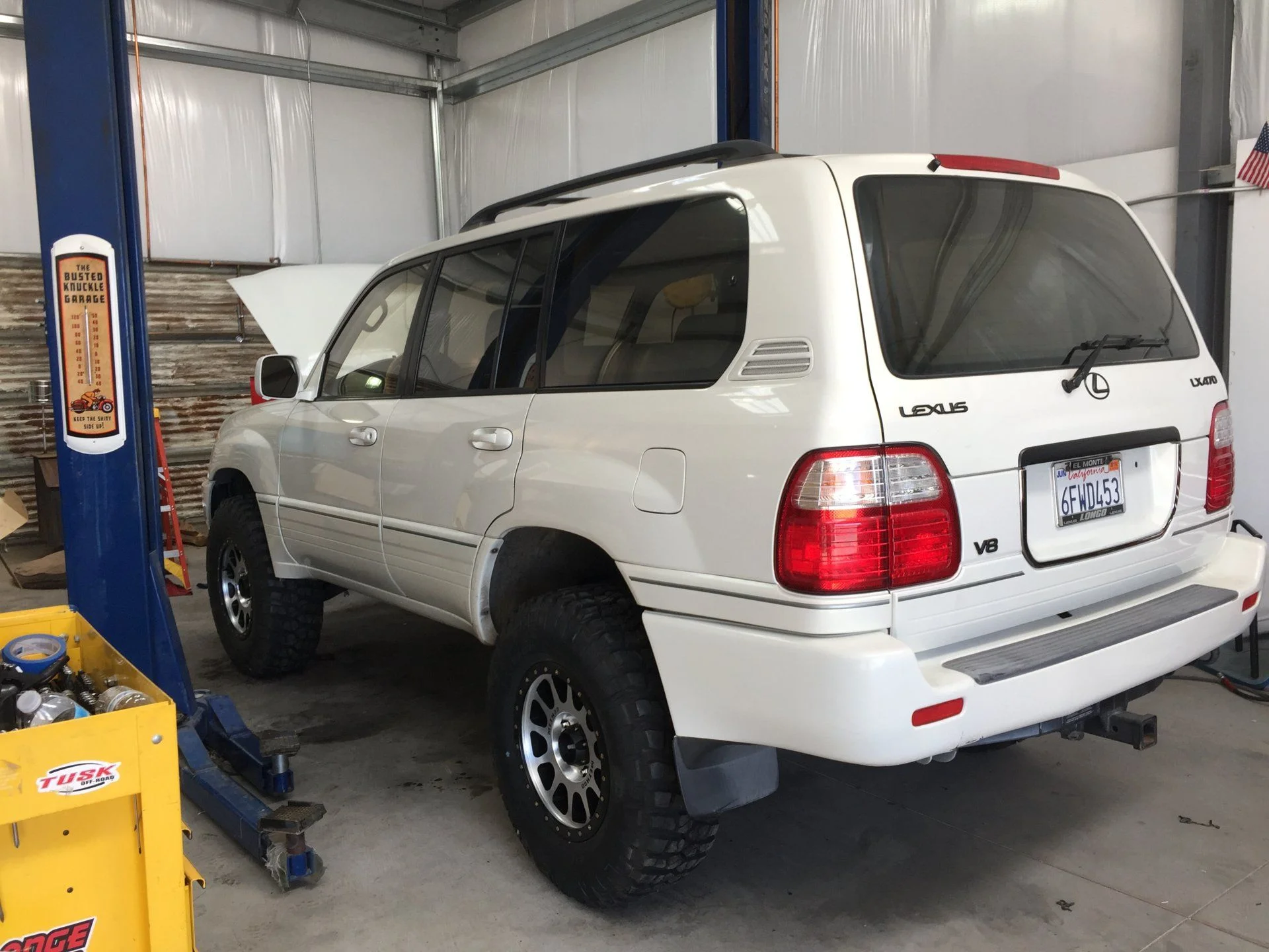

I have searched the forum and I have replaced everything that was mentioned. I purchased my LX a few months ago with 165000 miles on it. It's a So Calif car and in amazing condition. It has always been maintained at the Lexus dealer. It locked up on me a couple of times getting on the freeway when I first got it. SInce then I installed a 3" lift, which included UCA's, Icon shocks, and rear springs. While it was down I replaced the front axles, cleaned all four traction control sensors and replaced the ball joints and bushings on the rack and pinon. It has new tires and wheels and still the traction control has gone off twice while on the freeway on ramp. Any one have any ideas?
Here is what it looks like now.
It is the VSC actuating. Sometimes it will just beep, other times it will lock one wheel.

Your front end looks high (looks great), the yaw sensor is designed to have slight rake. Some of the Tundra guys have attempted to shim their yaw sensor with limited success.

what size tires are those and what lift do you have?
And if the 'size' could be measured with a tape measure from the pavement to the top of the tire that would be ideal. Lots of misinformation on this forum about "I'm running 35's!"...
