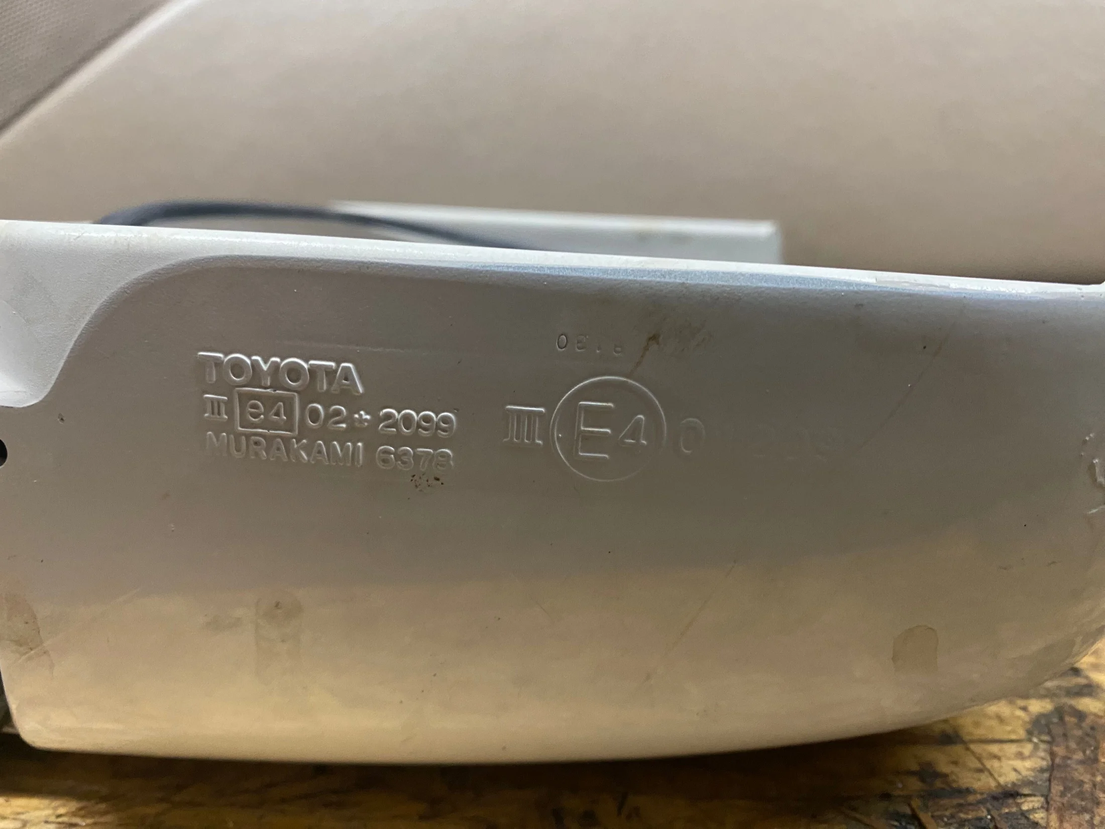

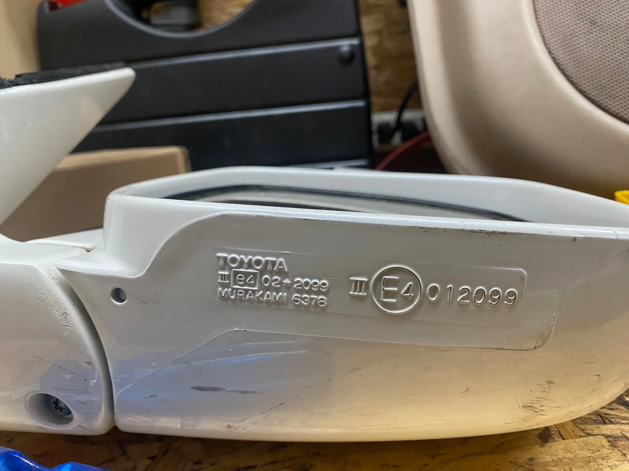

The two mirrors:
Old New

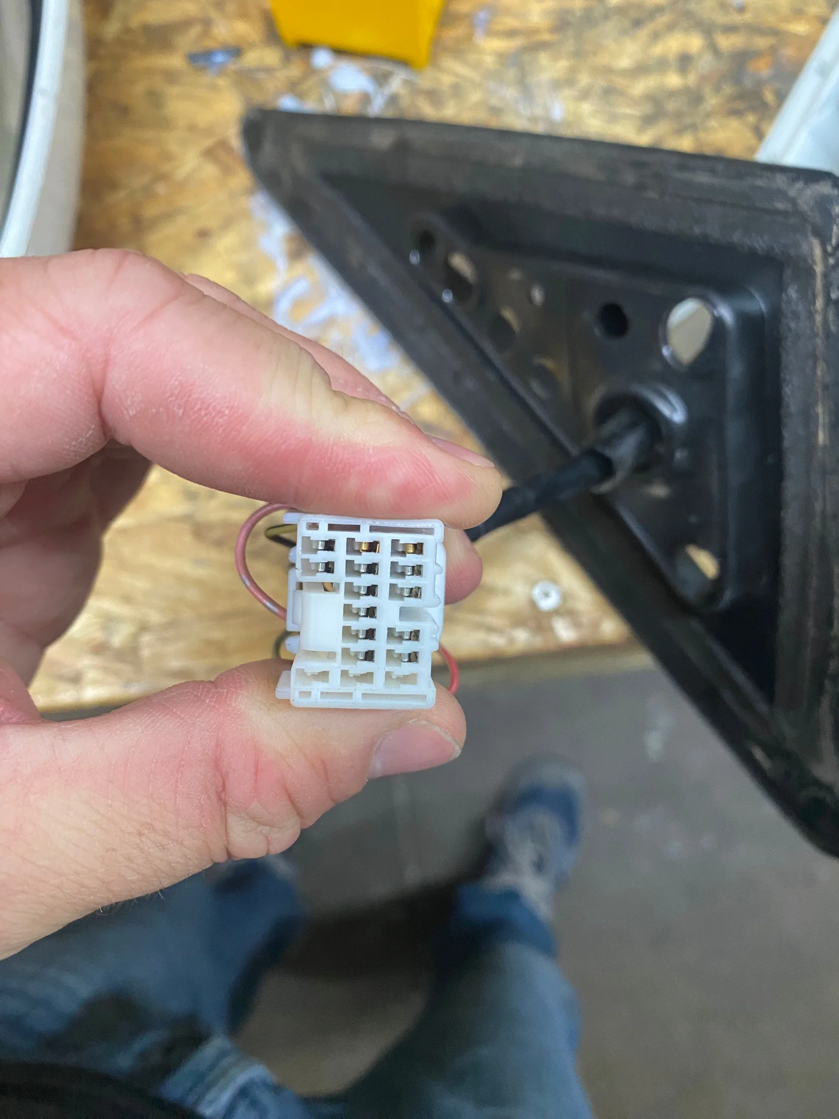

The connector from the old mirror:

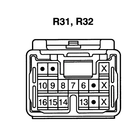

Matches R32 called out in the EWD I have for a 1998 LX470.

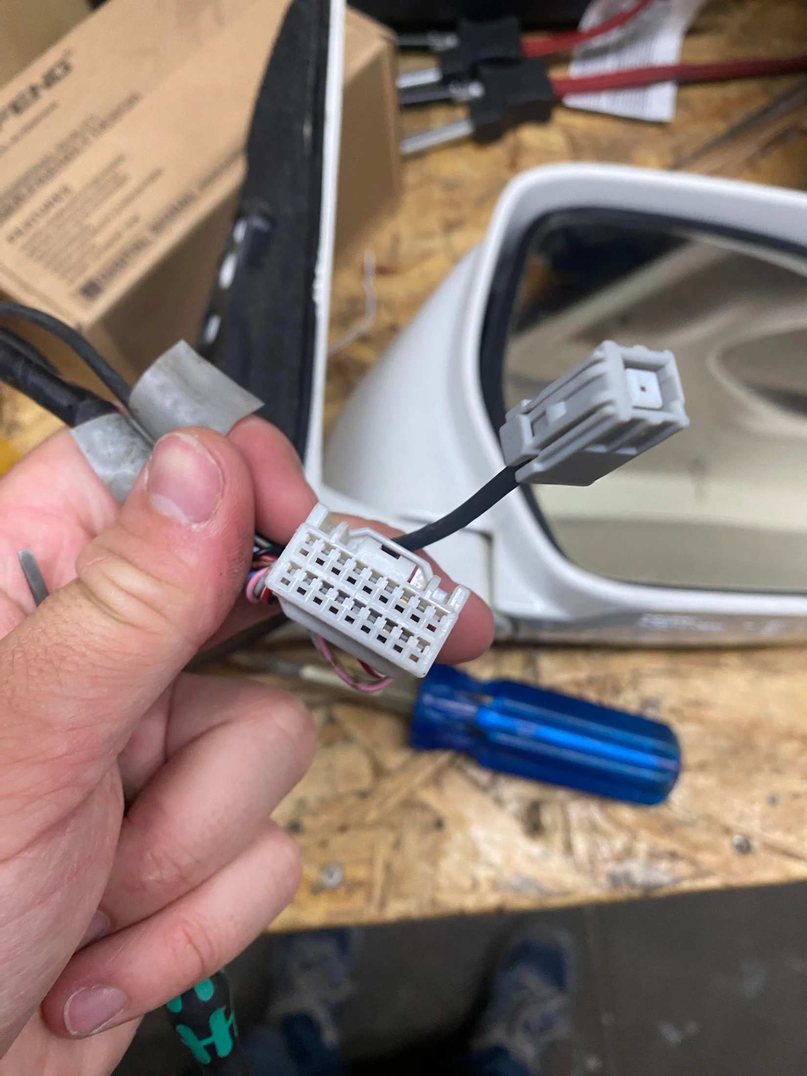

The connector(s) for the new mirror:
There's an 18 pin, and what appears to be a coax connector? Unfortunately I don't know what year truck this came off.
Ideally I'd like to find a wiring diagram for this new mirror and just swap the connector over from the old one. I'd like to maintain the folding functionality, as it's become apparent that I need it to fit into my garage... I don't need any dimming feature though, as that'll probably require swapping ECUs and other things.
I cracked my '98 mirror housing (on a tree) and was able to source an '04 complete mirror on eBay (same color). I threw it on and only the horizontal adjustment worked, not vertical. So I swapped my old mirror plate that had both vertical and horizontal motors. Still no dice. I swapped in my old harness and everything worked fine!
I'll just say it is a significant amount of work to swap the mirror innards. You have to de-pin like a dozen pins on the connector. '04 doesn't have that additional coax connector. The 3 mounting screws are difficult to remove even with heat. Permanent loctite. I had to drill a couple of them out. I did not compare wiring from the two years. There is also circuitry within the mirror unit.
