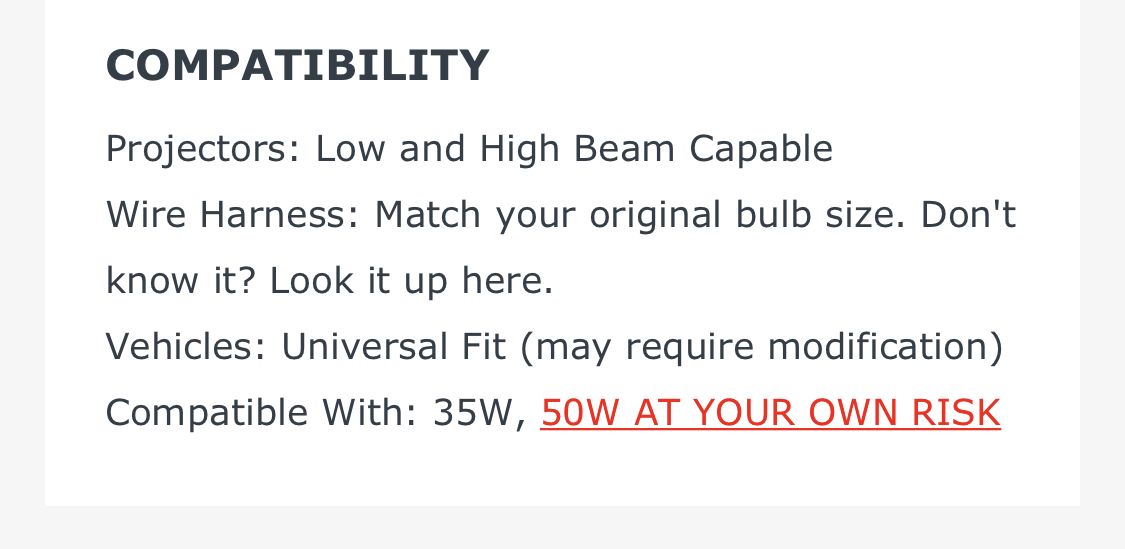

You might want to run 35watt ballast... I know the D2S can handle 55watt but you risk toasting the inside of the projector bowl on the Mini H1 8.0 ...You’ll have the same output and it’s better and cheaper the having to retrofit your lights again. I toasted a set of Mini H1 in my 80 thinking 55w produced a better output
OOh, interesting, i heard about it but didn't know it actually melted. I have it on for awhile, i have 35Ws i can throw back on. 30 seconds swap.

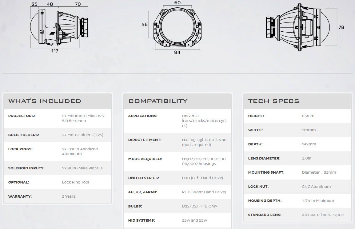

Looking to do D2S projector in my LX... and came across the M LED 2.0 (Morimoto).
It has the exact same mounting dimensions as the HID D2S projector.
While the MLed 2.0 has the same mounting pattern and fits the D2S bracket... the fan on the bottom of the projector hits the headlight housing. It required a 1x2 inches cutout and fiberglass the back for clearance. I also added two additional vents for cooling. The D2S also requires opening up the shroud with a dremel for clearance and depending on the condition and age of your housing the chrome might delaminate off the chrome shroud.
It was a total PITA and I’ll never do it again.
The output is the same as the Mini H1 8.0 or the D2S to the human eye. If you are currently driving with stock headlights retrofitting the Mini H1 8.0 will be a game changer and requires no cutting.
