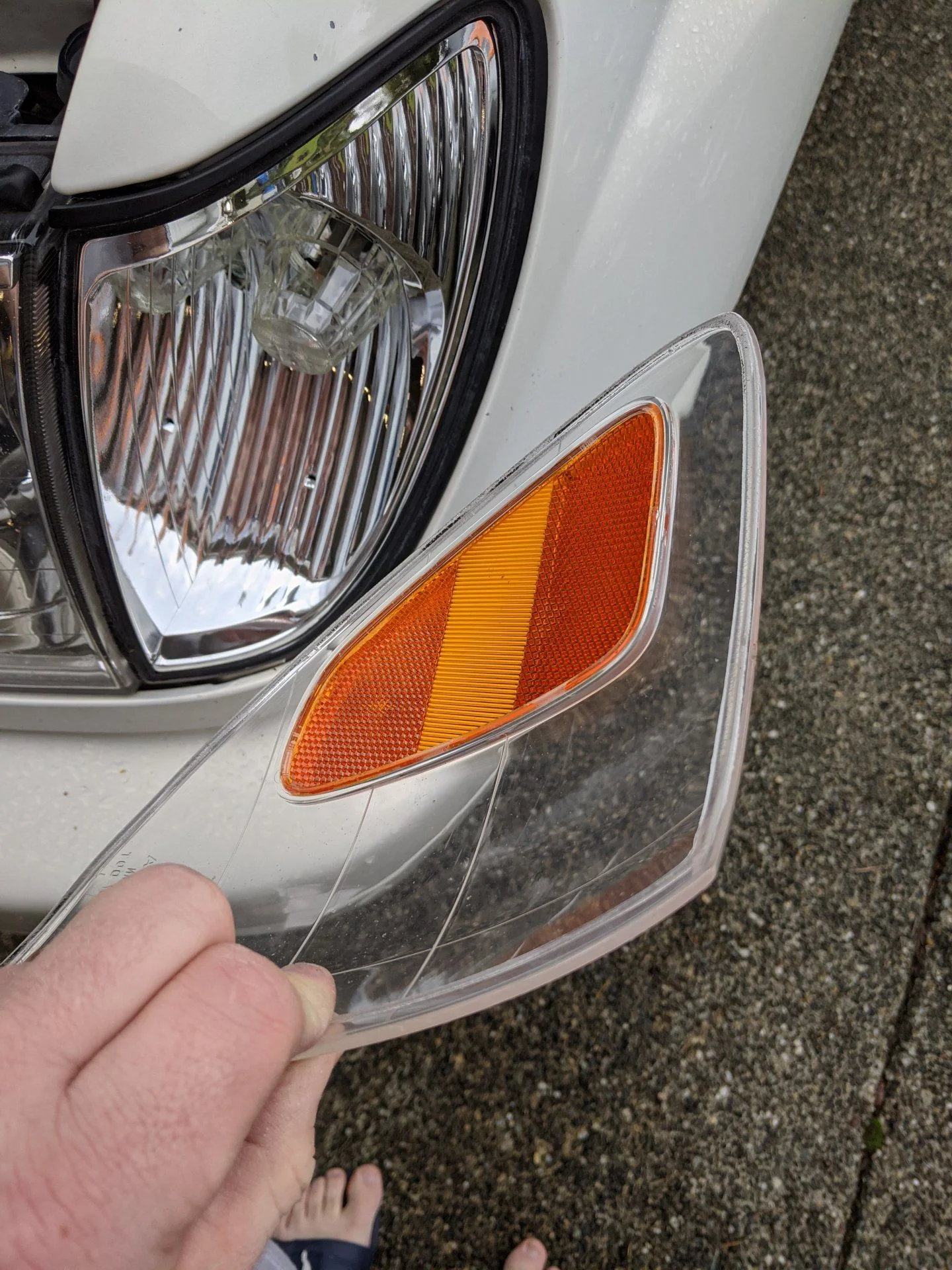

Holy hell!!!! Why is this so hard? I've managed to separate the clear cover from the housing but still the lower part of the light wont budge. I'm also freaking out because despite my gentle attempts to loosen them they i keep hearing plastic cracking and breaking.
What the hell am i doing wrong??? I have yet to be able to remove either side. Also how do I glue the lens cover back on?

There is a plastic tab near the bottom of the headlight housing that the corner light "slides" into. Take your time, with some effort you should be able to overcome the compression tab and it will come loose to slide out.

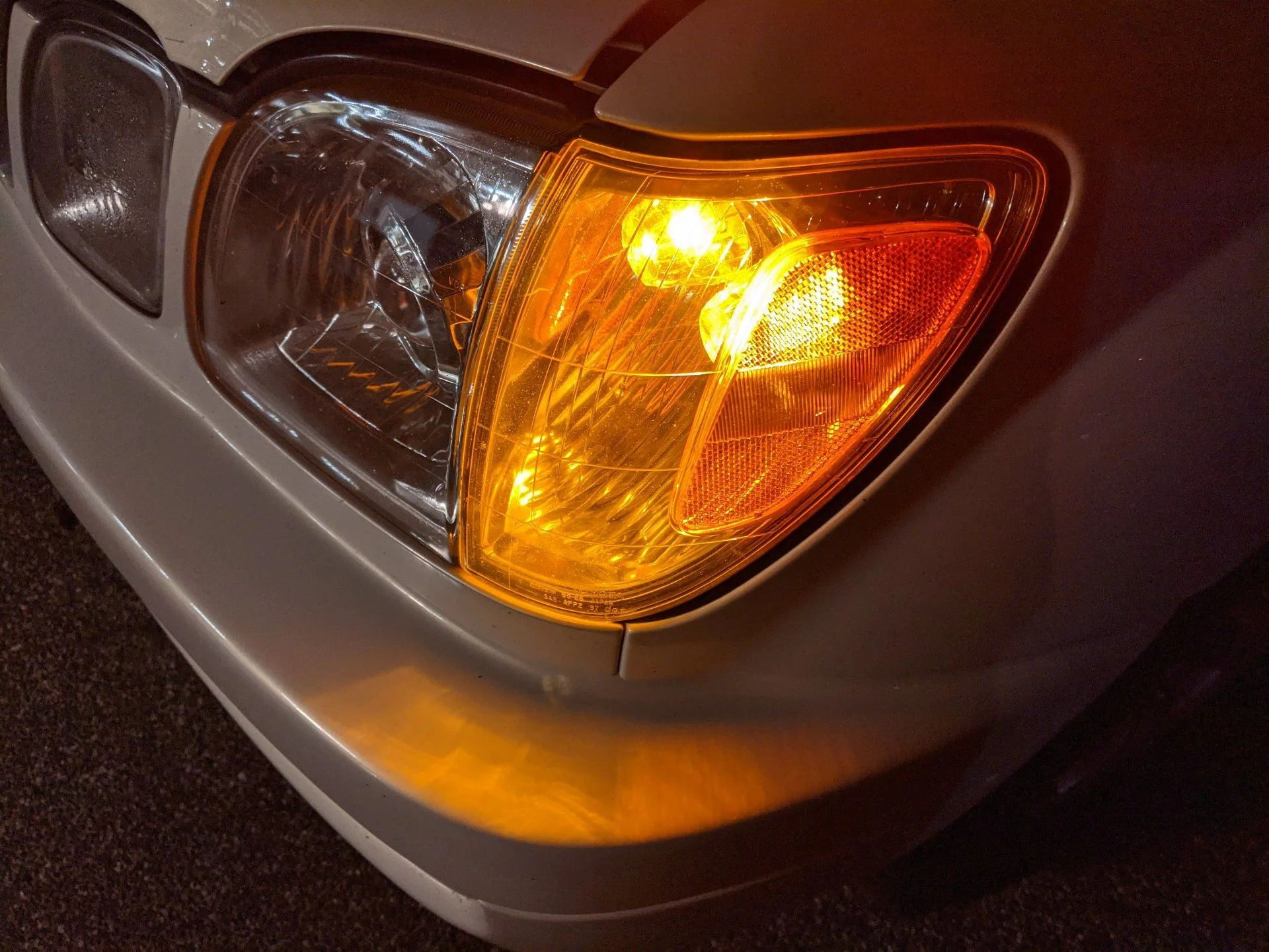

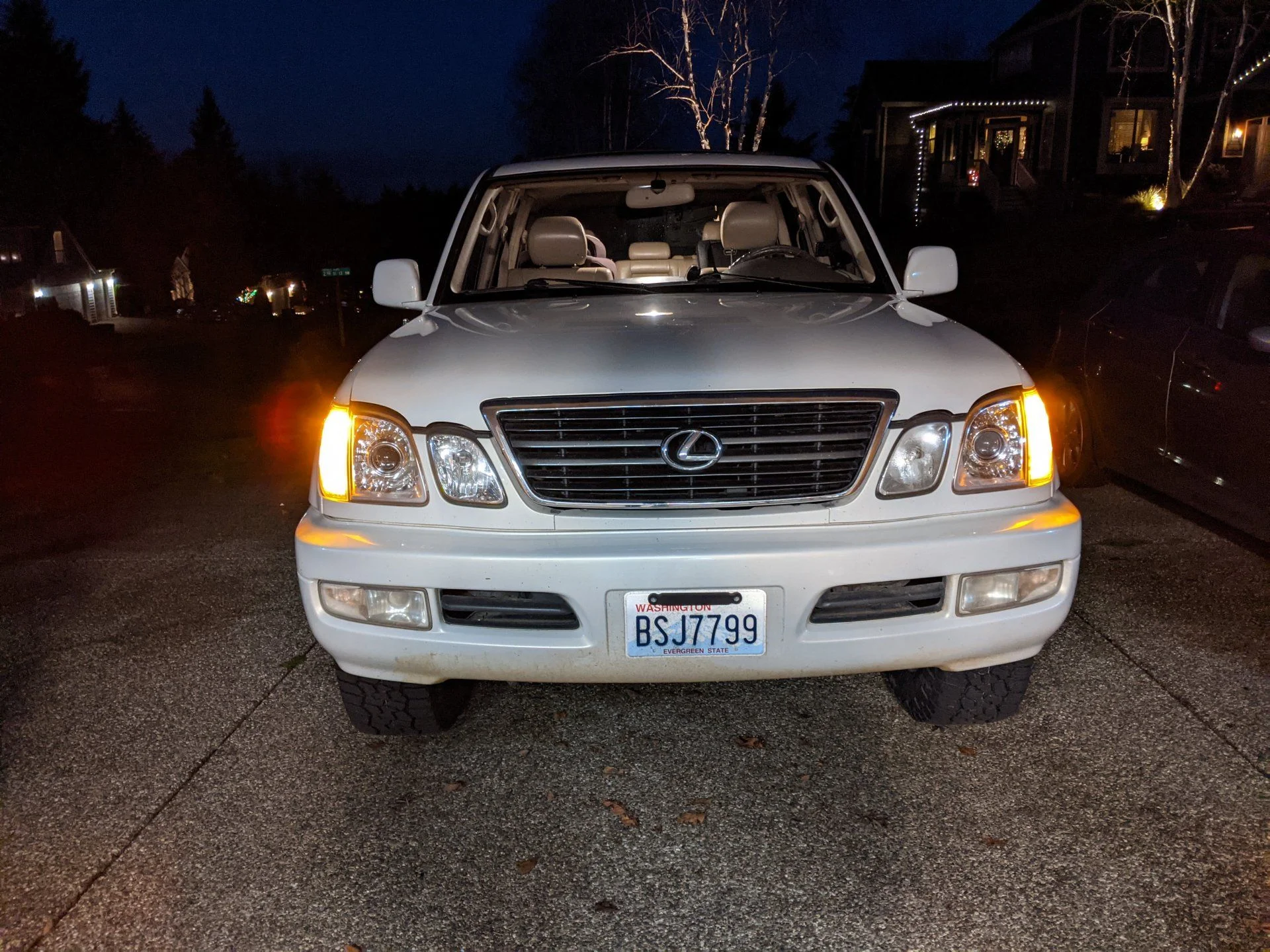

Got them reinstalled with the new amber leds. Look pretty good. I ended up using jb weld to glue the lamp cover back on amd and you can't really tell at all. Hope it holds up! 🤞
