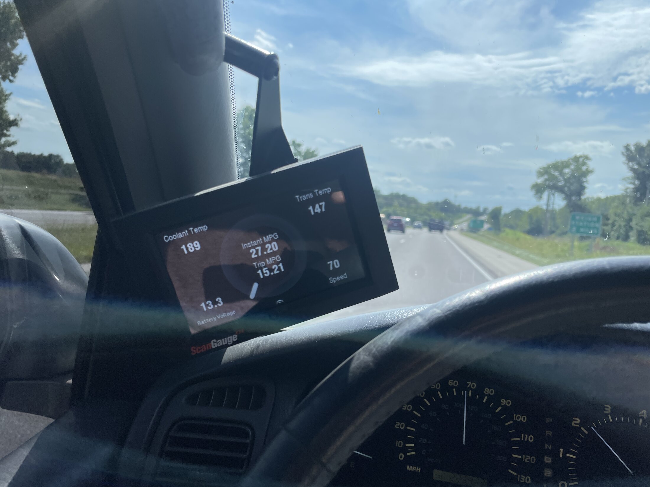

ScanGauge 3 might get you by.

In lieu of that kind of expense, though, the options mentioned here would definitely cover your main bases. Speed, temp, volts, trans temp. And of course you can cycle through any others on the fly.
